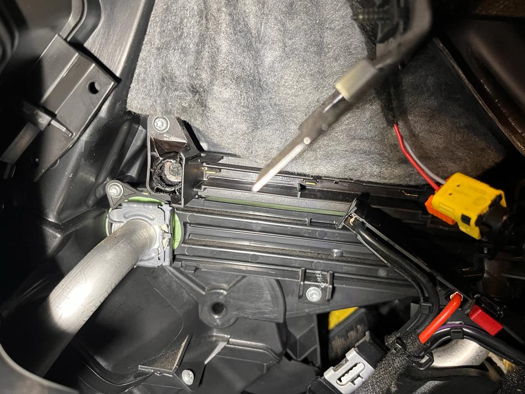

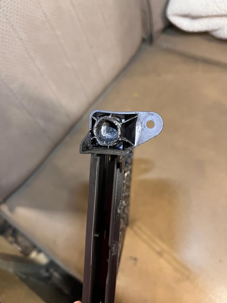

  1. Yes. Its still broken. Not only the heater but cable has to be replaced.
  2. I left it disconnected and took out the fuse.

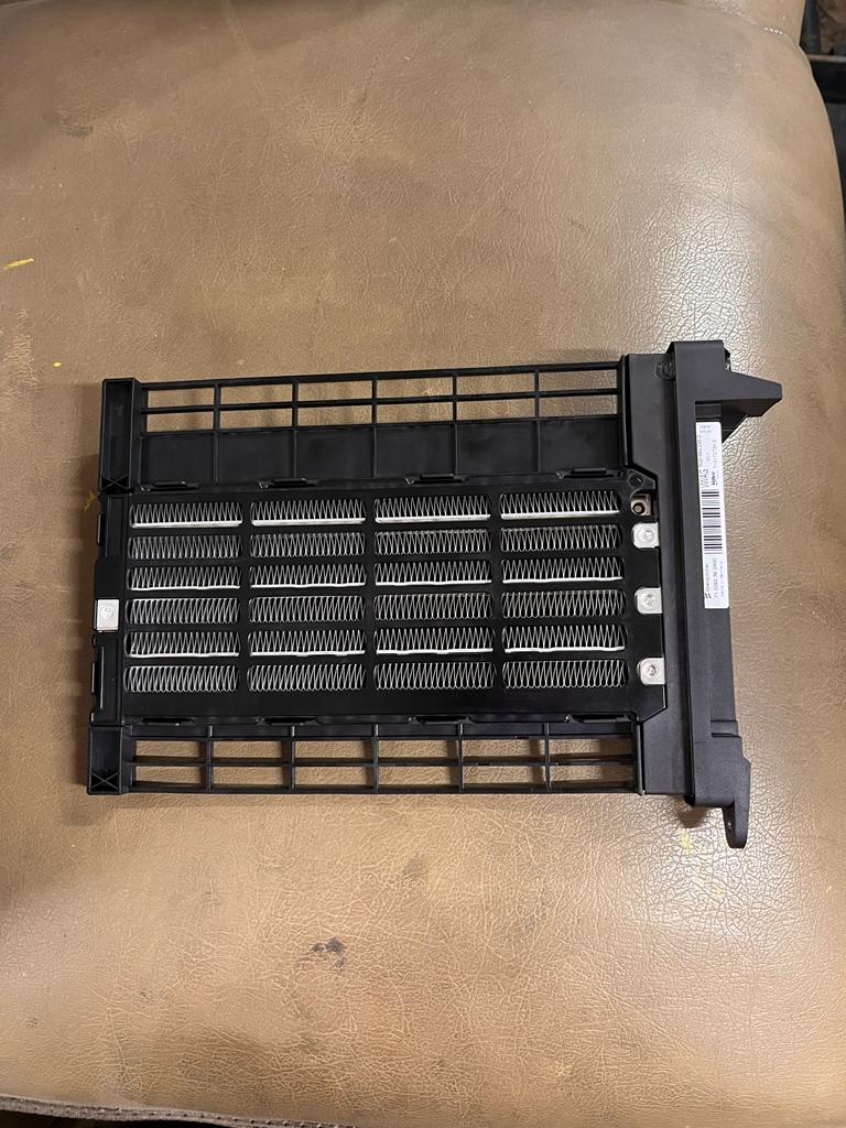

  3. Sorry i'm not a mechanic. The part looks like this

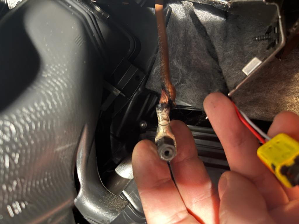

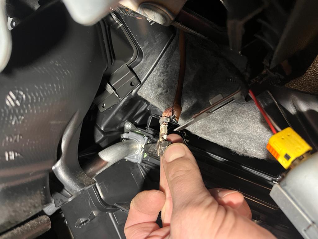

  4. He there, I started my car this morning (outside temp was around -15℃). I got strong burning smell after setting a/c to max. Later this day i have checked it with mechanic. You can see what happened from the attached pictures. This is 2018 Octavia, this shouldn't have place.
