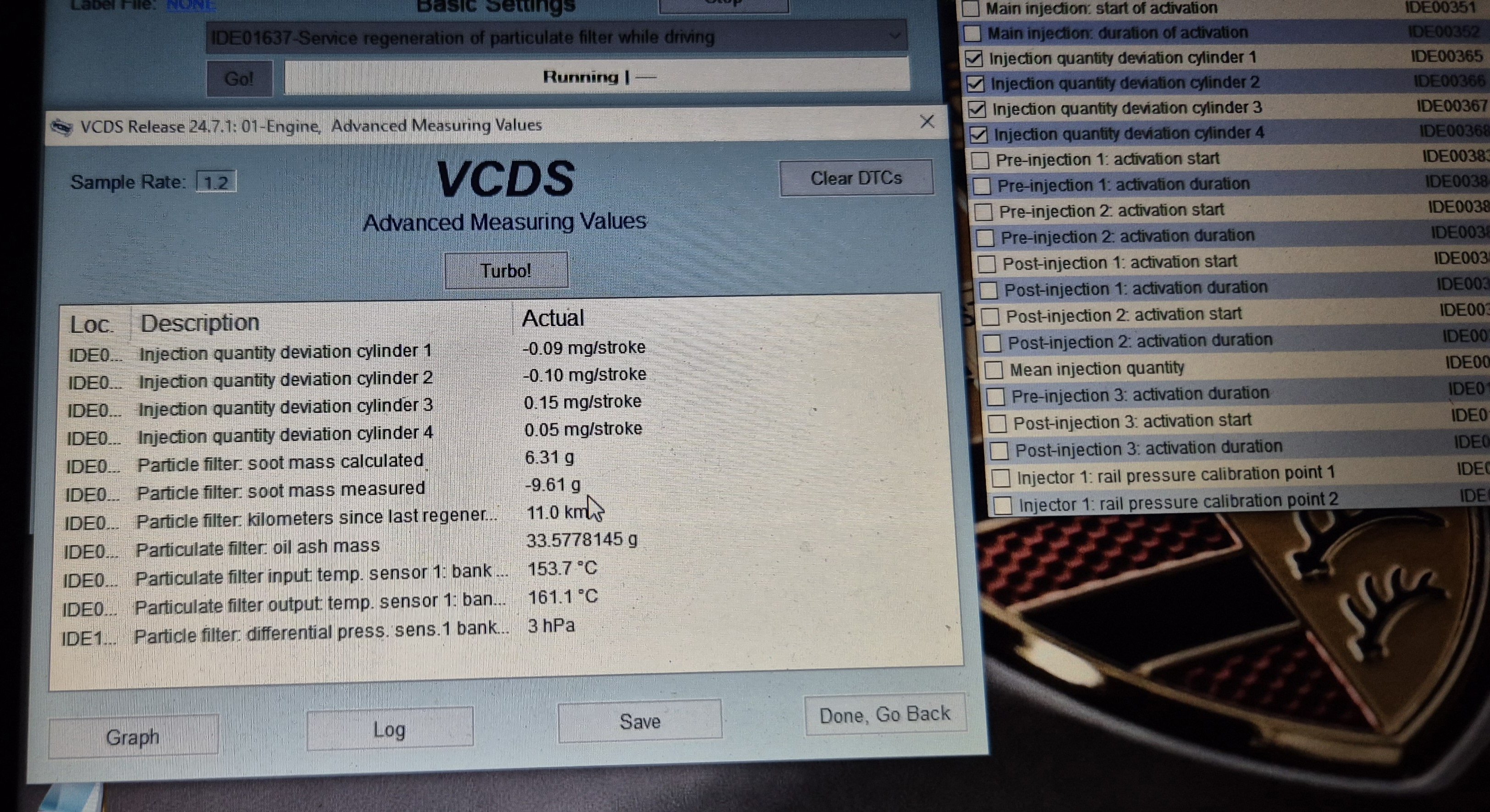

  1. I recently replaced the sensor that is responsible for regeneration, the change is that there are other parameters, the car drives differently. What I noticed is that registration occurs as soon as I start the engine, a couple of minutes and that’s it. I constantly feel vibration in the cabin, I have already cleaned the EGR, according to the program it shows that the DPF is 30% full. The injector parameters are normal.

  3. Hello. My name is Andrey, I am from the Republic of Moldova. I have been the owner of Skoda Karoq Facelift 2.0 tdi - 116 hp for 2 years now, everything was fine until one moment. At 95,000, problems appeared, vibration appeared in the cabin, the oil level in the engine increased. Registration occurs 10 times a day (as far as I understand, it tries to do this and cannot). Today, an error popped up again that it is necessary to drain the oil from the engine. The dealer does not know what the problem is, there is not a single error and according to the parameters, everything works fine. Maybe someone has encountered this problem?! Leave a review
