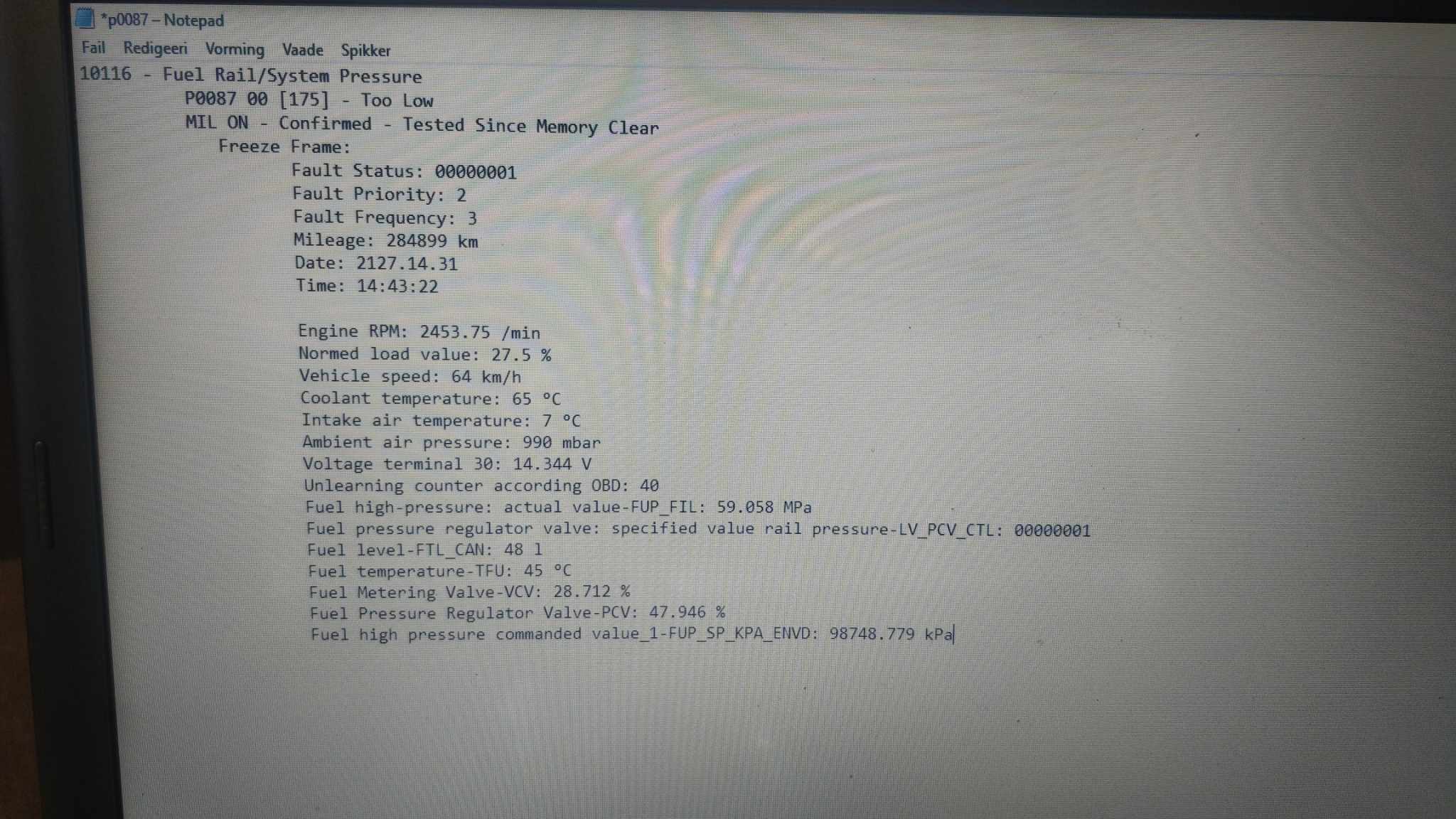

  4. Car starts well, drives well until that error just pops in. After restart its able to run well again sometimes.. checked injector overflow too
  5. Hello, I'm having issues with fuel pressure. I have replaced fuel filter, checked valve on HPFP(no metal parts), checked fuel pressure sensor and regulator.
