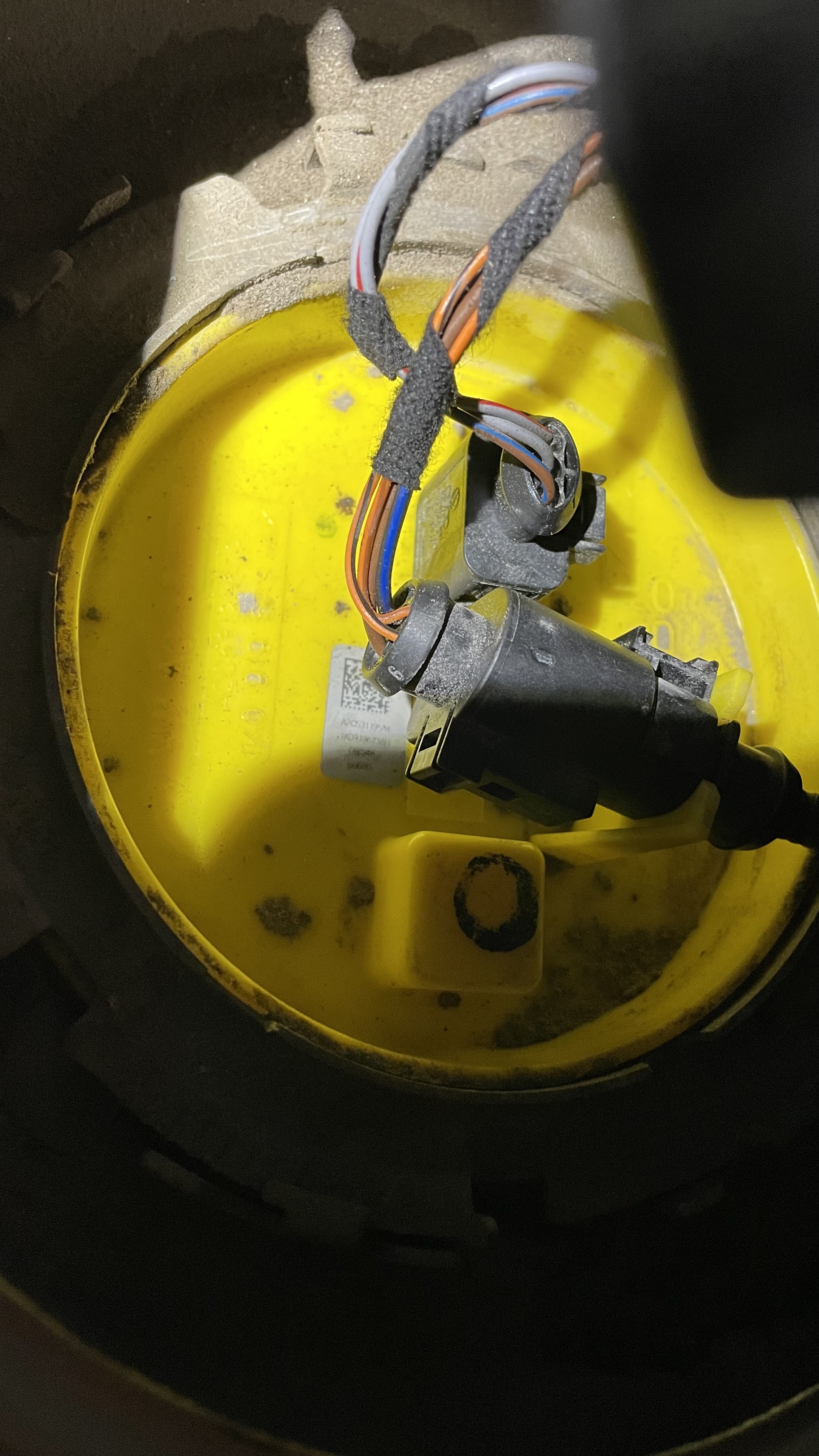

If i remember correctly, it was just there under the seat. Yellow thing in my pictures above.

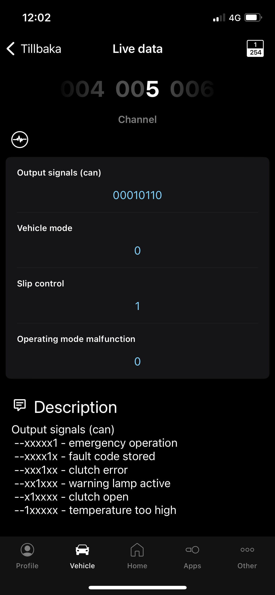

I havn’t hooked up a separate tester. But obd11 reports good voltage at terminal when the 4wd looses it’s function. I managed to get this reading from obd11 when it has happened. So it is clear to me that the Haldex controller stores a fault code for the clutch (n373), opens up the n373 valve and keeps it like this until the next drive cycle. I also tried with another good battery in the car, same problem. I’m still guessing the controller is still bad and was not really repaired. Waiting for the repair shop reply to if they have another controller.

Also my obd11 doesn’t work to reach basic settings. I just get “channel” when entering it and no matter what channel I choose it just says “function not available” I think.

J.R. Tried live data recording with obd11 as it has this feature (at least on android). But either my obd11 (original) is loosing connection as all values turns to 0 repeatedly or my Haldex controller has issues. The connection for live data recording is to flimsy either way. Why I’m thinking it’s not mechanically or electro-mechanically related is because it immediately works once the car is restarted. It always stores the 02248 fault code. It’s almost like when the controller gets that code it shuts of completely until the next drive cycle. 4wd works after restart regardless if I clear the fault code or not. Probably does this to reduce the risk of further damage to for example the pump or n373 valve. But in my case everything works once restarted. I’ve tried to get hold of a VCDS but failed. I think I will try again.

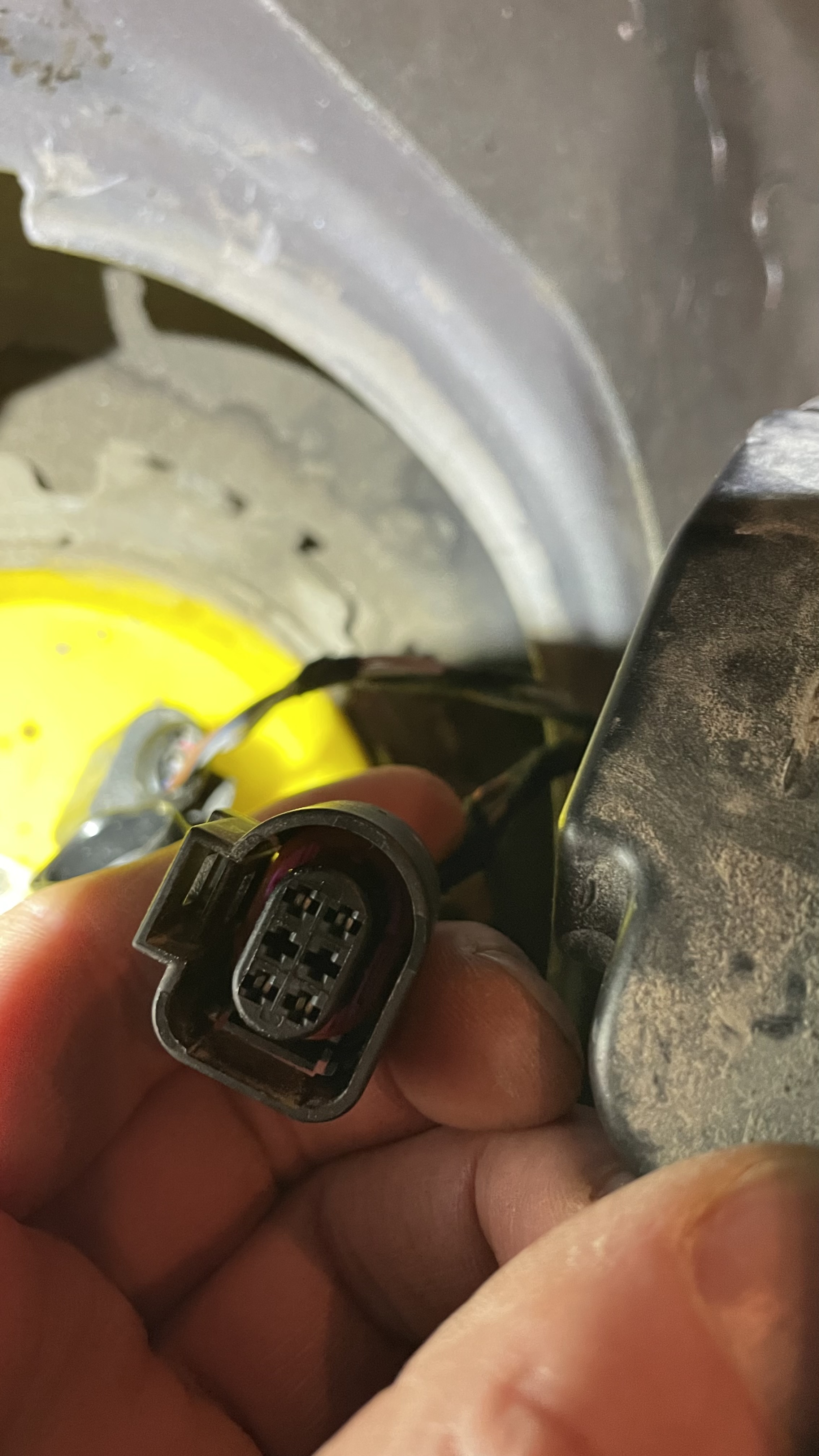

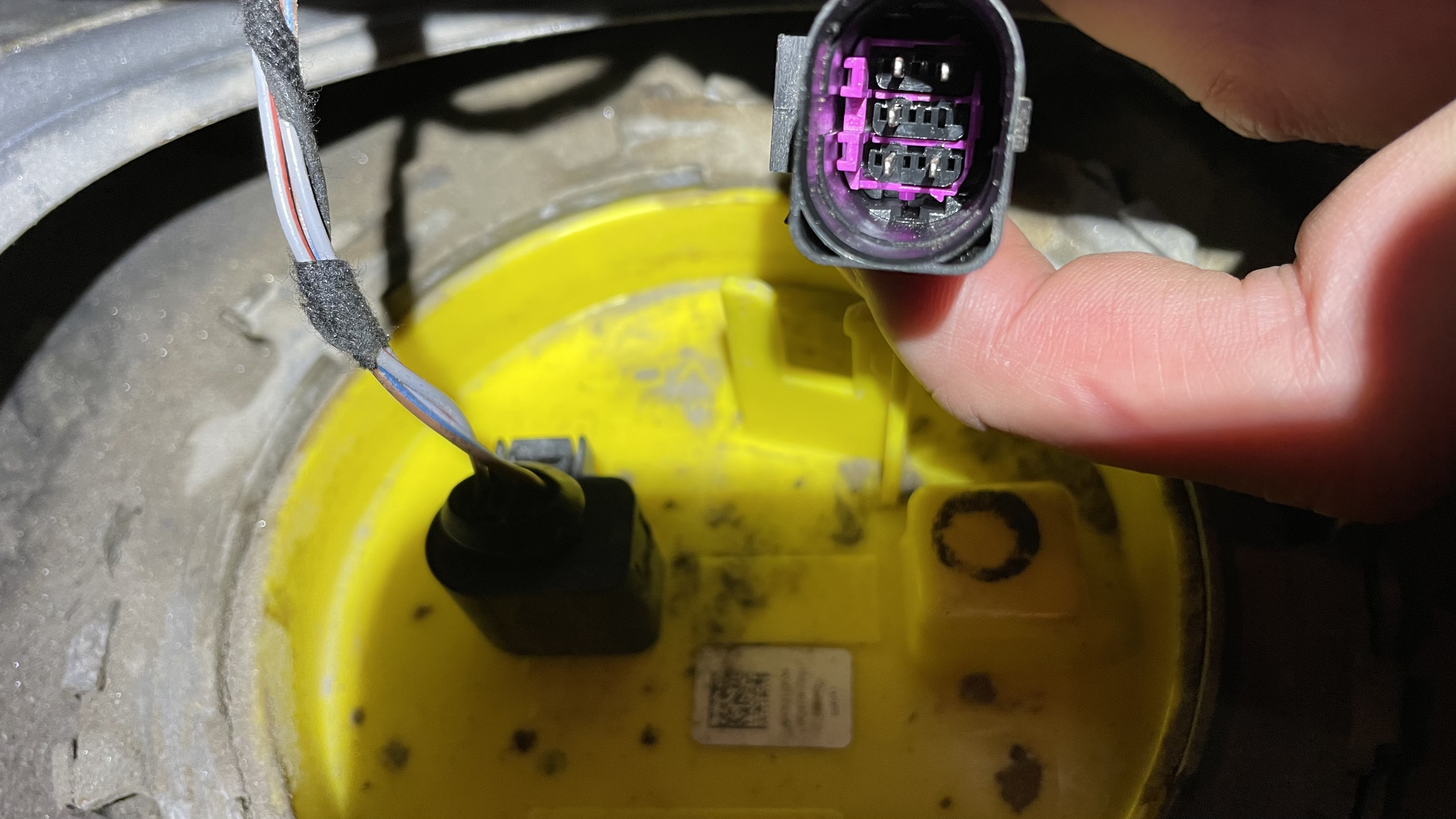

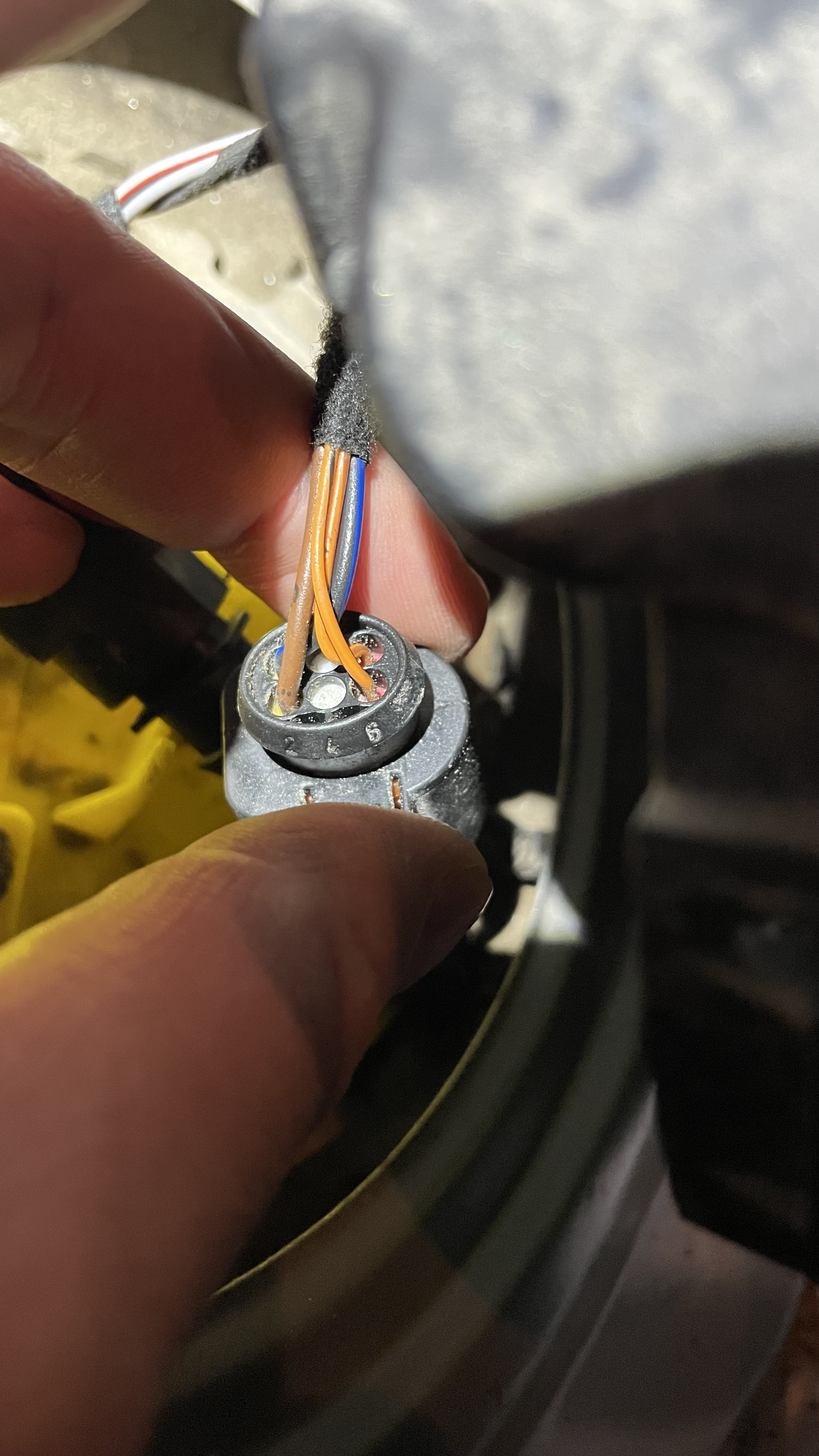

Thanks! I’ve now measured the wire loom under the rear left back seat. Perfect ground and same voltage as the battery (car side). No resistance in the wires to the Haldex unit. All measured separately with about 0.1- 0.2 Ohm. No visible wear or corrosion. No corrosion on the front left ground point. Seems like my Haldex only runs two control/data wires. At least the wire loom from the car side only has two orange data wires and 12v + ground. So now I’m in the blind again. Perhaps I’ll try a new battery before ordering a new or used Haldex controller. Just strange that the controller tests 100% healthy on the bench at the repair shop. But then again, it’s not in the car.. and 4wd also works 100% for a short period when test driven.
