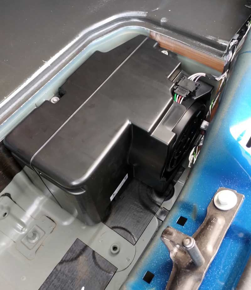

  1. Small update, having nothing better to do I cut the guides off the sub connetor and reversed the connection. Very little difference at all. I've came to the fairly obvious conclusion it's just cheap and nasty pretend subwoofer!. I have the car for another 30 months so I may take a trip to Autosounds and see what they suggest. I don't want masses of car rattling bass (it rattles on its own anyway!) just something with a decent clean thump! A seperate underseat sub may do the job.

  4. Had a bit of a play with this this morning. With the polystyrenr box removed there's a small increase in the output from the sub. Still barely noticeable with the front speakers in use. If you set the sound focus to the rear it makes a more noticeable difference as the rear speakers are quite poor and very lacking in bass. Centering the focus brings the front speakers back in and these overpower the sub. The sound isn't terrible but for a £2035 upgrade pack I really was expecting something much better.

  7. Some better photos of the actual unit,
  8. Thanks for the reply It's sat in a rectangular well in the under the boot floor, the speaker is in a platic box contained in a polystyrene outer shell.
  9. New member Picked up a new 85x a couple of weeks ago with the Advanced pack added. In comparison to my previous Seat Ateca's standard sound system the Canton is not much of an improvement. Even setting the subwoofer to +9 makes almost no difference to it being at -9 and there's no great increase in bass. Compared to a previous Honda CRV with a sub it's completely lacking in any bottom end. Took it in to dealer who compared it to a 69 Superb and admitted the Superb was certainly louder but that it's just the way they are now!. I've asked on a couple of other Enyaq forums and most people say anything over +3 makes the boot and rear view mirror vibrate (as the Honda used to do). I've had the sub out of the boot and it's a 6" (15cm) speaker in a plastic box!. Is there anyone near the Durham/Newcastle/Sunderland area who has an Enyaq with the Canton system I could compare it to?
