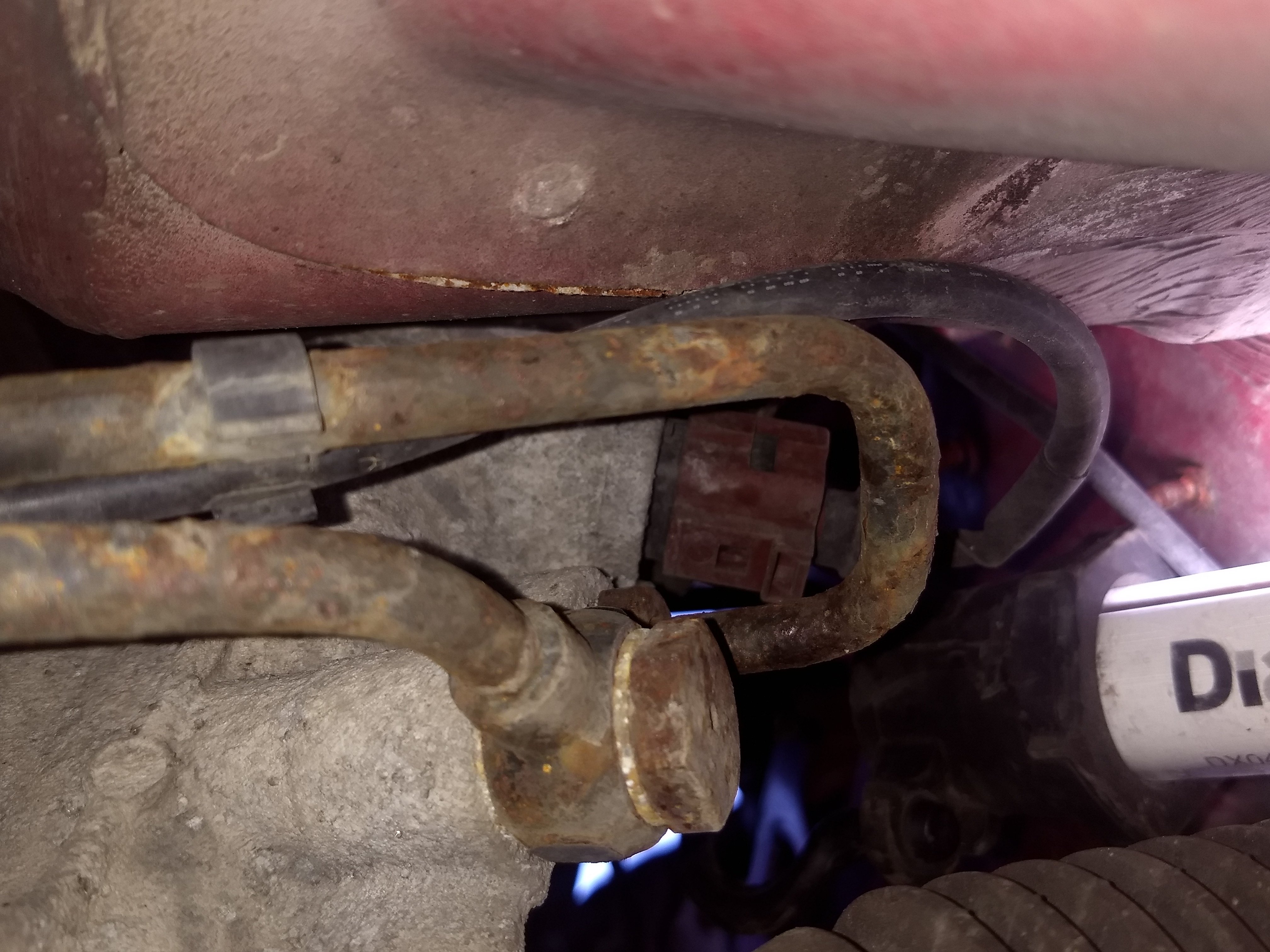

  4. Hi VIN looks to be TMBAA251583020057. I have now had a better look at the pipes and the one that just clips on the pump (the return?) is the most corroded. It looks as if both pipes end up in the steering box (pic attached) is that correct? I will add some fluid and start it up to see if I can find the actual leak before I look at buying any pipes. Stuart
