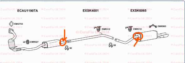

  5. Might be a bit of a long shot but looking for some tips and advice source an exhaust or reliable welders in the south west closest to Bristol as possible. 2011 VRS with 2 exhaust leaks. Attached diagram with leak locations clearly not the first person with this issue as they have been bandaged in the past but are leaking again 1 right at the start of the back box - most pressing problem to fix 1 on the cat side of the exhaust that connects to the mid section. - hopefully will survive till I can find a welder or someone breaking a mk2 VRS hatch The pressing matter is the leak at the back box as this is causing an MOT failure. My local garage cannot source this section. My next solution is going down the welding route. However I can image this would be fine to get a new back section made up but the repair to the front section of the exhaust may be more difficult. Excuse the sporadic info dump but I'm looking for some help and advice on what people suggest is the best action forward and ideally not having to fork out for a £1k system. It's literally a run around for the Mrs and the occasional b road basher when I'm bored of my barge
