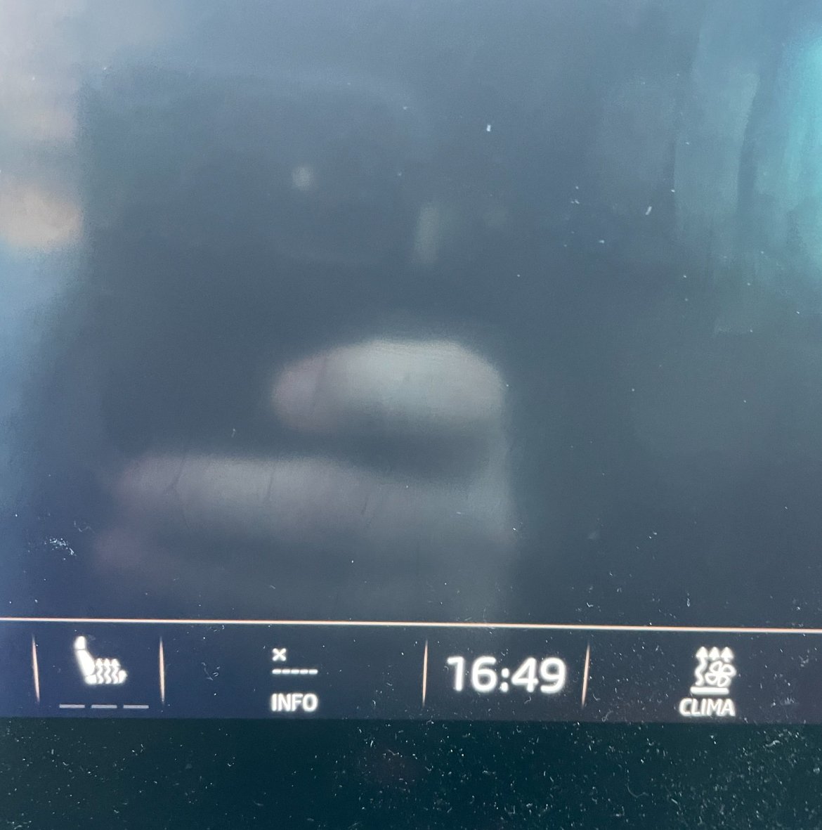

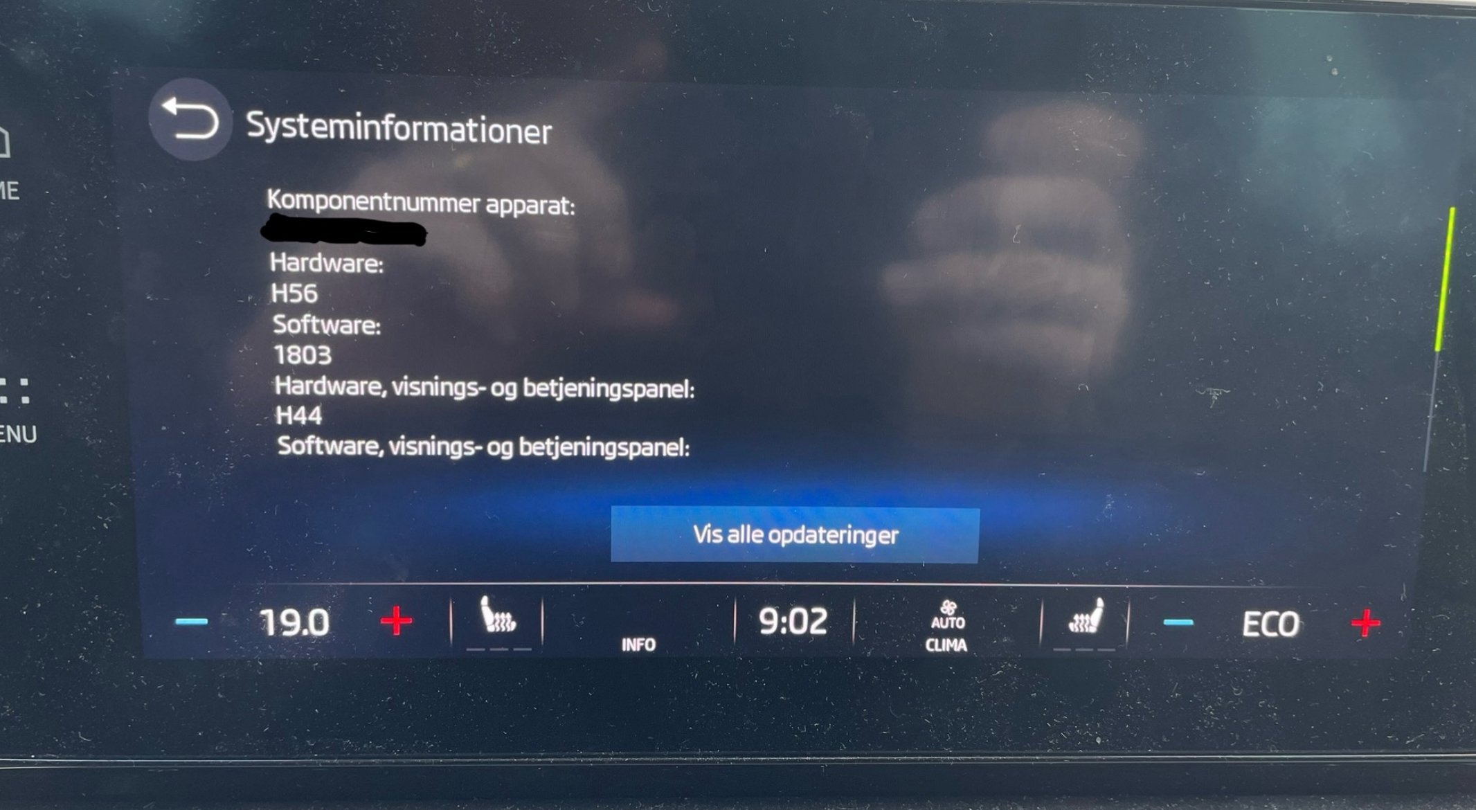

  4. Tried the reboot, however nothing changed. I do still not see the globe or climate icons. However, when starting the car I see the below before both icons just disappear again. Could a total reset fix anything, or will it just delete all prior updates? Also, it seems like I cannot access the privacy setting within the user settings, assume everything is connected to the software “issue”.
  5. Thanks Steve. Forgot to enclose the picture in my original post, as I saw people refer to 1941, but mine is 1803. Was the upgrade to 1941 OTA or by the dealer?
