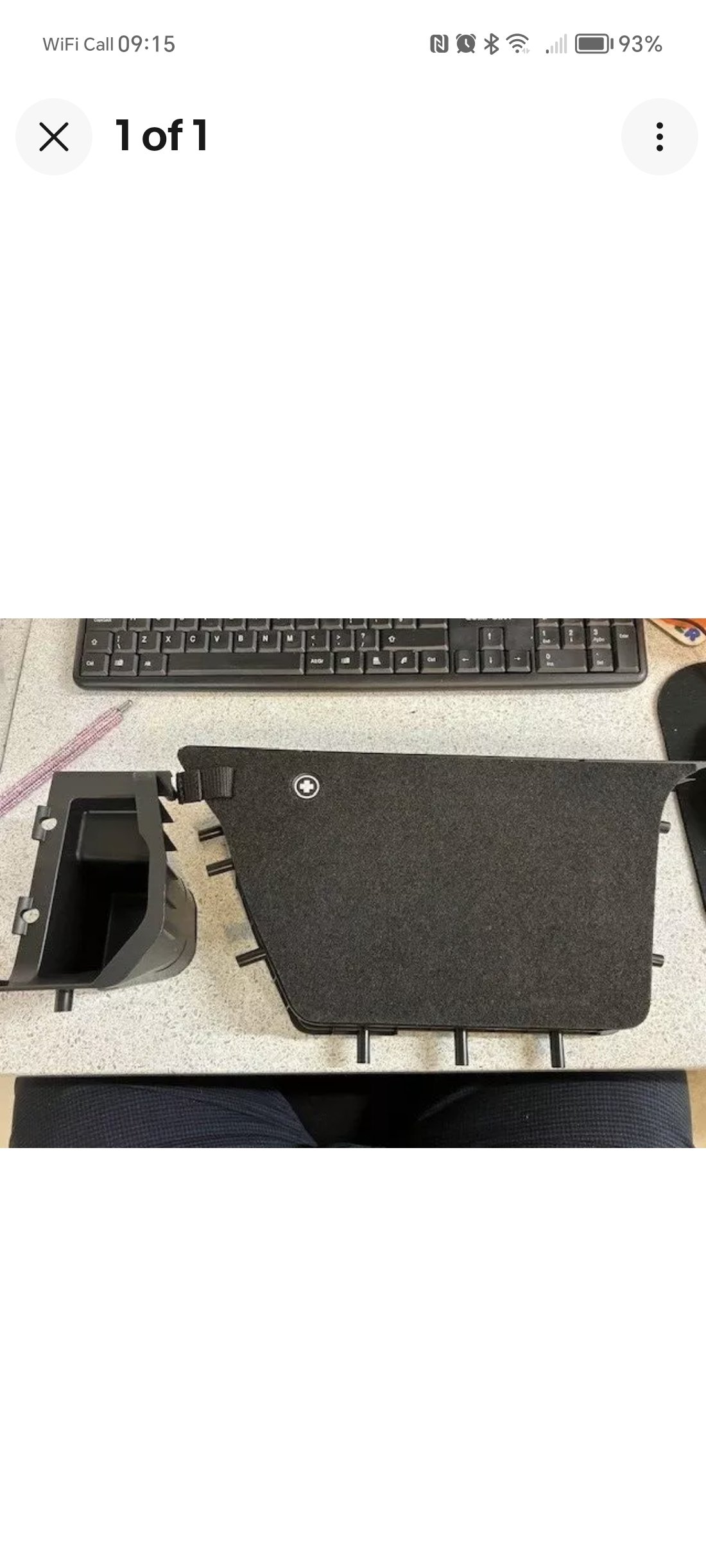

  7. Hello, I have noticed a rumbling coming from the rest of my kodiaq when accelerating especially when the revs get to about 2000rpm through to just before 3000rpm this is especially loud when on the motorway and you put your foot down to overtake and the box downshifts. After 3000rpm it seems to quieten down and if it gearshifts in that rev range the sound will also quieten down. Car drives lovely other than that and has no clunks or rattles at all. It's had all fluids changed in the last 2 years at Skoda. I had my local mechanic taken a look at the prop and bushings and he said they looked fine.
