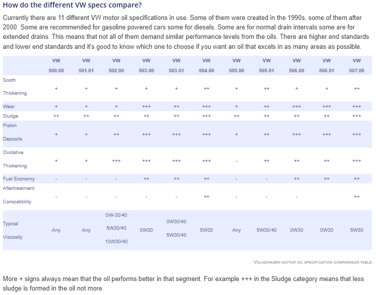

  11. @Rooted I've seen a few sources stating VW 504 is a newer and more demanding spec to meet than VW 502, such as VW 507.00, VW 504.00, etc: Volkswagen Motor Oil Specifications Explained - oilspecifications.org which includes the following: These sources give me the impression 504 is preferred in all instances, but that you can 'get away with' using 502 spec as long as you don't exceed fixed service intervals. Your comment about bore wash is interesting though, as well as the description (in the links you posted) of 502 spec oil being preferred in 'arduous/strenuous conditions'... such as in a highly-strung twincharged engine. It does make me wonder if 502 spec oil is seen as more 'robust' and able to resist heat degradation? As I said, just genuinely curious as to the science behind the debate. Luckily, consumption does not seem to be an issue for me with a 504 spec 5w30, but if a 502 spec 5w40 will serve my CAVE engine better in the long run then it's worth considering a switch. Is it the cylinder 4 spark plug that tends to get coked/fouled, by the way? Thanks for the replies everyone, much appreciated.
