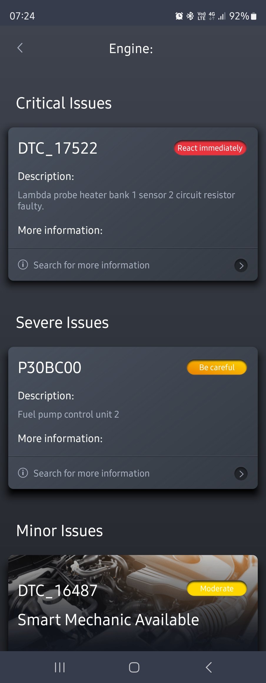

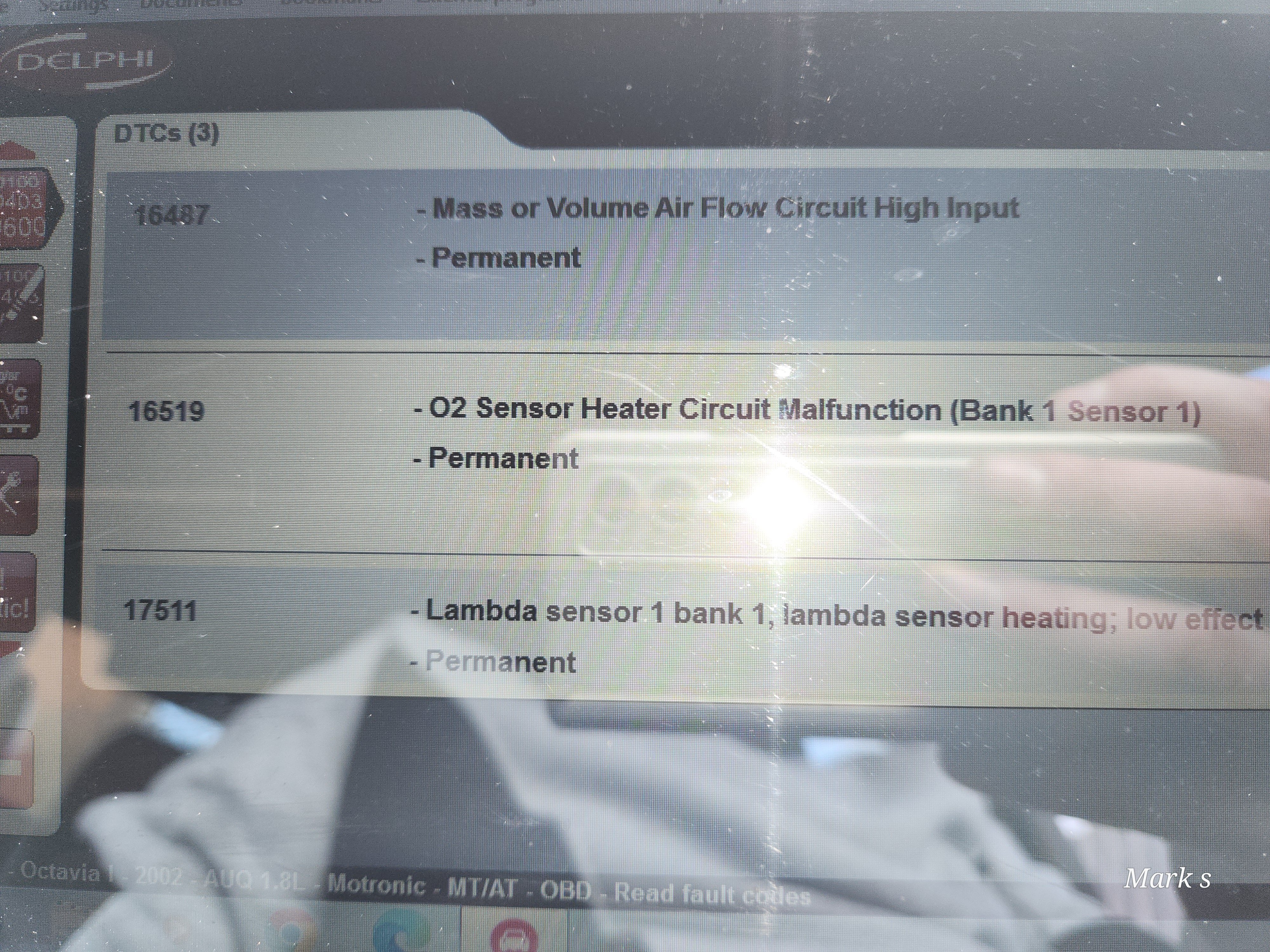

  5. Just to update. The car seems to have improved after changing maf sensor and both lambda sensors. But The car really struggles when driving when engine is cold. I literally move the car when I finish work so I can see it when it's warning up. Once warmed up it drives OK but will drop in power. I take my foot off the accelerator pedal and back on and seems fine again but will do the same shortly after. The pic shows fuel pump control unit. Any ideas? Thanks
