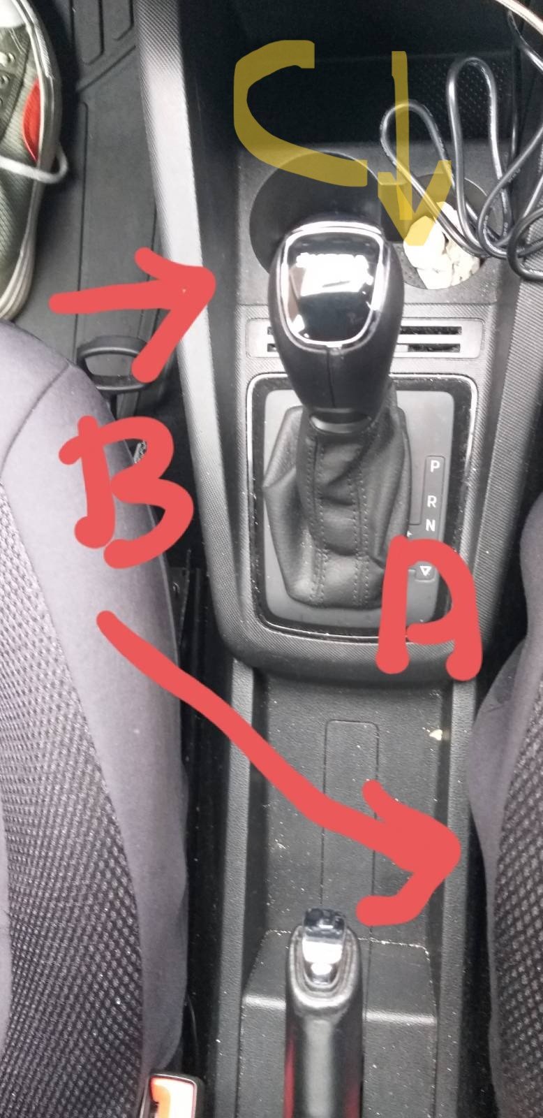

  9. I am lucky enough that i got the error in the dashboard occasionally " Error: workshop! Only leave vehicle in Position P". Thanks for the previous posts that the add-on micro switch, if the gear housing is WHITE then I will need 3Q0713128, if its a BLACK housing then i will need 5Q0713128A But now i am thinking about how to remove the center console and please share your experience how to take them out, the cover A is the most straight forward. I needed to take out C also but I think part B in both left and right first which is the most difficult one. Many thanks in advance.
