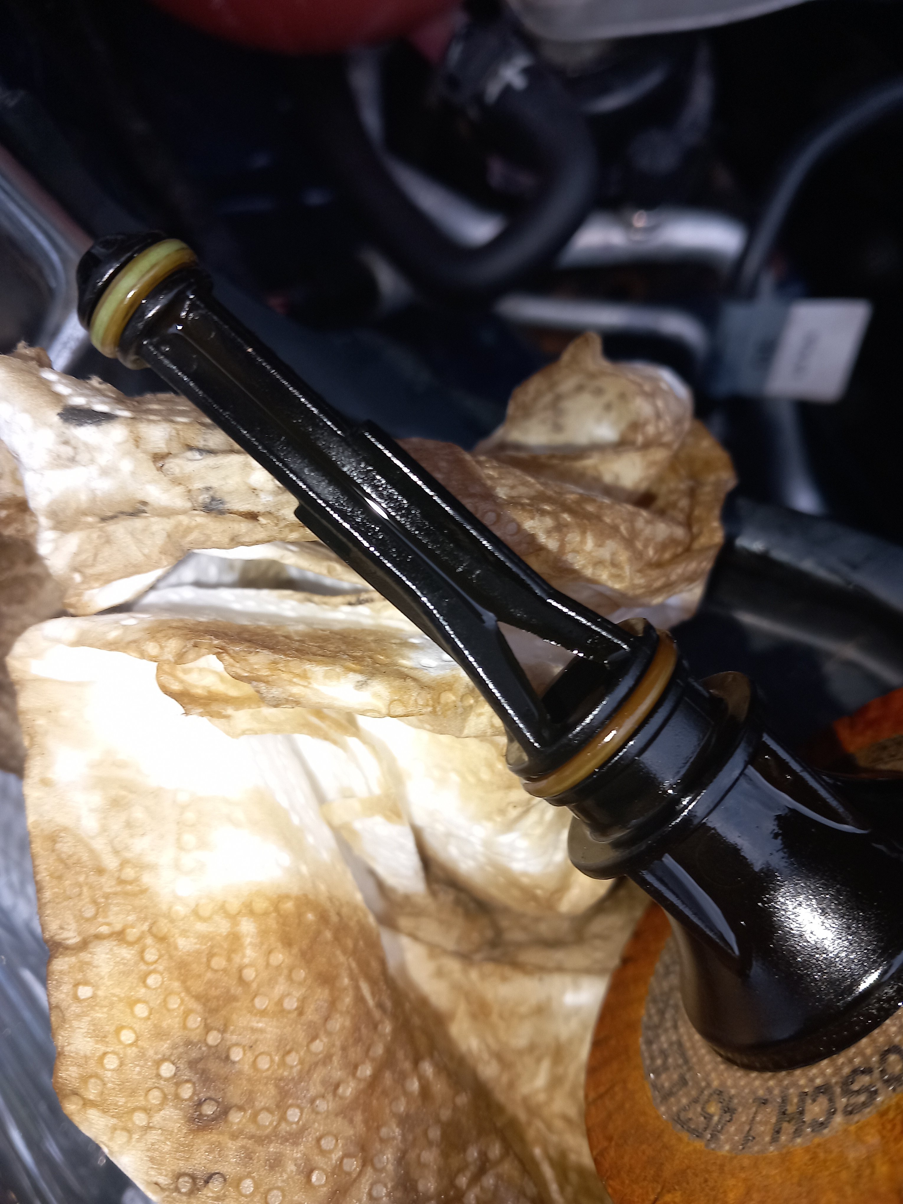

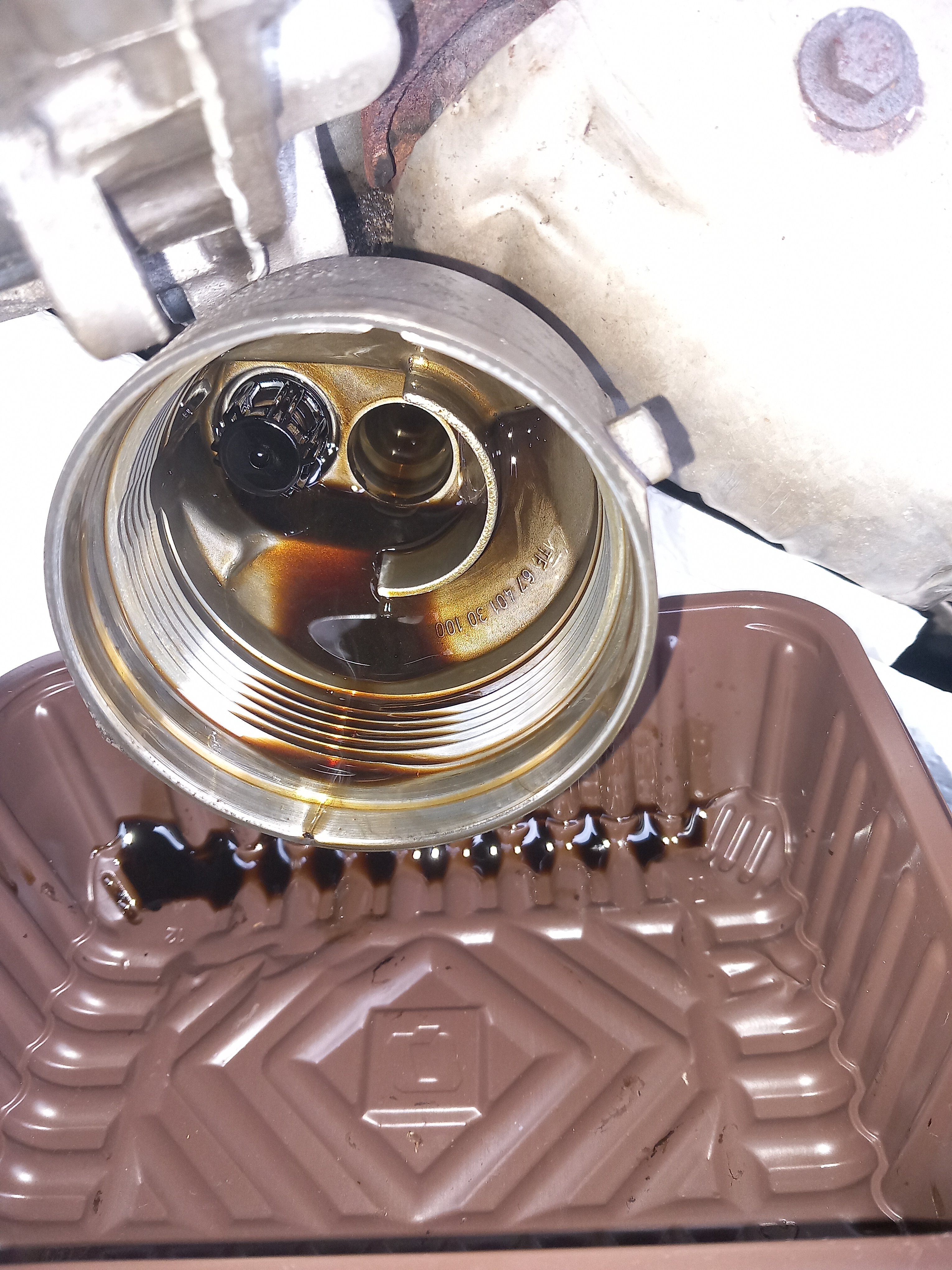

Pulled filter housing, o-rings were in place and looked to be OK. They are both stood slightly proud of the groove on the stick, and do not feel hard. I reckon these are ok(?). Out of interest, does anyone know what the black rubber/plastic jobbie is in the base of the filter housing? Having done all of this, and out of curiosity, I then rechecked my oil pressure switch with the engine cold, and it was behaving itself, suggesting that I have more acceptable pressure on a cold engine. Didnt connect the gauge to collect numbers - maybe I should? I guess this explains why my camchain and tappets are quiet on start up, and possibly why I haven't scrapped the engine yet? Thinking this through, maybe the question now becomes why does my oil pressure drop off sometimes, but only when my engine is hot - anything between 5 to 15 miles driving? To reiterate, it has done this pre and post service, has the correct grade of oil and a decent filter. The failure pre service was around 10 months after the last oil and filter change, not immediate. The oil pressure switch has been changed for a new (branded) part, and its behaviour corresponds with the readings on the oil pressure gauge. Filter housing seals look good, and there are no obvious leaks anywhere. Anticipating possibilities such as crank wear, the bottom end sounds quiet - no rumbles or knocks. Vehicle has been regularly serviced. Pressure relief valve, possibly? I assume its integral with the oil pump? If so, what's the labour time look like to swap it out? TIA Steve- Another flashing oil light, but perhaps a bit different to the others?

Xman Thanks, I'll take a look at these. Can I get away with just unscrewing the cap, giving it a minute to drain down, and pulling it out, or do I need to do a full oil drain first?- Another flashing oil light, but perhaps a bit different to the others?
