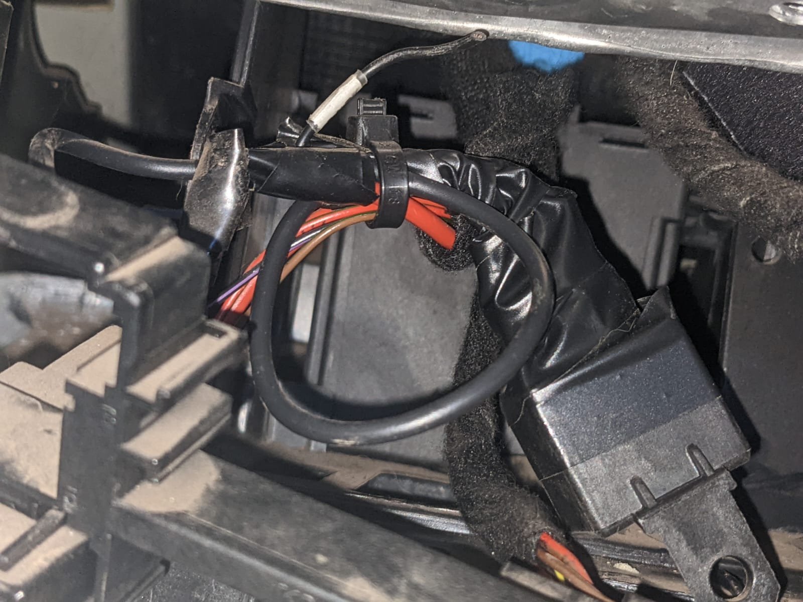

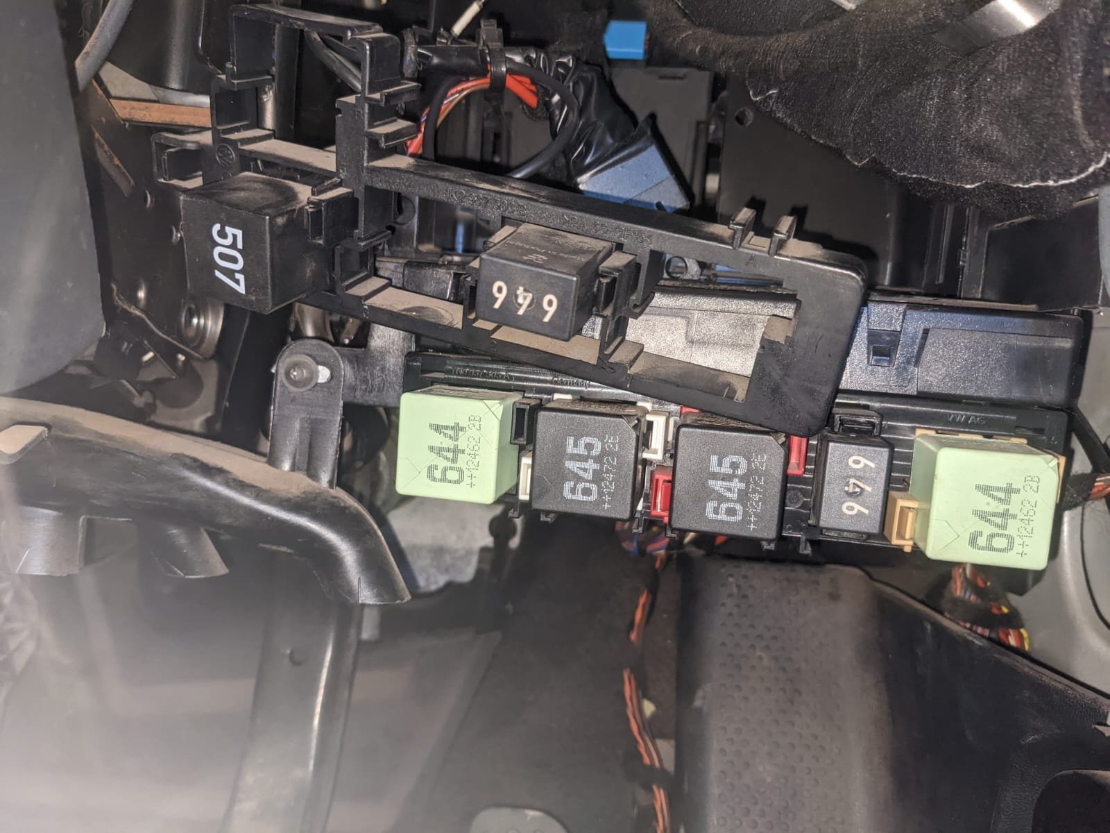

Hi Alasdair, yes it looks like it from the photo but I'm guessing would have been cut a while ago as we haven't had any work done on this area of the car previously. I found the schematic (attached) for this upper relay area above the central control unit which is the LHD version (ours is RHD) so image needs to be flipped. You can see from the photo in the 1st post we appear to only have 3 relays in that module (507, 646 and the unidentified taped up one). According to the schematic the taped up one must be D5.2 relay for heating element, 507 must be starter relay and 646 the horn. None of the other relays in the schematic apply as they're for things this car doesn't have. So even if the taped up D5.2 relay were faulty/wet or badly wired I'm assuming it's unlikely it would be the cause of the 01314 code... so time to look elsewhere I'm guessing unless you think the cut wire could be related. D1 – Relay for independent heater -J485- (for vehicles with an independent auxiliary heater) / relay for low heat output -J359- (for vehicles with auxiliary resistive heater (PTC)) D2.1 Horn relay -J4- D2.2 – Fuel pump relay (for engine letters BUD, CGGA, BSE, BSF, CMXA, CHGA) / – Additional fuel pump relay -J832- (for engine letters CLCA, CLCB, CFHF, CFHC, CEGA) D3 – Relay for high heat output -J360- (on vehicles with additional resistance heater (PTC)) D3.1 – Relay for fresh air blower -J13- (on vehicles with independent auxiliary heater) D3.2 – Additional heater fuel pump relay -J749- (on vehicles with an independent additional heater) D4 – Starter relay 2 -J907- D5.1 – headlight washer relay -J39 D5.2 – Relay for heating element -J925- (at engine lettering CAYC)

Oh and forgot to mention, in the 3rd photo of the taped up relay there's what appears to be a loose black wire top middle of the image with some white tape wrapped around it. Possibly has always been like that or at least since the diy wiring job but I don't know for sure and until I know what that relay is for it's hard to say whether it would be the cause of the 01314 code.

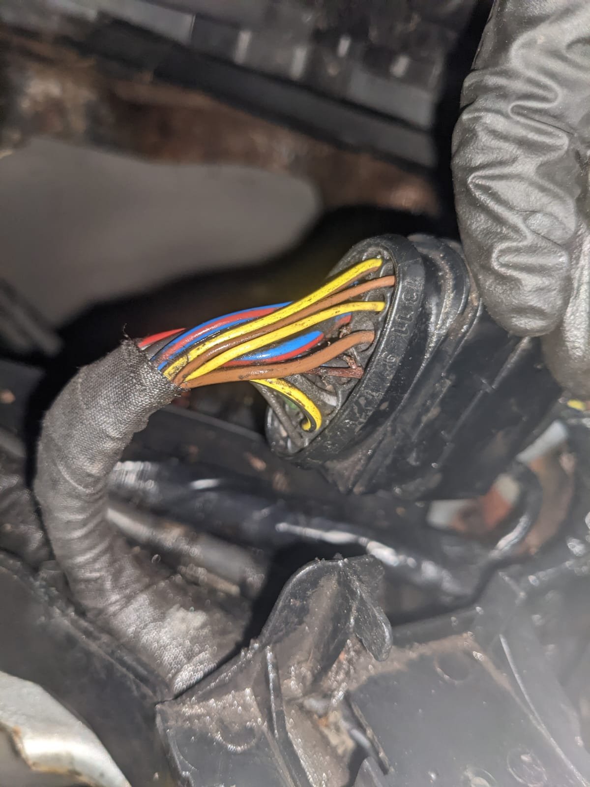

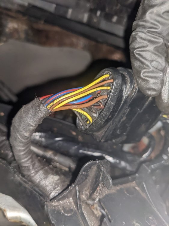

Good evening, I'm having a major headache troubleshooting a 01314 fault code no communication with ECU. Have tested all fuses (not contacts), tested the main 100 relay in the engine bay as well as some of the relays under the steering wheel. The car was driving fine the night before it happened then went to start the next morning and dash lights come on with a few errors not seen previously, most of them related to 01314 code. I've had the battery tray out to inspect the wiring and there's one suspect plug connector junction which was very damp although had it open today and seemed dry inside the connector. The exposed coloured wires might need a closer look, I've attached a photo, possibly a coroded wire there but it was hard to tell with all the oil residue and muck so will give it a good clean up tomorrow. The other suspect thing is the drivers footwell is sodden with water coming down the inner pillar onto the floor. I'd sealed this before but the seal looks like it's disintegrated. Possibly related to that one of the relays in the area where the water ingress may have impacted is all taped up and looks like someone's previously done a diy wiring job on it all wrapped in electrical tape (photo attached) and not fixed to the relay panel where it should be, so I can't tell exactly what the relay controls and whether that might be a culprit for the 01314 code. The car is a 2013 1.6 greenline mk2 octavia CAYC I've scoured the forums for days now and had a lot of help along the way thanks to all the previous troubleshooting but now running out of ideas. Any help much appreciated!

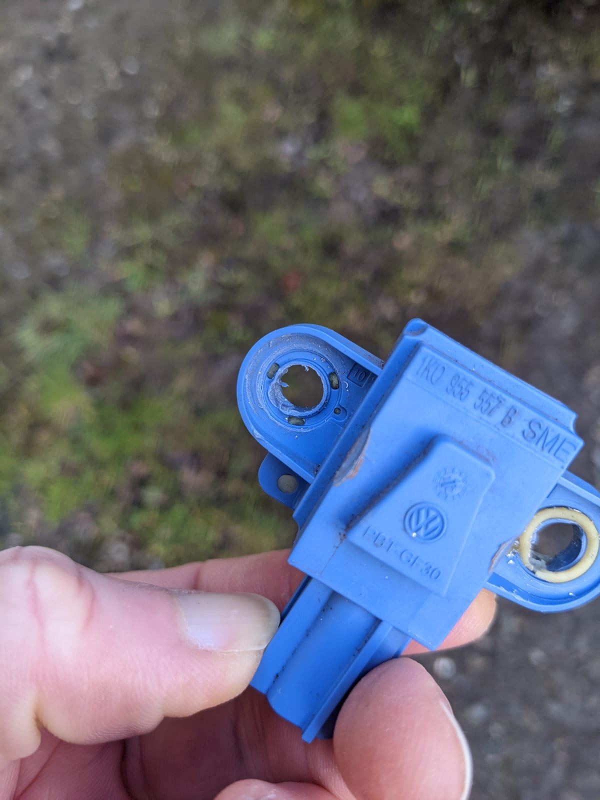

Thanks for the reply, yes that would make more sense. I searched the part number and one of the listings came up with this description: SKODA PRESSURE THRUST SENSOR FOR AIR BAG 1K0955557B which is what led me down that way of thinking. I've found an O ring which fits where the missing gasket is, hopefully that will suffice. I was just concerned that the gaskets were somehow integral to function and would rather avoid any airbag misfires etc!... 😳

I've been drilling out the rivets in the door panel which houses the window regulator and as they sent a completely new panel (with regulator installed) I've also had to drill the rivets out for both the speaker and airbag pressure sensor. The problem is the drill damaged the little gaskets on the airbag sensor housing which I'm assuming help create a sealed space so that the pressure reading can be accurate. The question is to anyone who might know, can this sensor be reinstalled with one damaged gasket or would it be advisable to get a replacement. Desperate to get it all put back while the weathers good, any advice much appreciated! See attached photo of damaged gasket.
