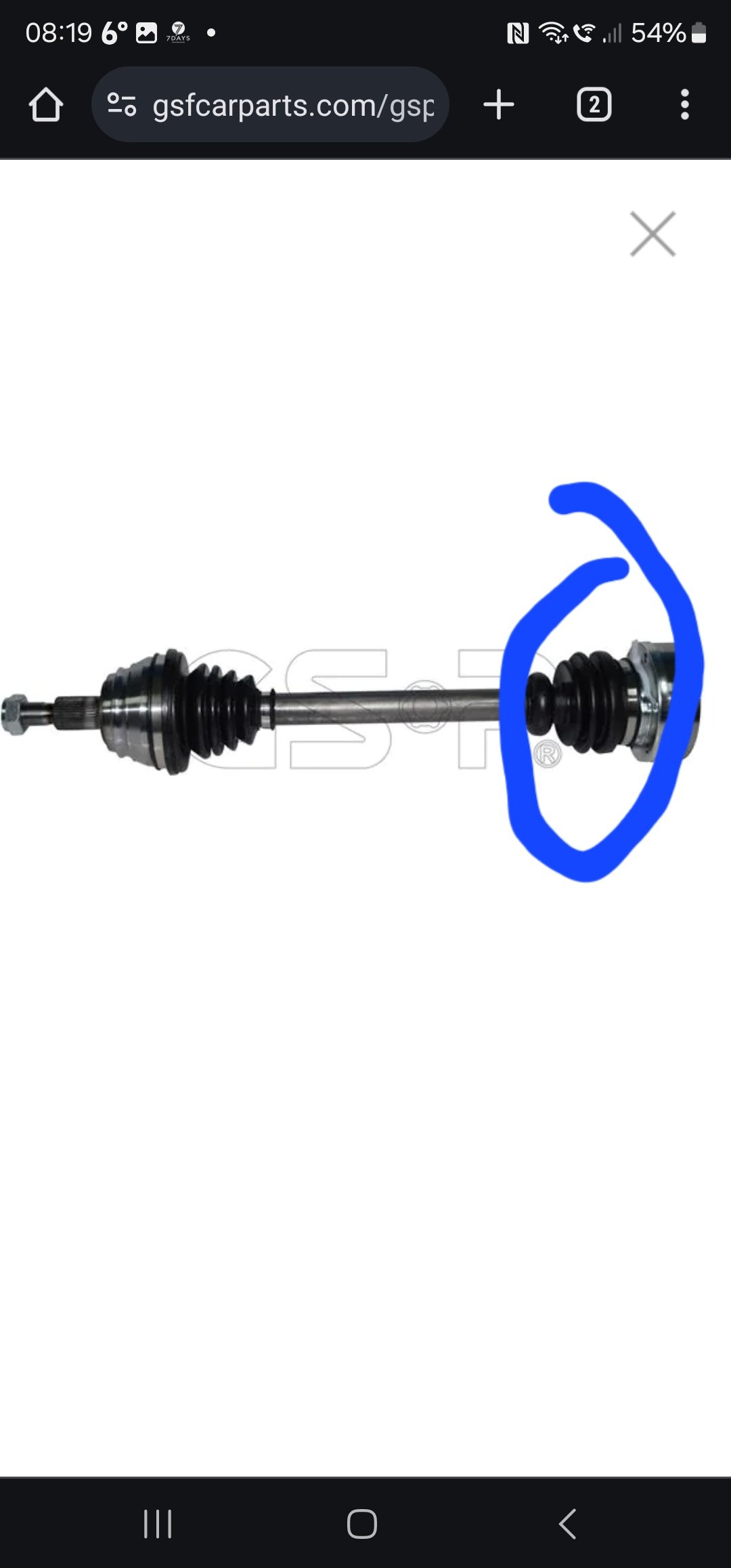

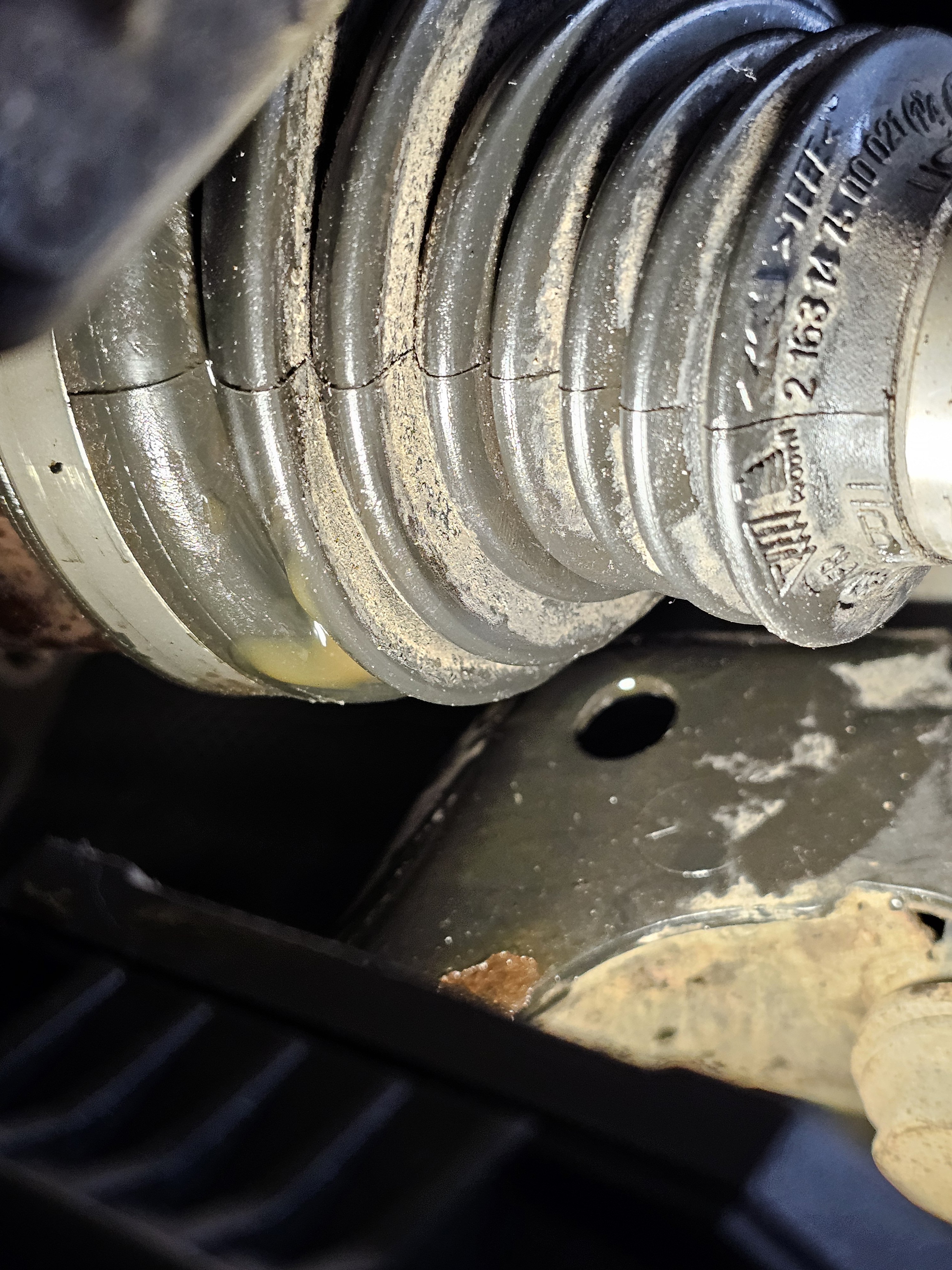

  4. There was a hole in the cv witch is where the grease was coming. It was like oil consistency not grease. I don't know if I've explained it well but I'll add a picture of where failed. Had failed in the blue part and had excessive play when he rocked the drive shaft back n forth. New drive shaft and cars completely fine
  5. Thanks for your replies. IEnded up driving it with ease to a local mechanic. Turns out it was just watered down cv grease and the wobble was because the drive shaft had popped out on the inside. School boy errors . Appreciate the replies
  6. Changed my coil spring yesterday. Went to take it a test drive and the wheel felt like it was going to wobble off. Straight back home and checked everything was tight and it was. Noticed oil coming from inner boot on my passenger drive shaft Can anyone tell me what I've done wrong ? Any help would be much appreciated
