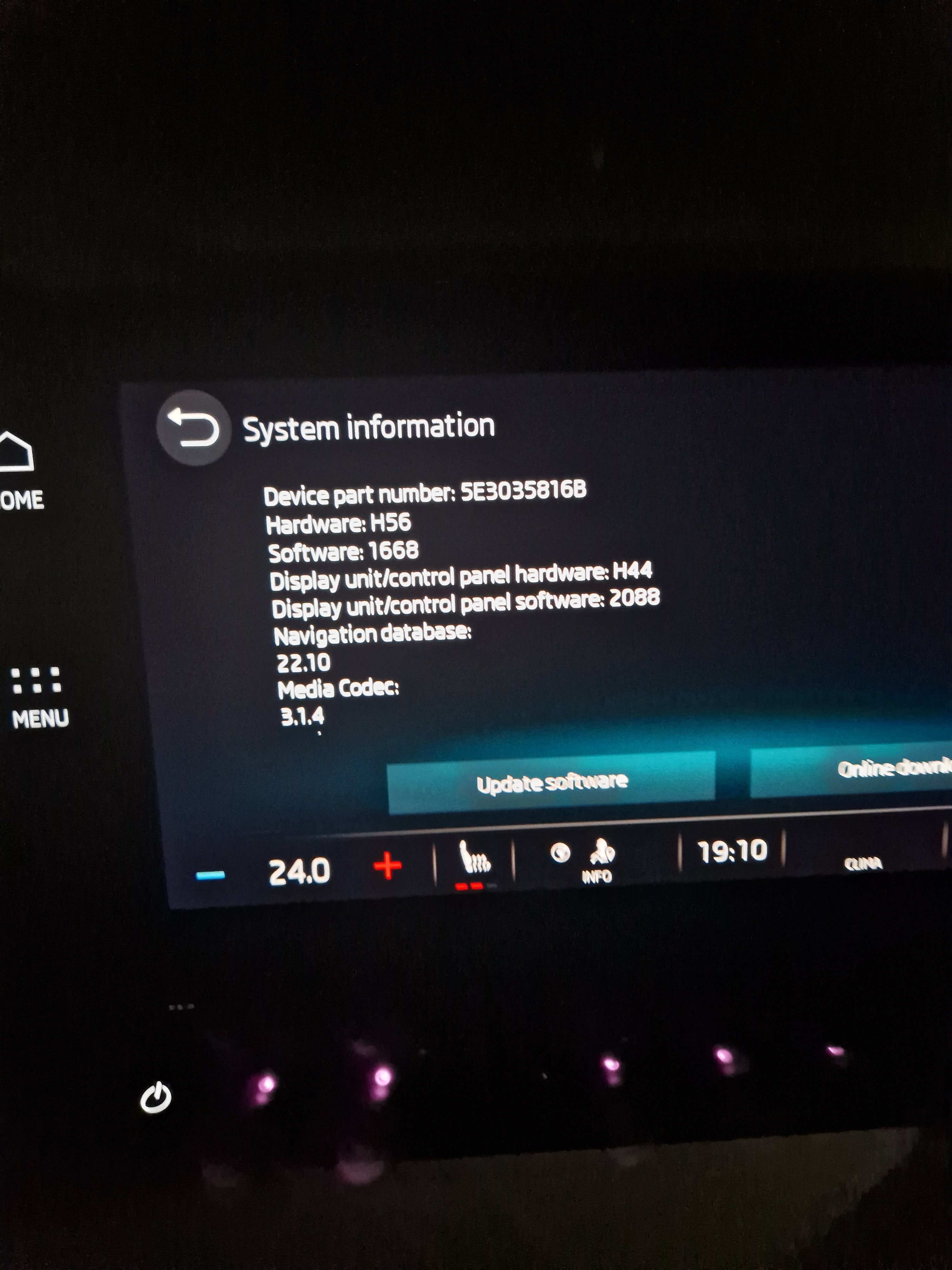

  10. Octavia 4 2.0TDI 2020 DSG 150hp When cold(cca 50c) and i take off from red light or exiting roundabout i get juddering when (I apply very light gas pressure) accelerating? it's almost feels like blown gasket or something suffocating the motor as whole cars judders and vibrate. Yesterday this happened also on 90c? But never at the highway or when driving more aggressive. Acceleration is very good and there is no yellow gunk on oil cap also also i have not seen any oil around the engine... Is this a common thing with DSG?
  11. My dealer updated it to 1941.. ive been waiting for about 5-7 hours 😮
  12. Thank you for information! Where can i find the link to 1896 firmware? I've searched on web but no luck finding it on my own.
