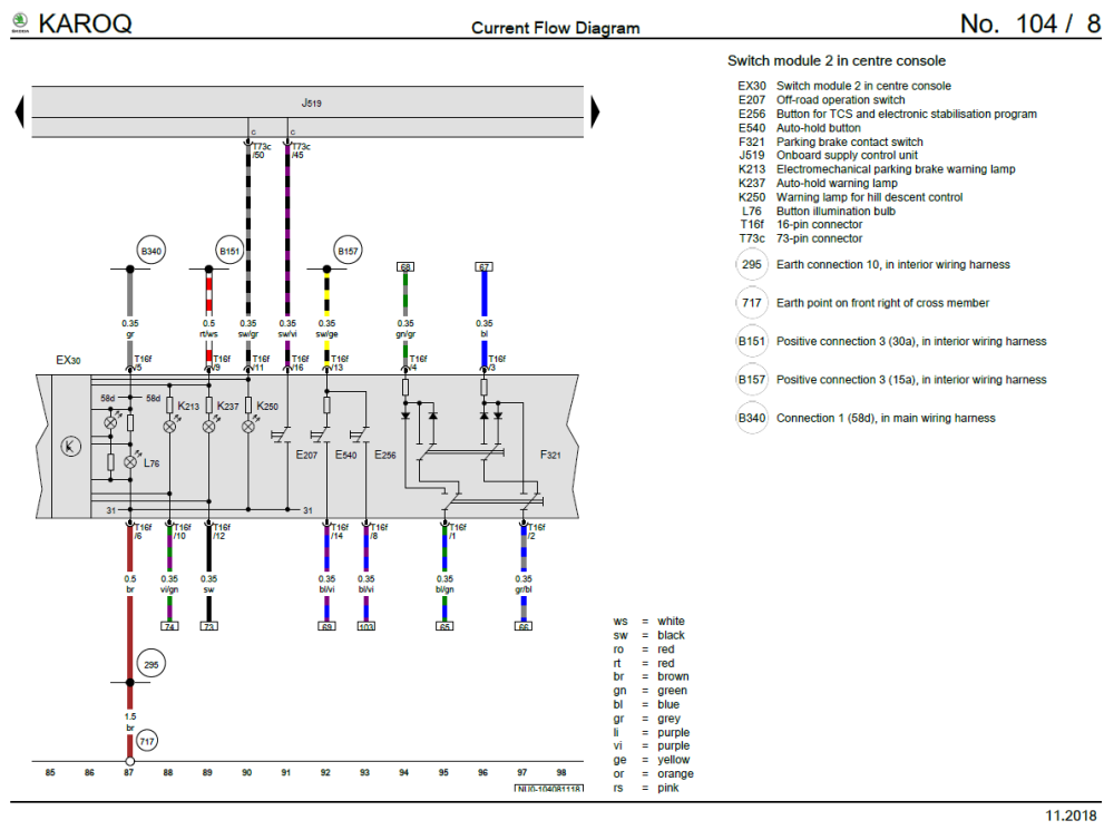

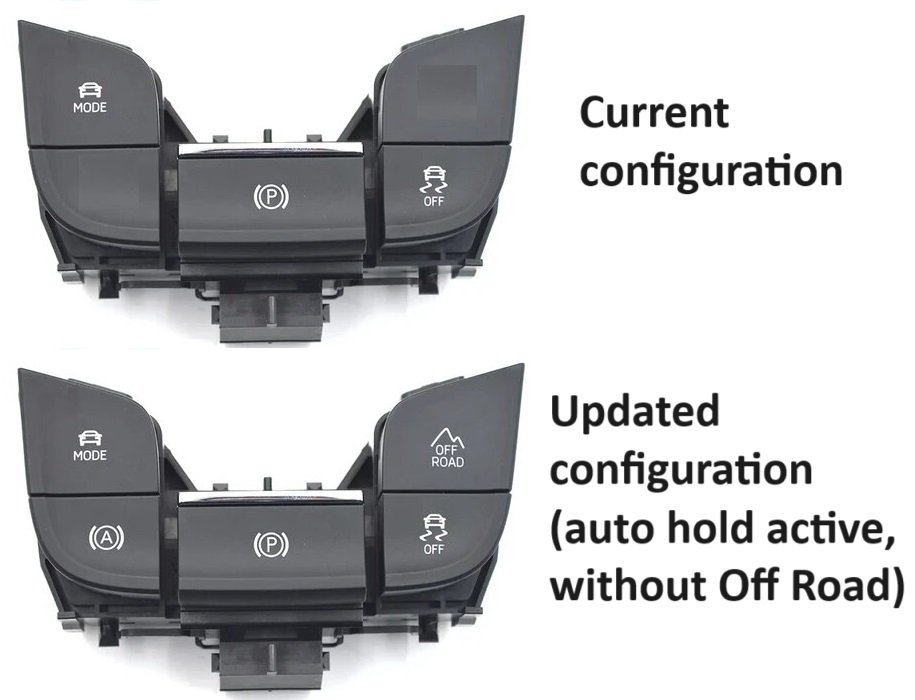

  1. Hello. I am considering installing the auto hold system on my Karoq 2022 Facelift (with Adaptative Cruise Control (ACC)). I have reviewed the electrical diagrams published in the Briskoda downloads section and so far it is possible to do this update. But I would like to corroborate the information with the most recent wiring diagram. Does anyone have the wiring diagram with the version with the 5 buttons installed (include driving modes).
