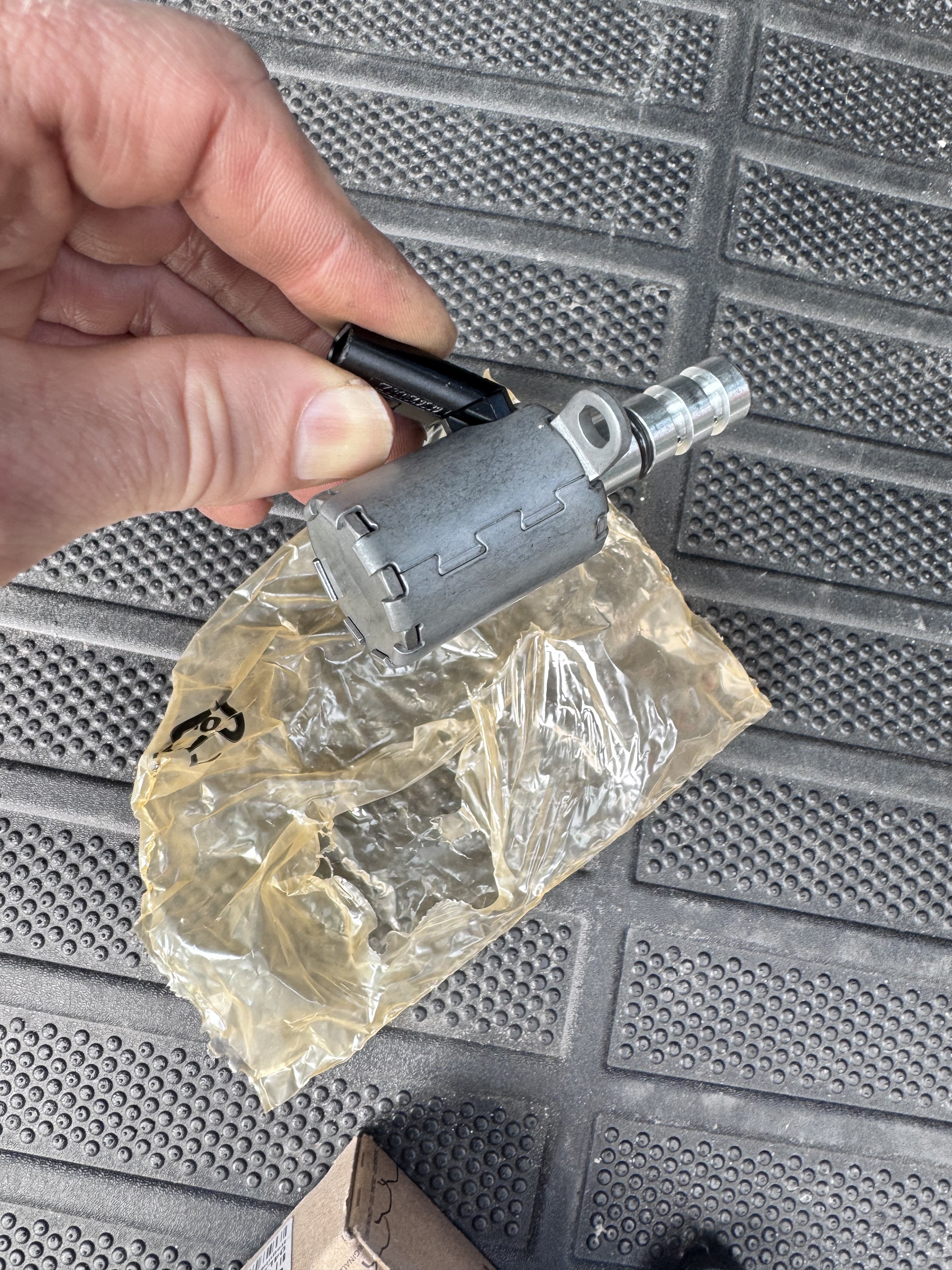

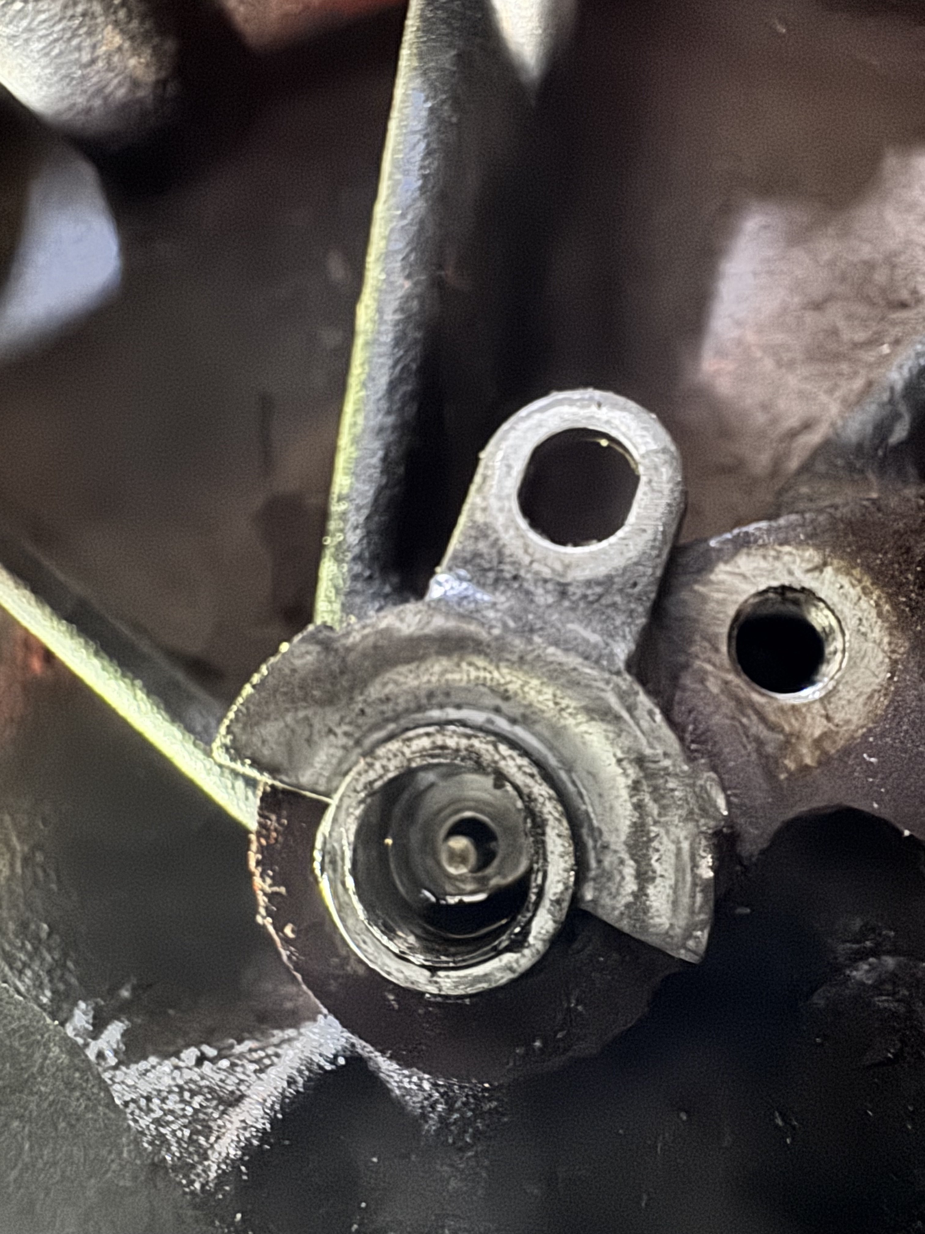

All sorted. Bumper off, radiator and AC removed, allowing full access. Drilled, tapped and removed with bolt and slide hammer. Expensive fix but these things happen. My observation is that the aluminium body oxidised and reacted with engine casting to seize. After replacing sensor, at least my ACC now works, which was the reason replacing in first instance.

Does anyone have any experience with replacing oil pressure regulator on Octavia Mkiii 1.6 TDI? I’ve actually tried removing, but have snapped the body off. I took it to friends garage this afternoon and they too also struggled to remove remaining bit stuck in engine. The insert would just not budge. I’m in some serious trouble any help guidance really appreciated!

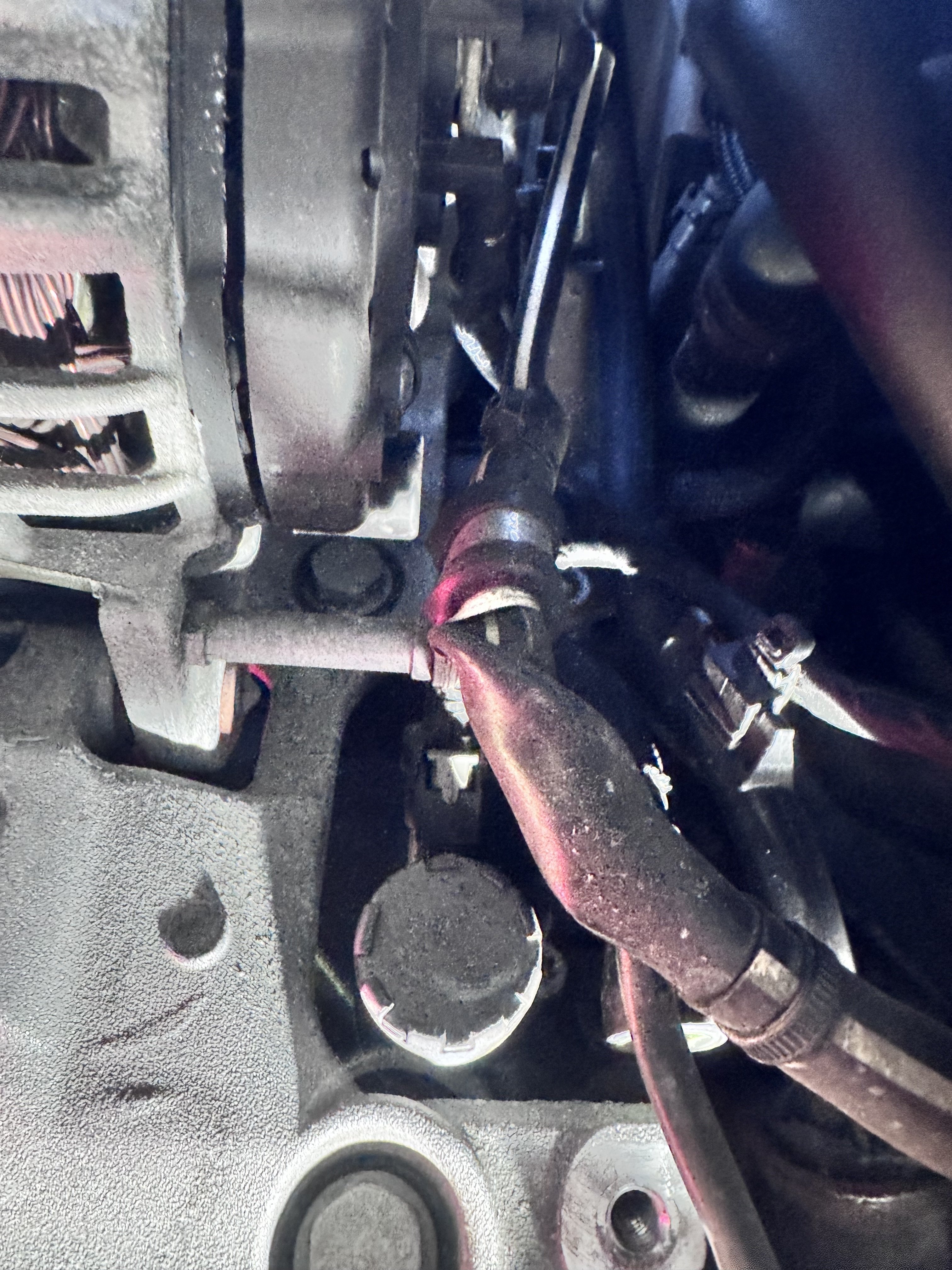

I think it was damaged by a broken push in cable tie. This cable sits right under the engine cover, so if not secured with the cable tie it could get crushed. I’ve temporarily repaired each wire with electrical insulation tape and joined. I will look at removing wires from connector and fitting heat shrink for a more robust repair. Plus fit a new cable tie clip. If it sorts the issue I wouldn’t have needed to spend £2.5k on new turbo!

Just taken a look at wire harness to turbo actuator and found damage to wire insulation. Could this be the cause of the intermittent turbo fault? It always seemed to be prevalent in wet and damp conditions!
