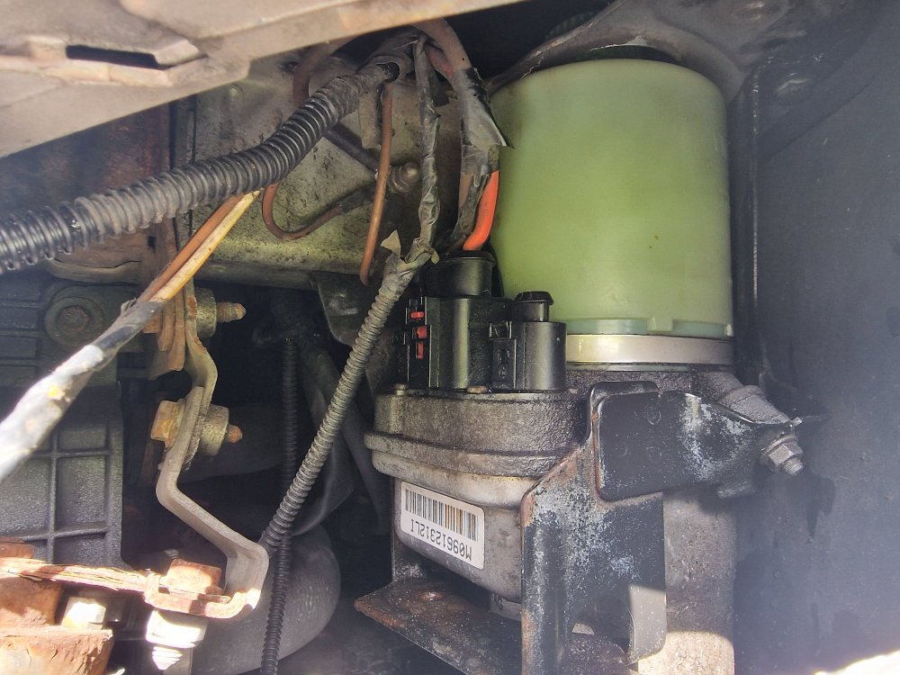

  1. I still have one last option, I have to measure the voltage in the connectors. The pump is original, the VW logo and part number are stamped on the plastic parts.
  2. Yes, the cable entry is completely closed. So it will probably be to replace the pump. Can I use a TRW pump from a 2013 petrol model? I have one at home. Thanks
  3. I have a problem with the power steering. The 50 amp battery fuse was blown (resolved). I checked the pump today and there are 3 plugs. The one plug on the right has no wires. Is it in the order or something is missing there. TRW pump 2011
