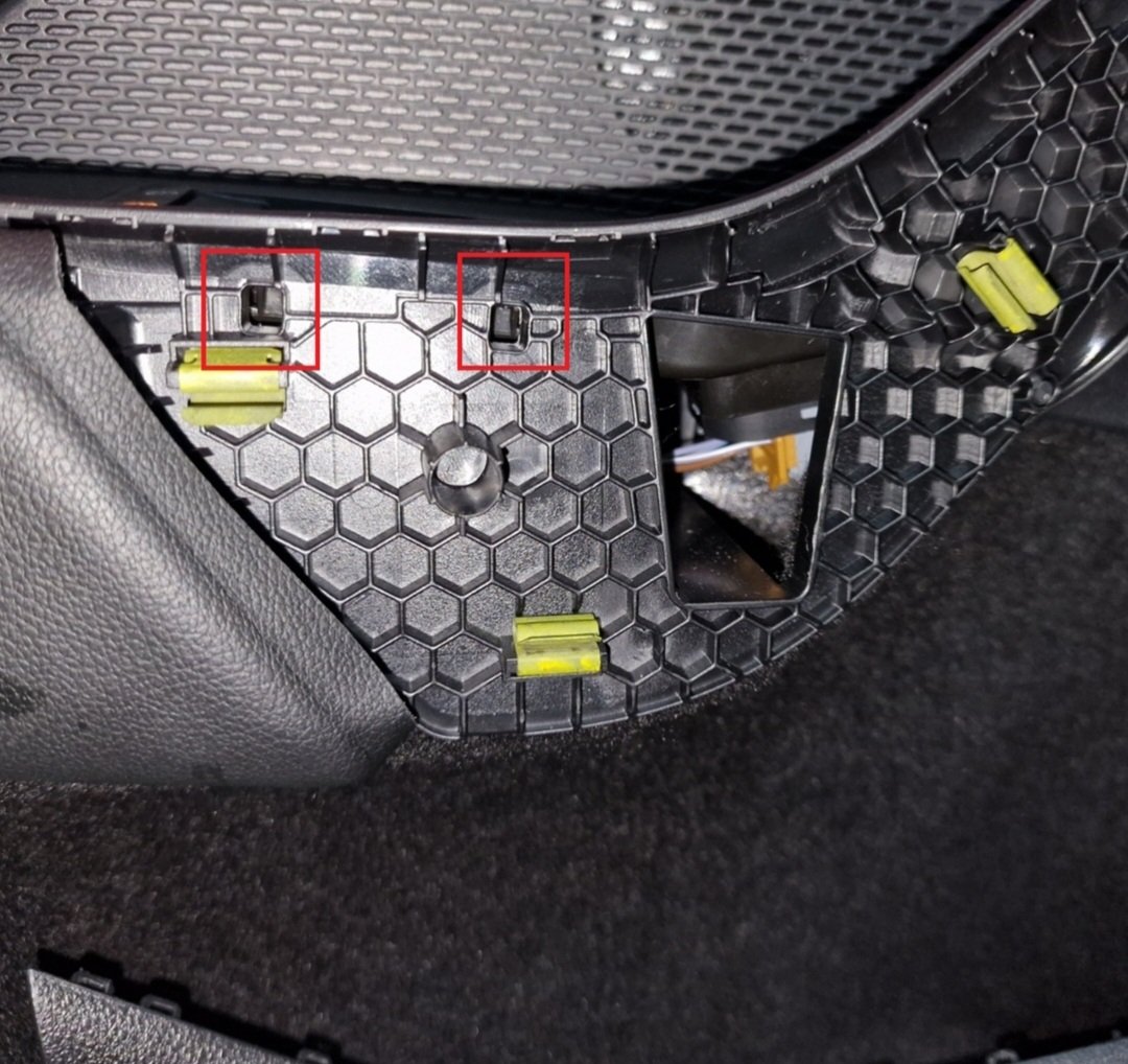

  11. These noises are sometimes pain.. i am happy that our input helped you. Dont give up.. when its getting better you know youre coming close.. removing the console is for me now a 30 second job.. so no big deal anymore.. its a game.. try something.. put the console back in and drive and so on.. the sunglasses box can also be a source of rattle.. some felt tape where the button is and it closes tighter..
  12. If the silicone effect is not that long try the skoda krytox spray or lubricant for cars for a much longer effect
  13. So,yes you are right. Its also possible that the window switch trim is squeaking. For this case take the handle cover off an spray into these little holes. There are the clips of the window switch trims which are causing the noise..
  14. i used it .. Volkswagen G052172M2 Spezial Gleitmittelspray 100ml
  15. Check out the video, just clips. Very easy to take off, in my case it helped a lot to reduce the squeaking noise.
