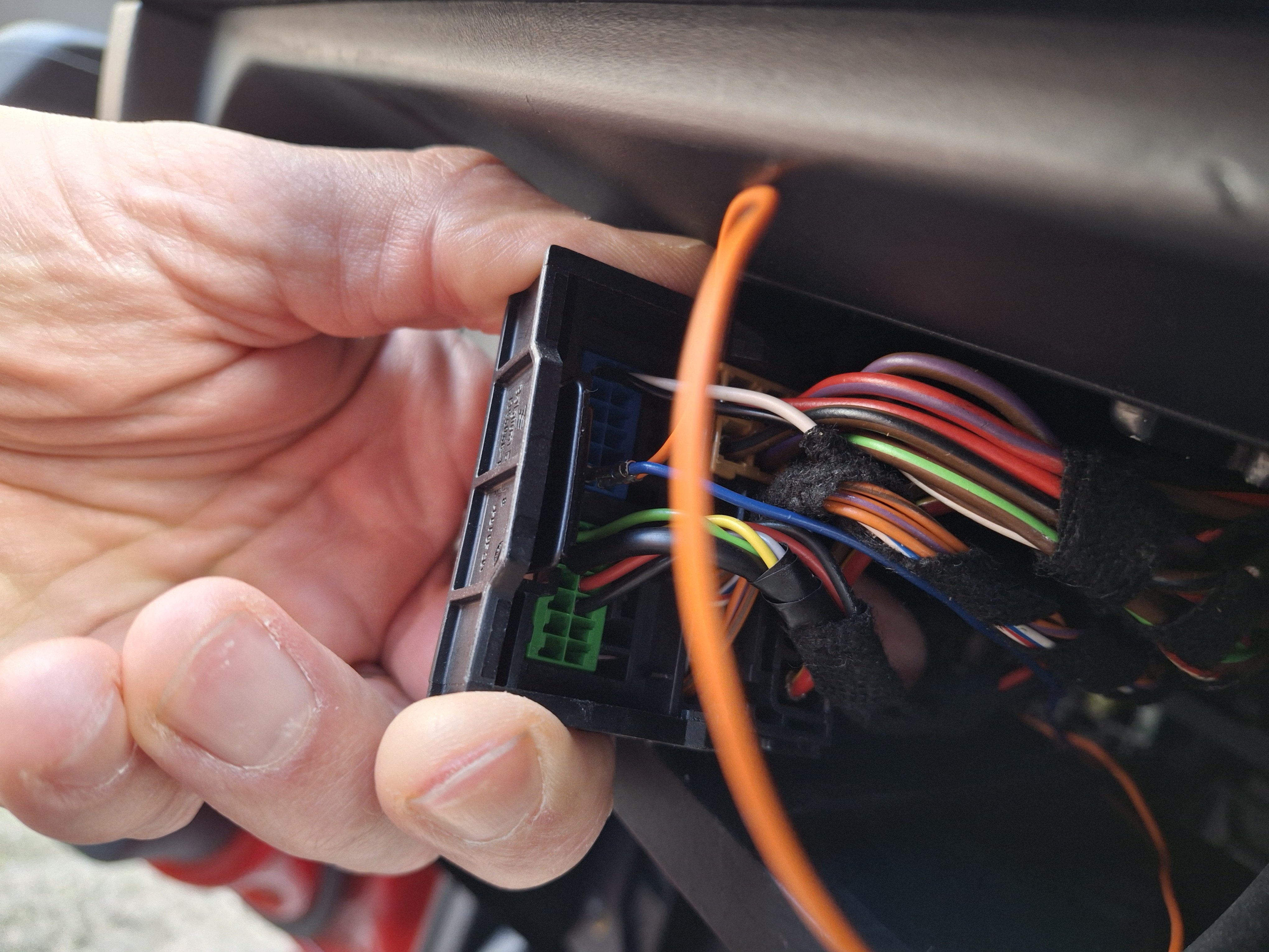

  10. Ok so I swapped the video cables and in obd11 now I get a message that quadlock cables are improperly sloted. So I reversed it back and no issue anymore but still no picture. Should I try and rewire the ceam from rear wiper to reverse loght? Also, since swapping the infotainment system, I got some new errors on the scan with 'compotent protection active' in the gateway and multimedia section. Is there any chamce that I am doing everything ok but the lock is what stops the video feed to the display unit?

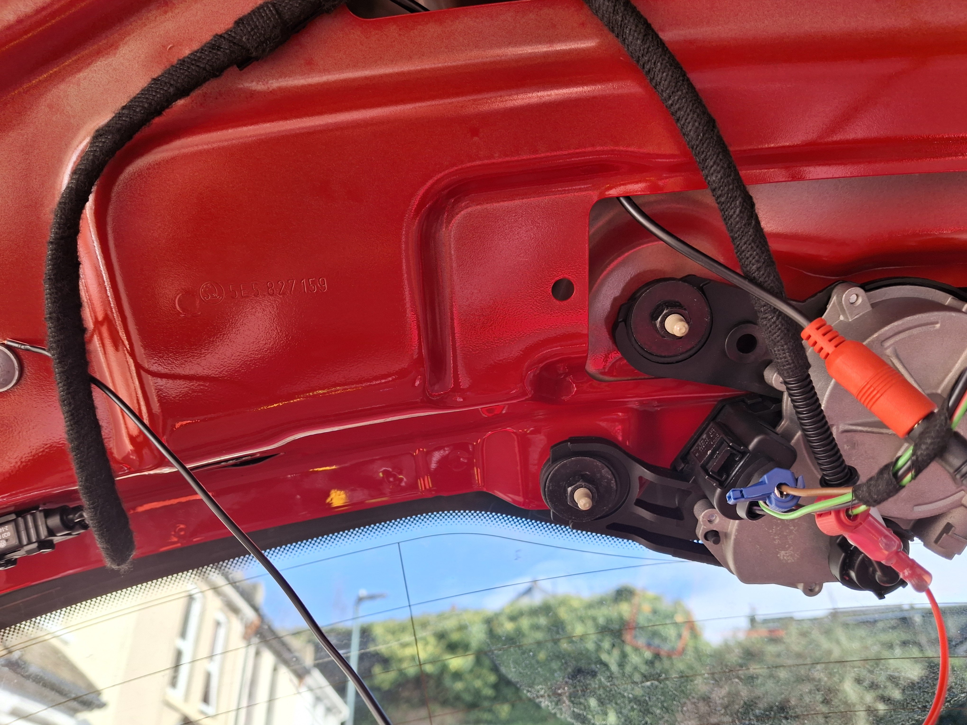

  12. I have the video cables in the quadlock in 6 and 12. The T-clips are on the power wire now with 12v (checked with multimeter). The ground is on a screw of the boot The flimpsy wires in the pic are just extensions from the video cable ro thw quadloxk. All soldered now and sitting nicely. I even run OBDEleven yesterday and it detects the camera but also reports a fault: no camera signal

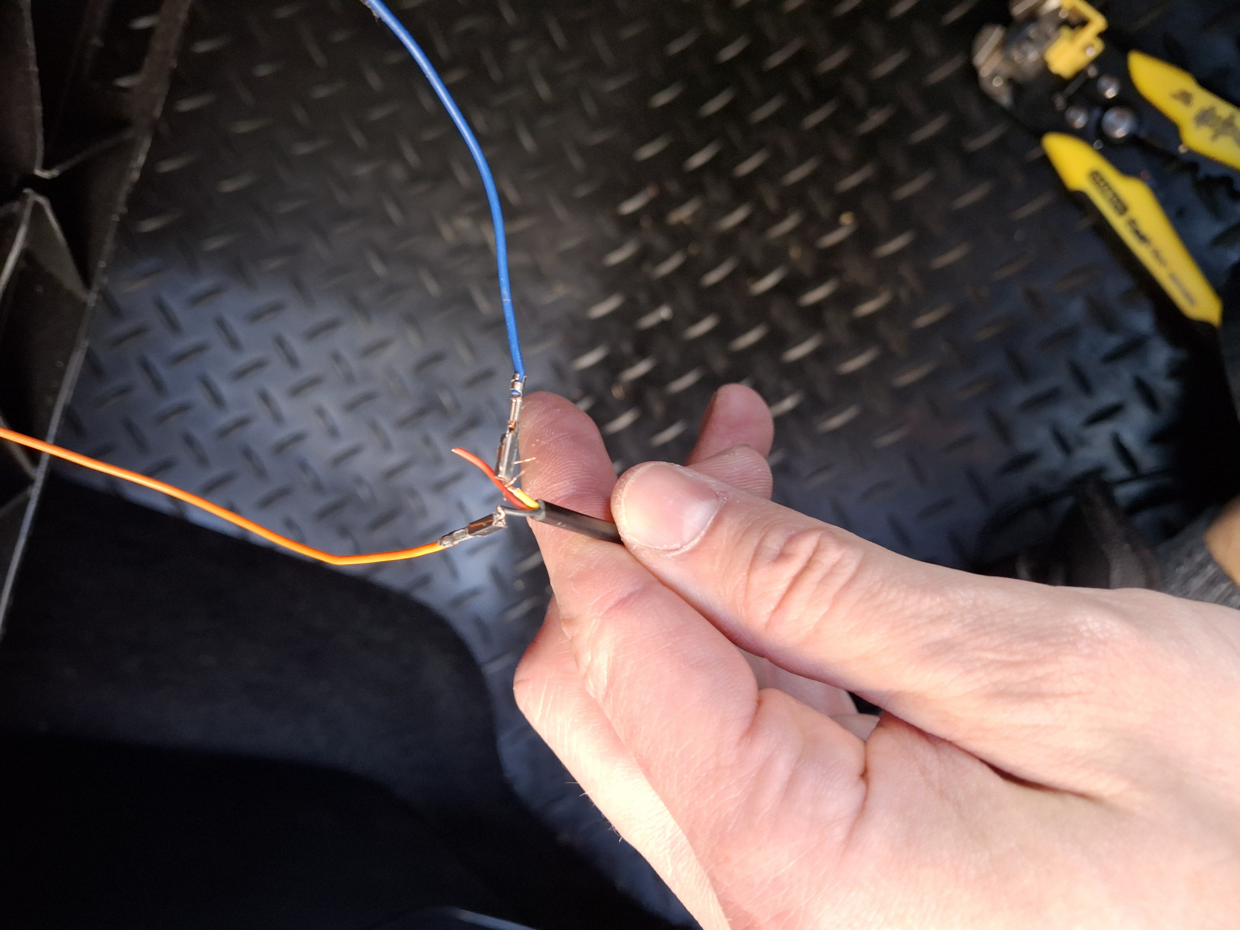

  13. I had the yellow round plug on the other end. Had to cut it off and create a split and solder extensions

  15. Just a quick one, hopefully. I am on.last stages of installing a reverse parking cam in my Octavia MK3. I just can't get the power/signal. I T-plugged the 2nd (red and green) cable from the rear wiper to the red cable from the cam - micrometer indicates 10v I connected the black cable from the cam to a body screw I connected the audio signal wires to port 6 and 12 in the blue square at the back of the infotainment system And I am still not getting any picture when in reverse, only message ParkPilot is currently unavailable
