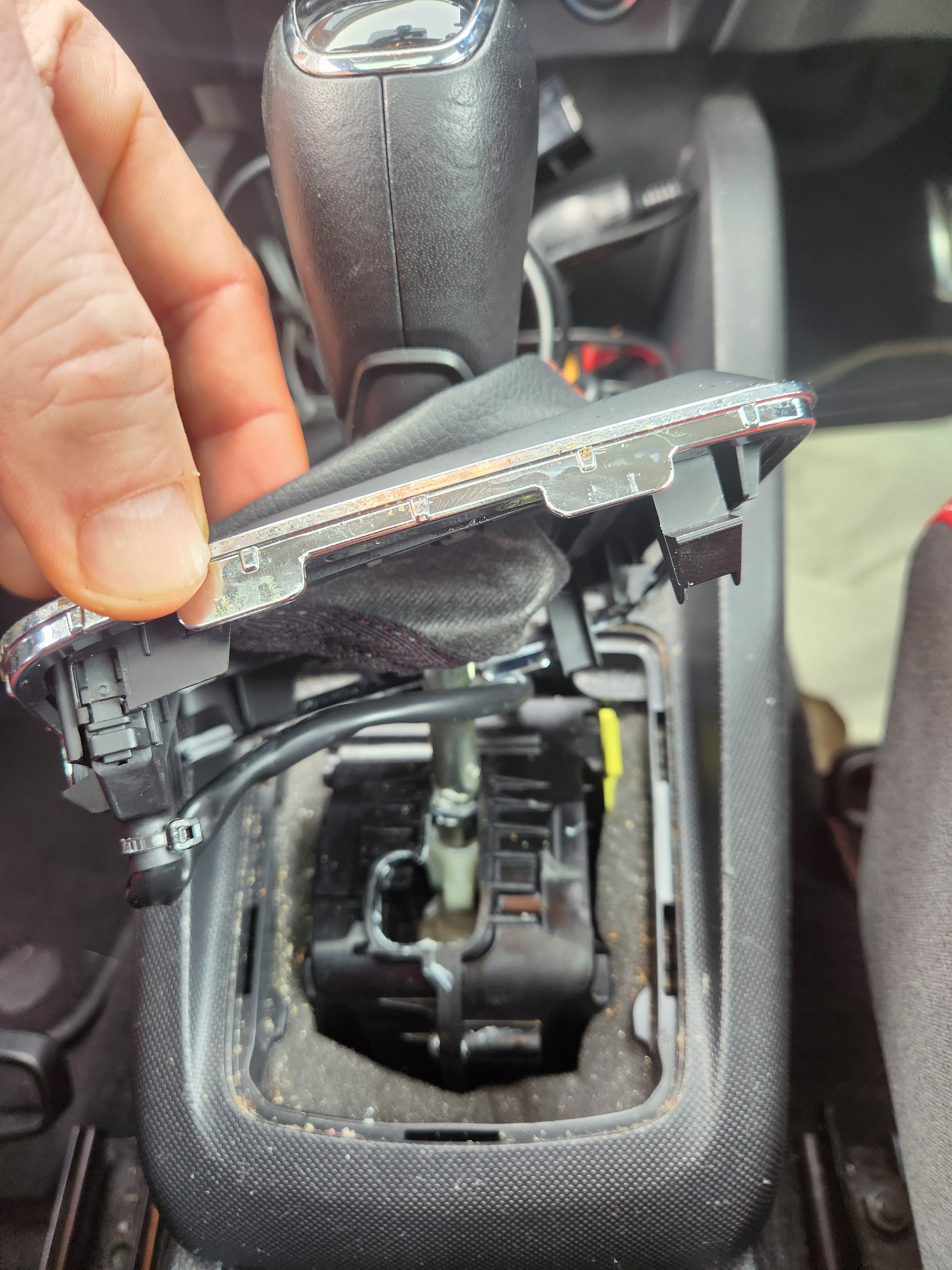

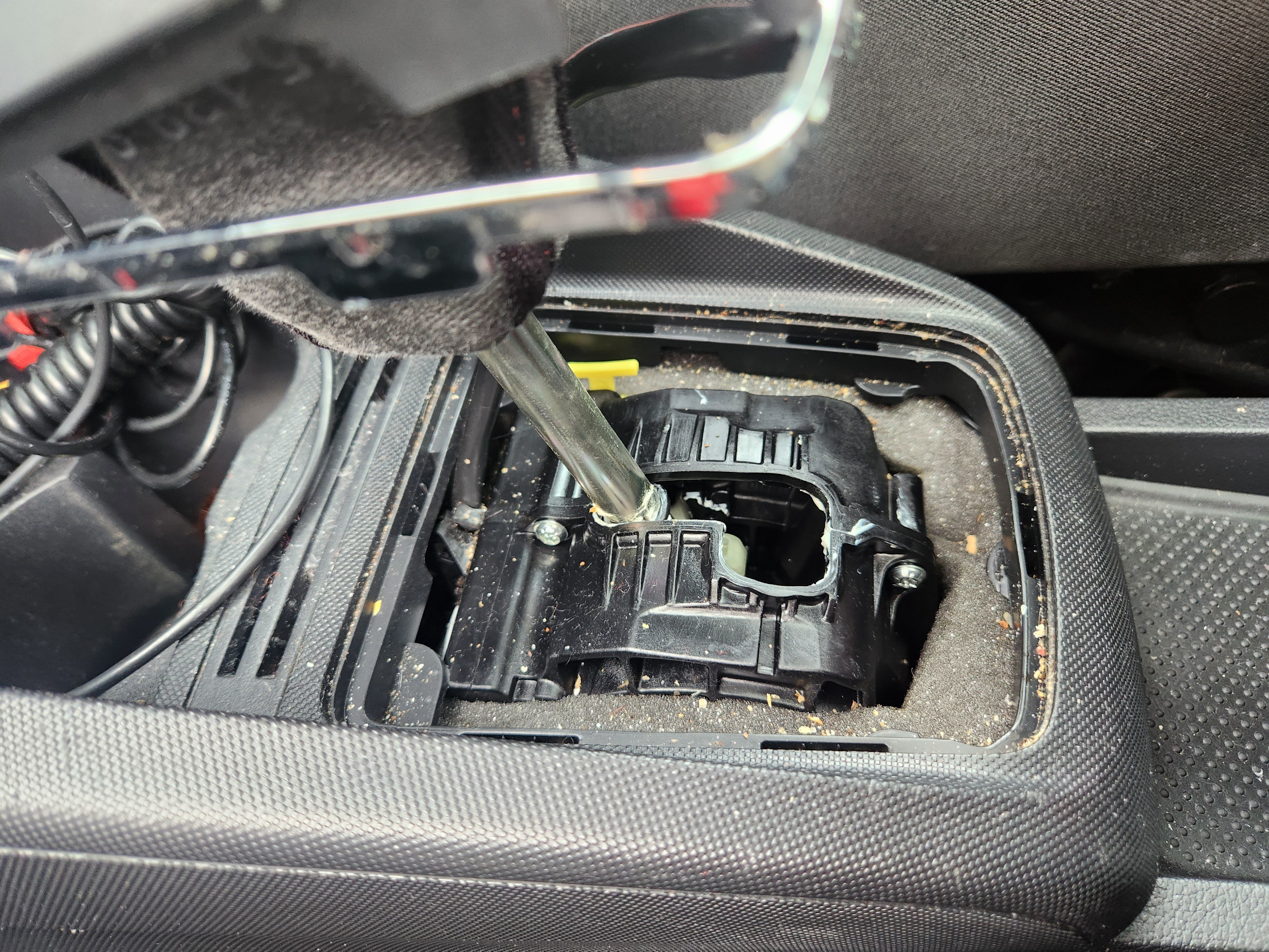

  2. This is my video of the housing. Don't think there is enough room to fit a switch https://youtu.be/7iQ437zupMY?si=2m_uuoUEbcKGrj3O

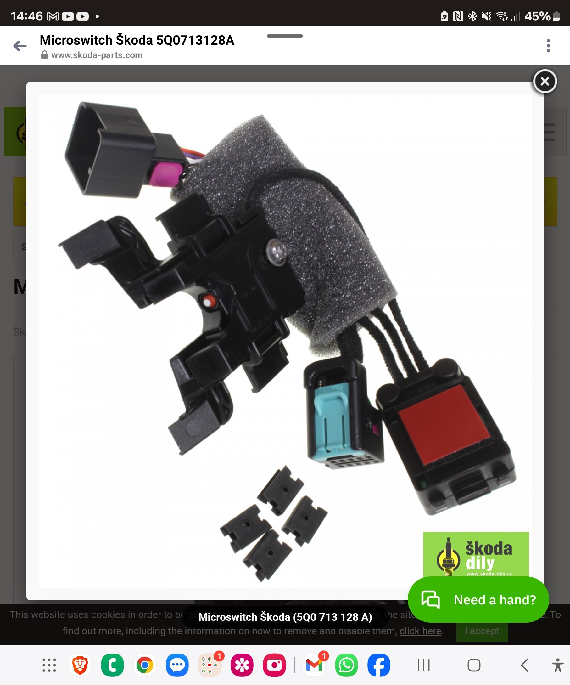

  5. I'm told that this switch is what's needed. Has anyone fitted one to this vh before? This is a link to a YouTube video with the bloody fix, however it's on am octivia VRS not a Fabia. Trying work out if I need to dismantle more of the black gear housing and if the below switch fits under that housing. https://m.youtube.com/watch?v=qb0MkXR5-Dw&si=yaZxVUDpbev-pcJ4
  6. Fabia monte carlo 2017 DSG sensor fault. Has anyone else encountered the error "leave in park" fault? The DSG works perfectly so I'd imagine it's a faulty sensor/switch, however the main dealer in Newcastle, Staffa want £1795 to replace the gear assembly. They don't do a switch replacement. The switch can be bought for £50 or less with a 2 year warranty, however they won't fit it. Has anyone else fixed this issue.
