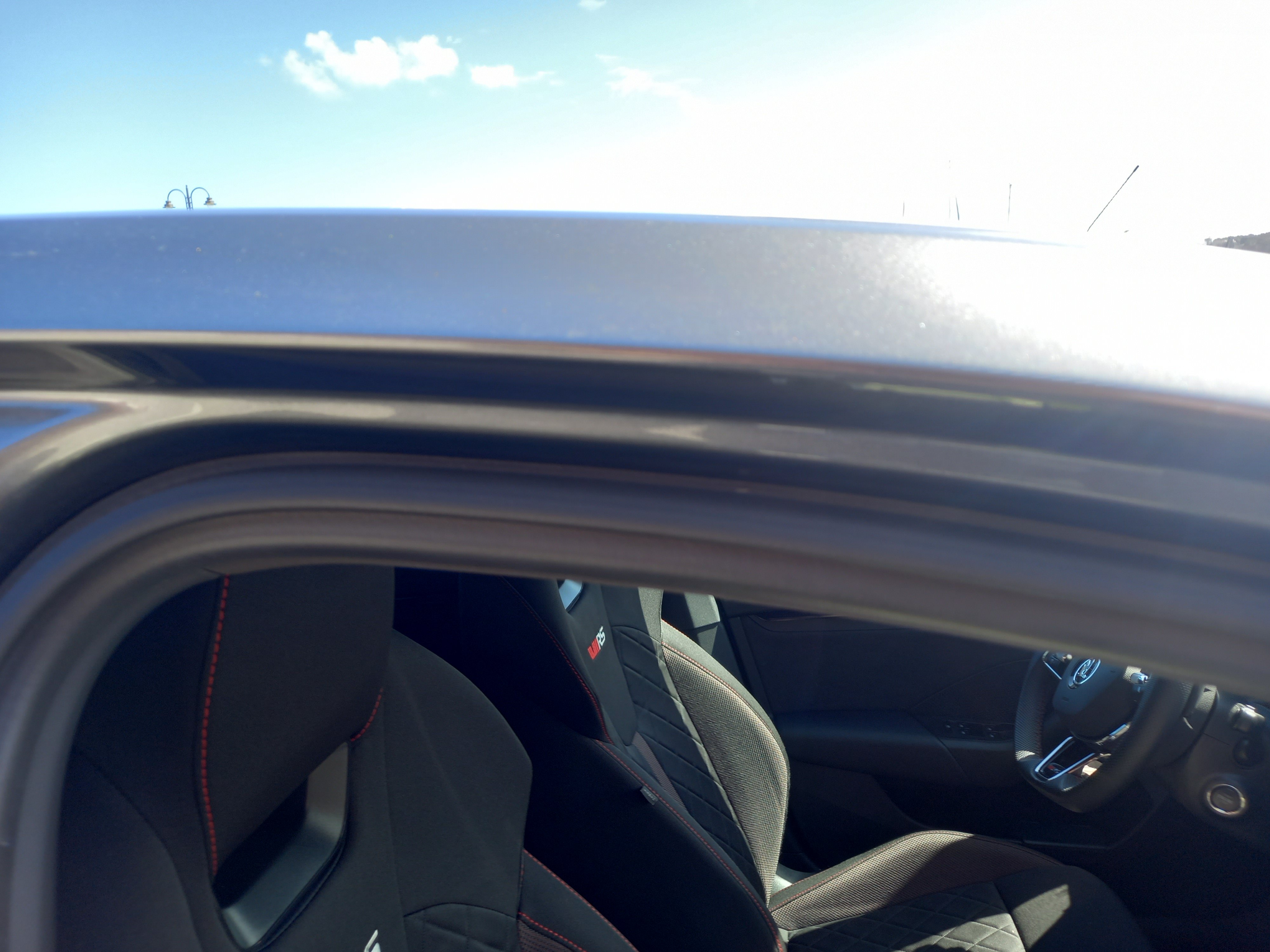

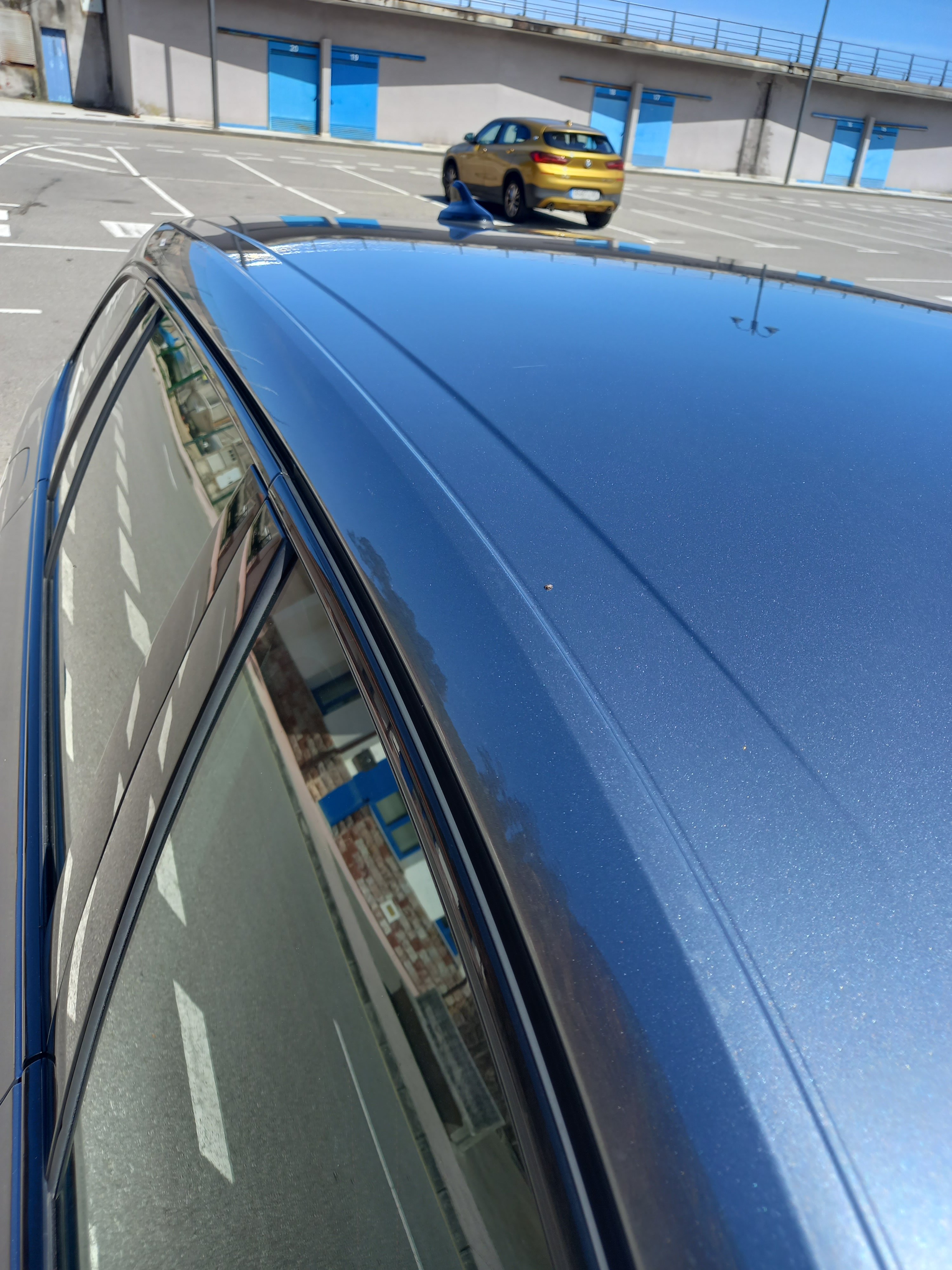

Thank you, I have looked closely and there is definitely no type of hole

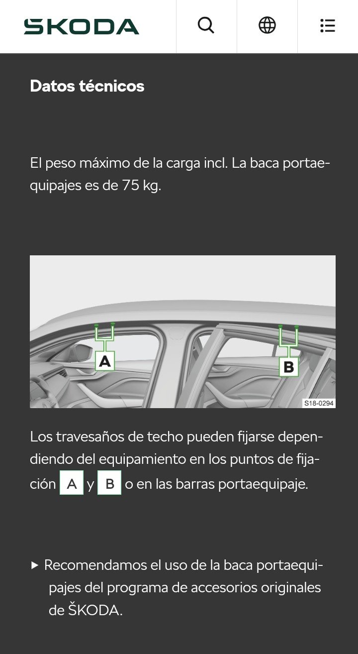

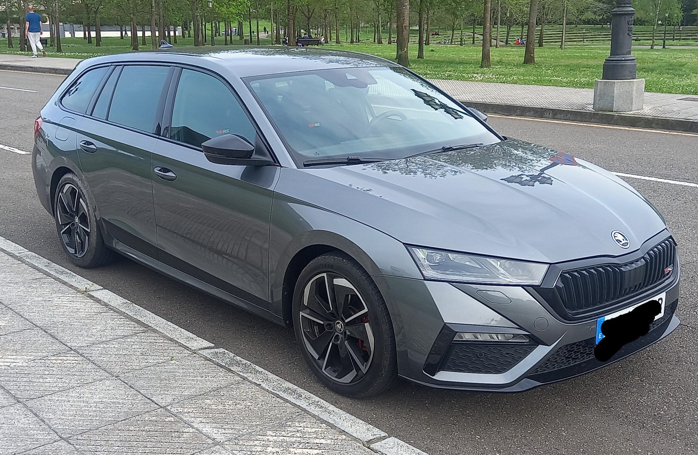

Hello. I think I have read a post with a similar topic but I can't locate it. The thing is that I recently bought a skoda octavia combi, it was a dealer management car and it came without rails on the roof, the thing is that I would like to put a fixed roof rack on it and I thought that when it came without the rails it would be placed like the one on the liftback but as seen in the photos the door arches do not have the lidtback fixing holes. Talked to Thule, they do not have a specific kit, Cruz does not respond and Internet searches do not provide solutions, has anyone been in the same situation and found a solution? .... there are always vacuum racks but I would prefer a fixed one... for my need, carrying surfboards, there are also soft racks but honestly for peace of mind I prefer a "traditional" rack... Thank you for your attention.
