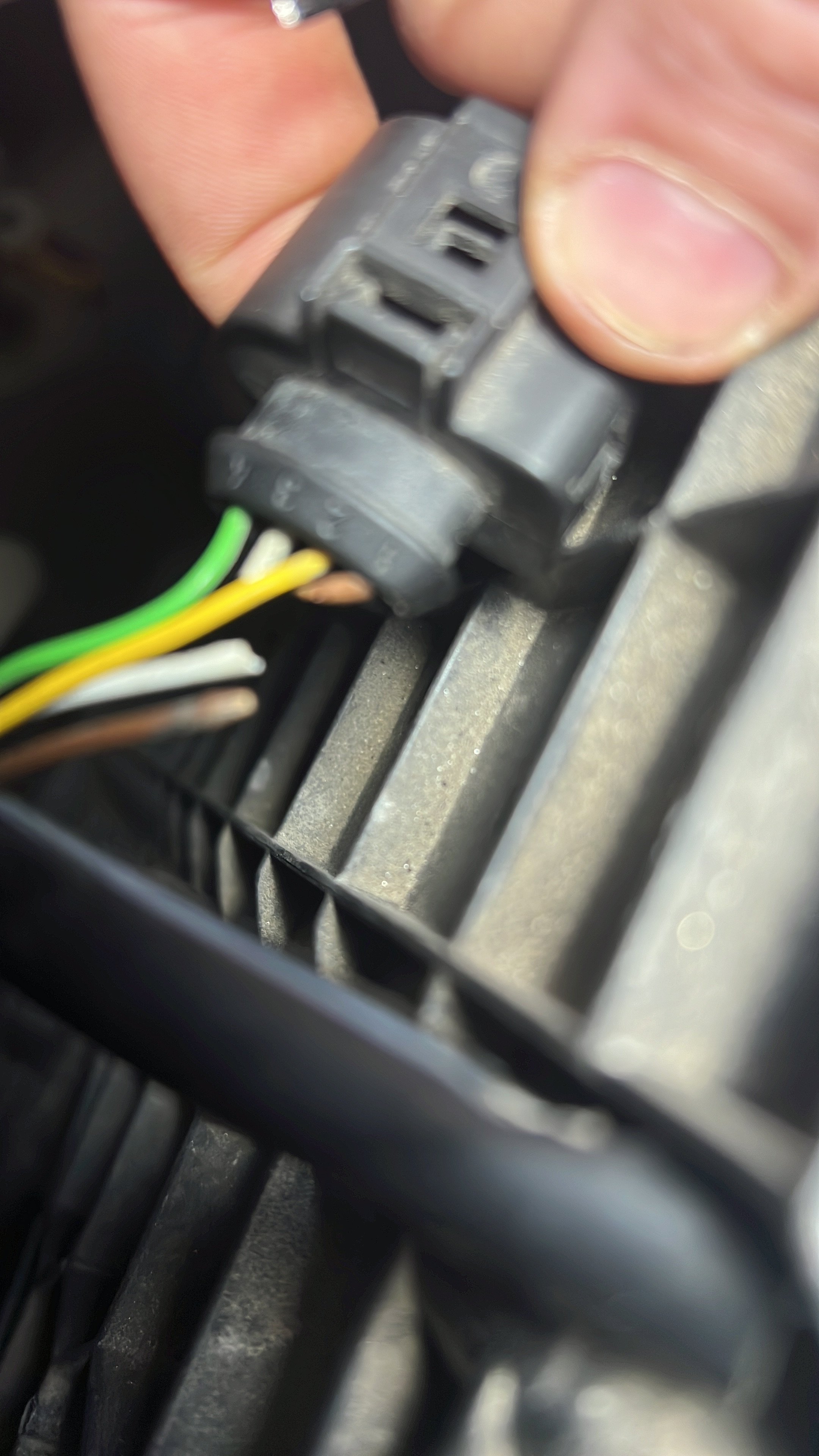

  1. Cheers for the help turns out it was the map sensor the cables had snapped to to the vibrations coming from the engine

  4. the code that is coming up is p0237 turbocharger boost sensor A circuit low
