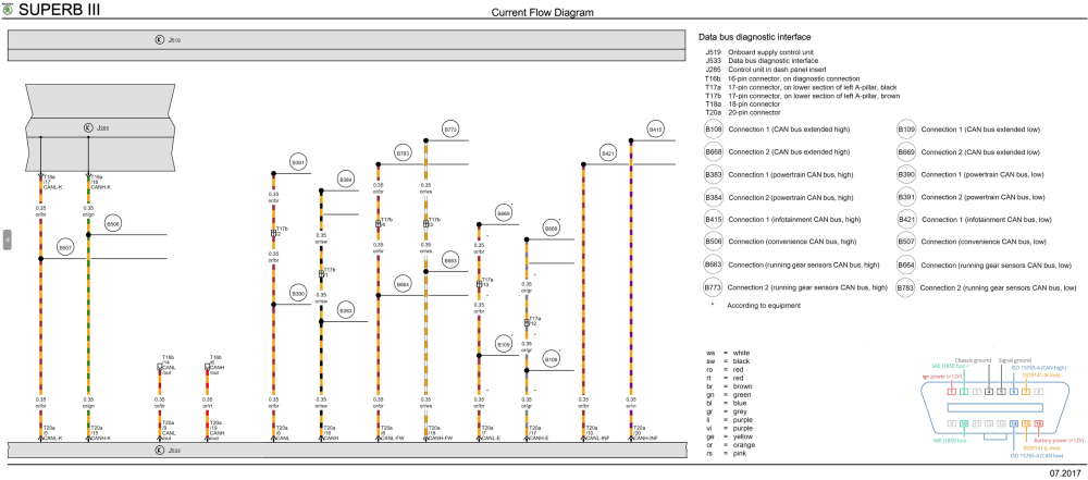

  1. @sunshinedave so the splitter I've bought from eBay goes between the gateway and the wiring harness, which is located below the steering column. Per the diagram below which i've pieced together, it would be easiest at the Gateway based on all the traffic coming in and out.

  4. Possibly, but I wonder if it's as simple as VW [in line with ISO protocol] only provided data when requested? I know with other makes [Ford/Subaru/etc] you can receive freely data via the OBD port. I'm now thinking the solution is to tap into the CAN prior to the gateway, ie. raw CAN data.
