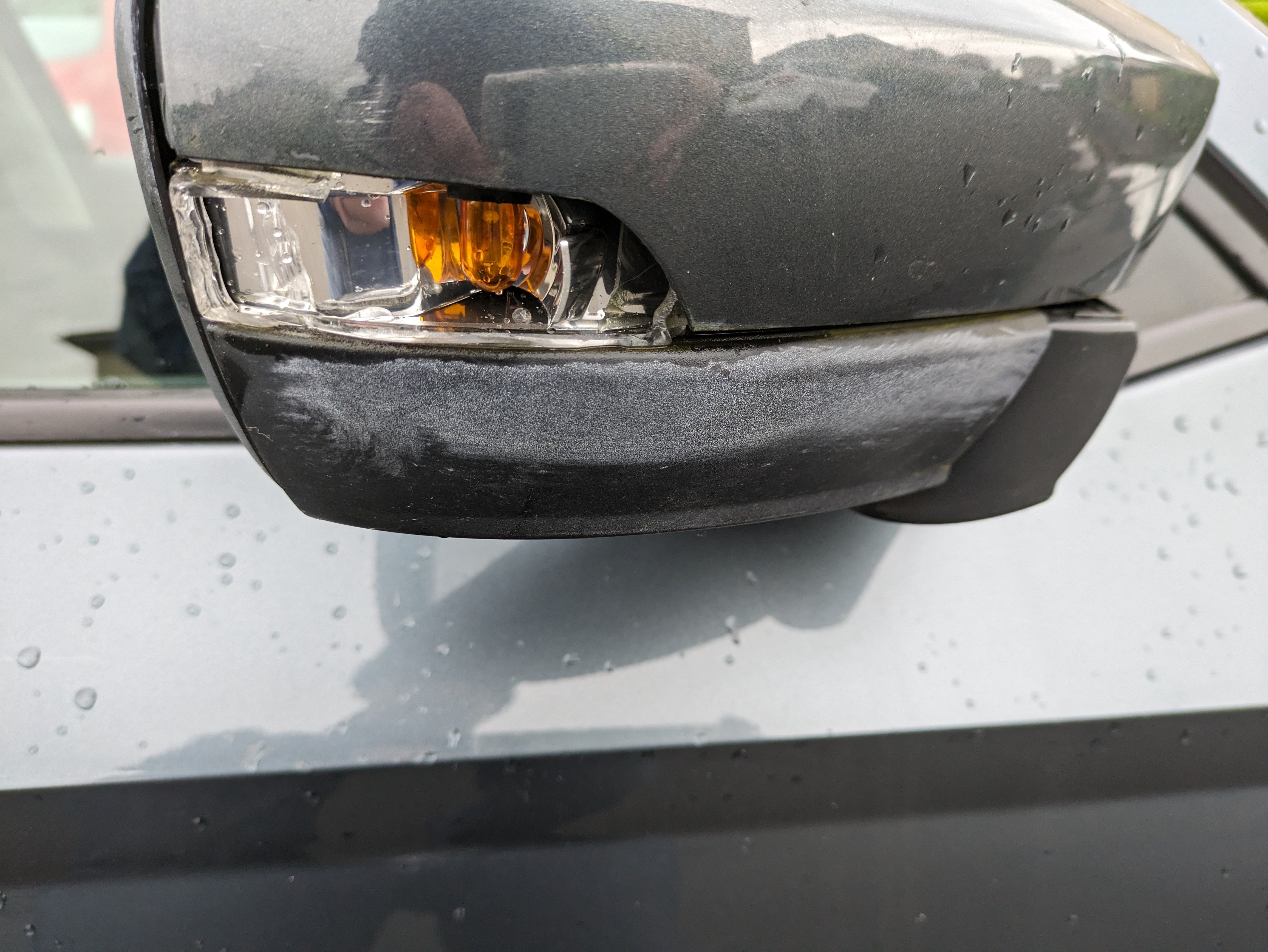

  14. Yes had a Message symbol of the Car telling me the right front Indicator was knackered. Shame it couldn't have taken a Picture of the Pr**k that hit it ๐Ÿ˜ž
  15. Thanks Managed to order the Clear plastic housing from eBay. I'm guessing the Bulb is knackered I'll pick one up. The Road I live on is a Rat Run they go along at a minimum 80 mph. My fault for not folding in the mirror.
