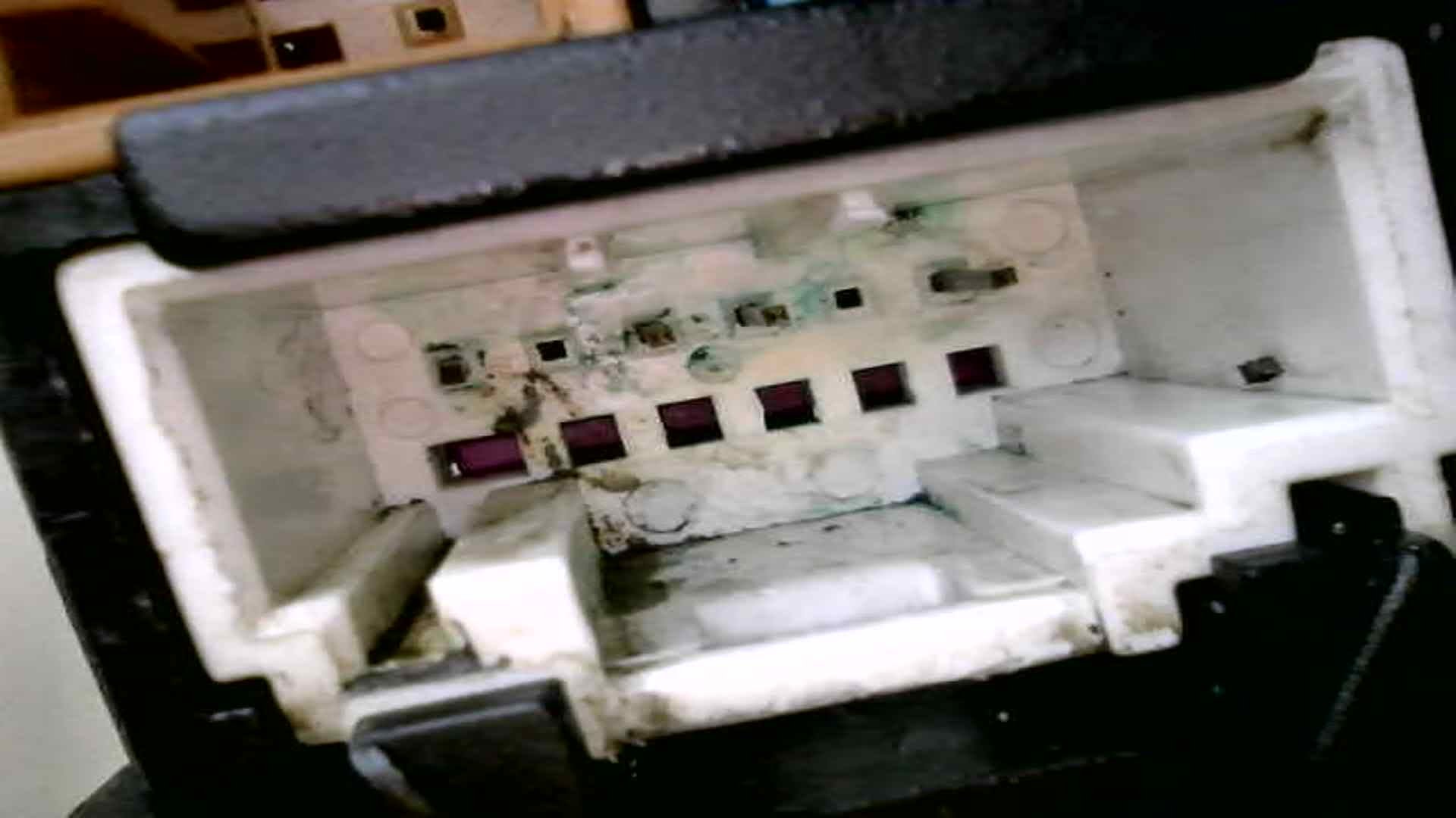

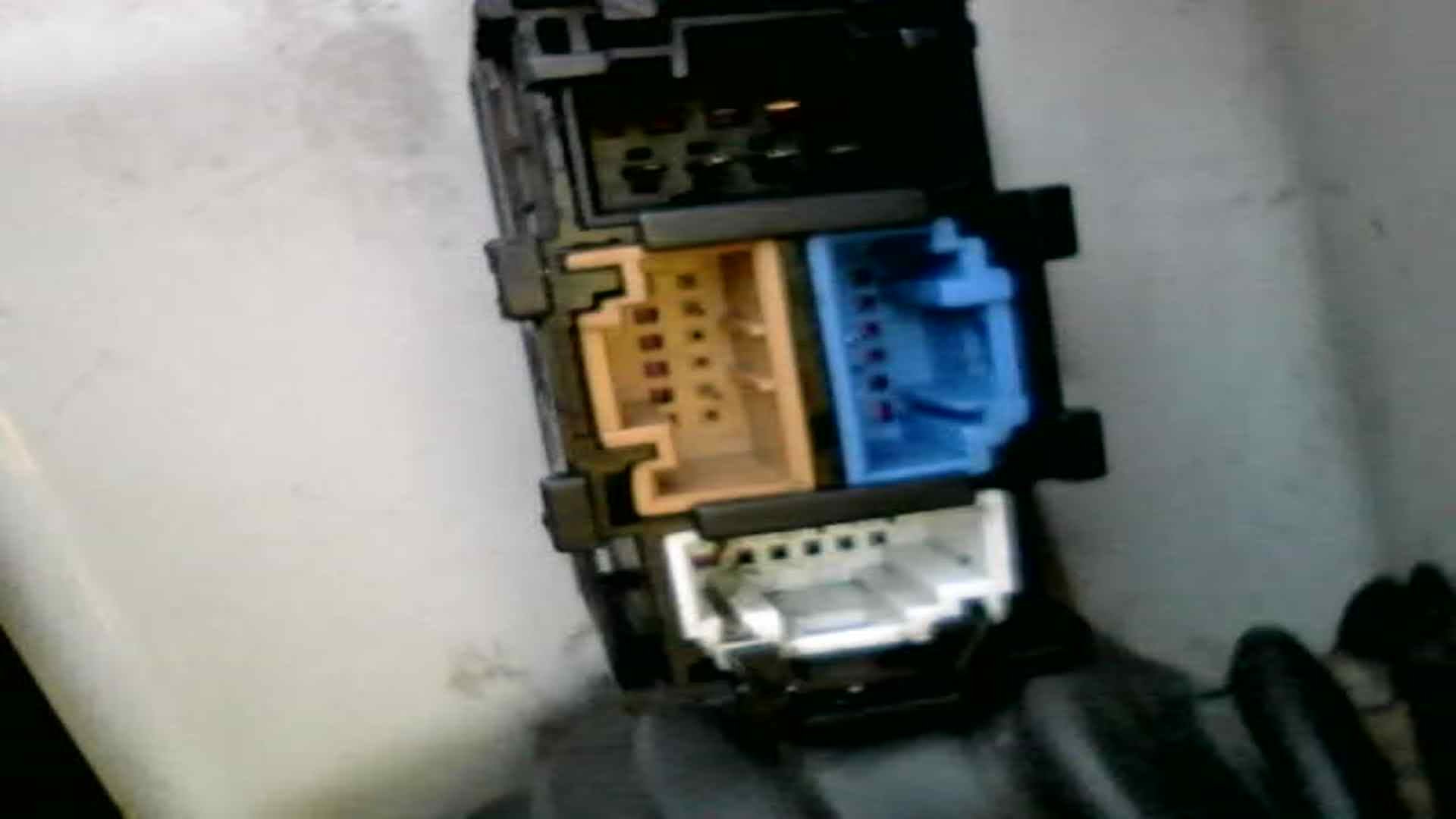

  2. Hello everyone Having had a similar door lock problem as reported by many on here, I managed to track down the cause of my problem, which turned out to be corroded pins in the white terminal block, I have managed to find a part number for the terminal block holder, but wondered if anyone knows if the white terminal block itself is something that can be purchased or is it going to be a visit to a breakers yard, any help gratefully received. Thanks in advance JonnyRRR
