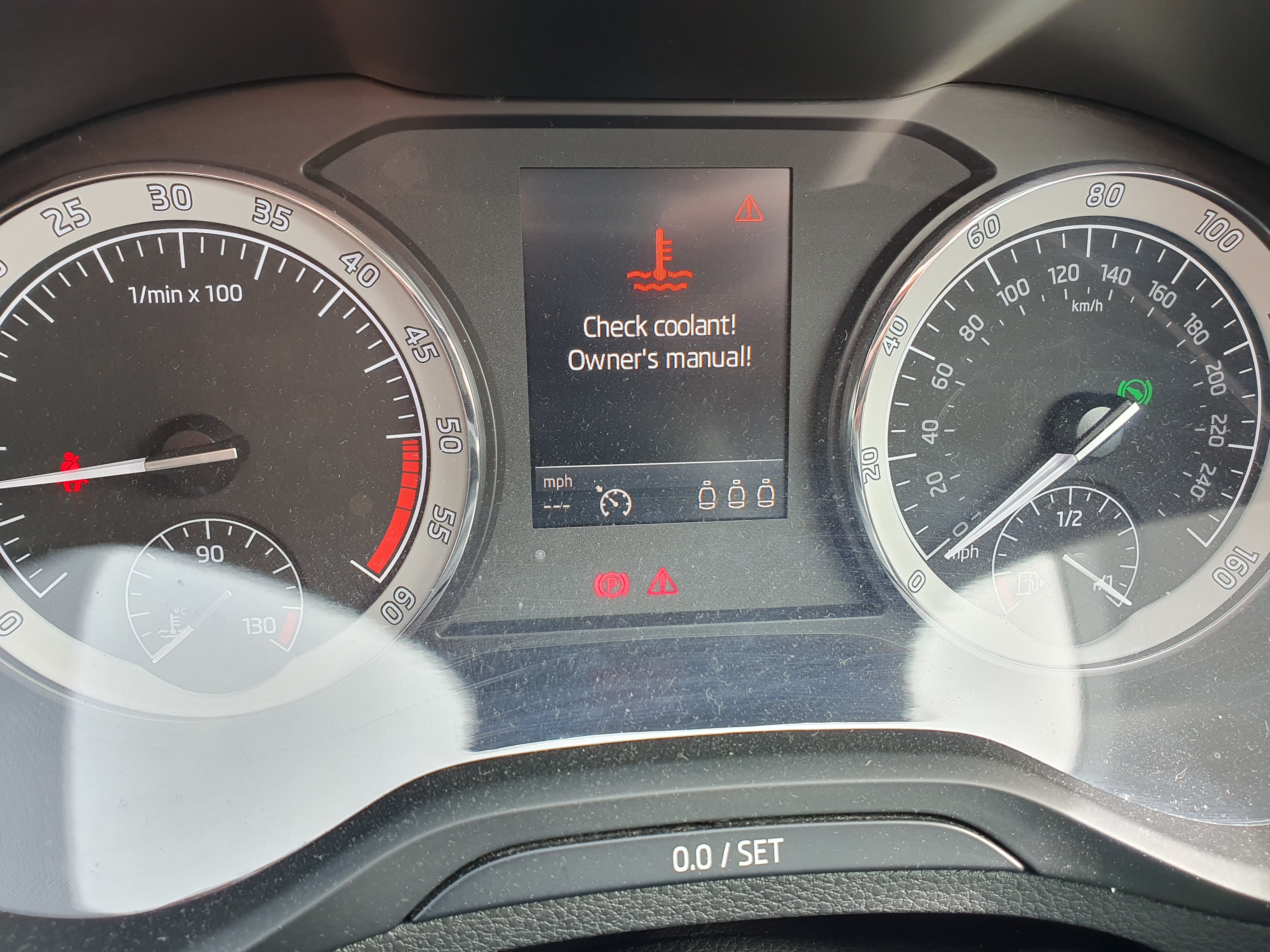

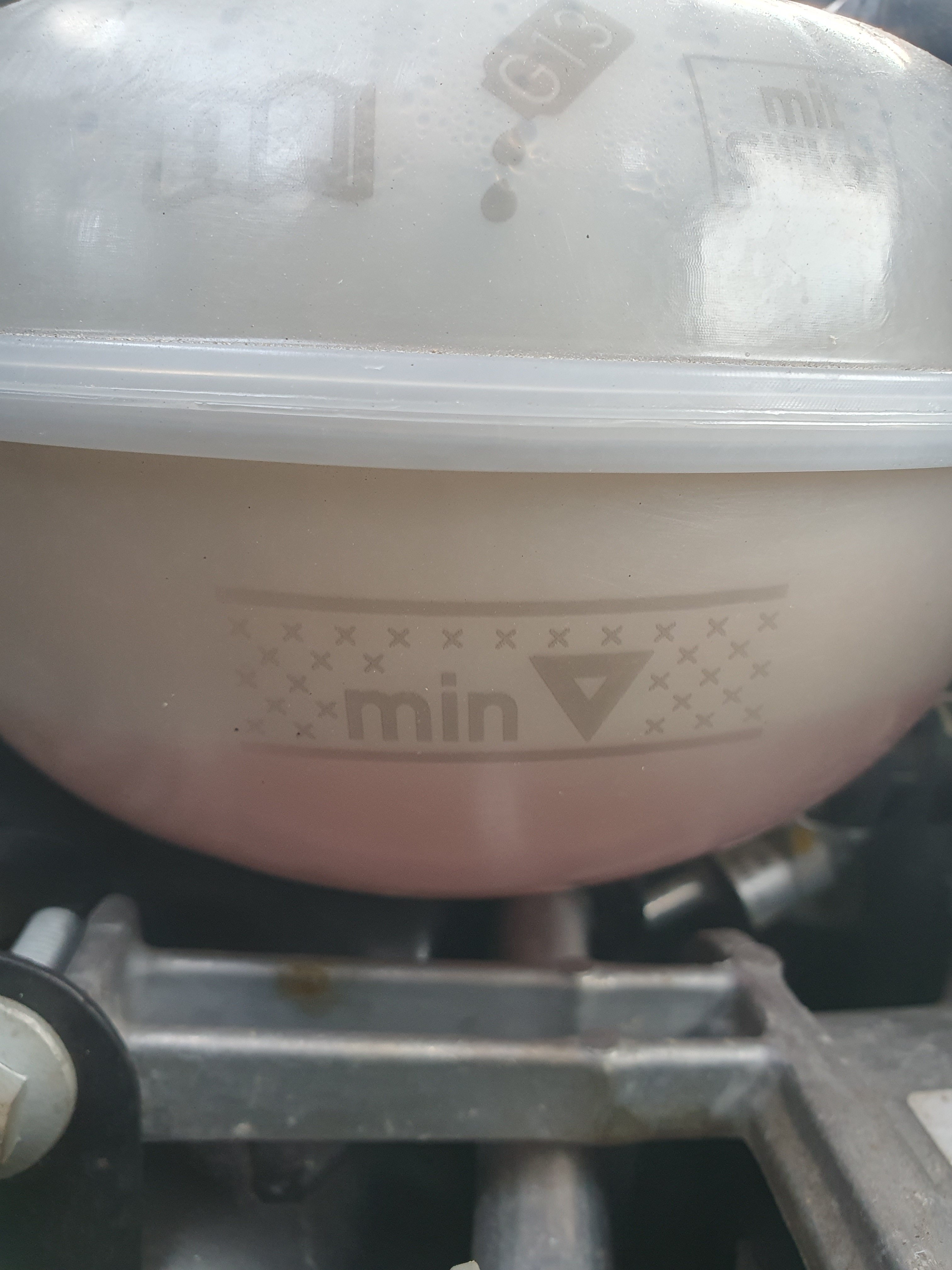

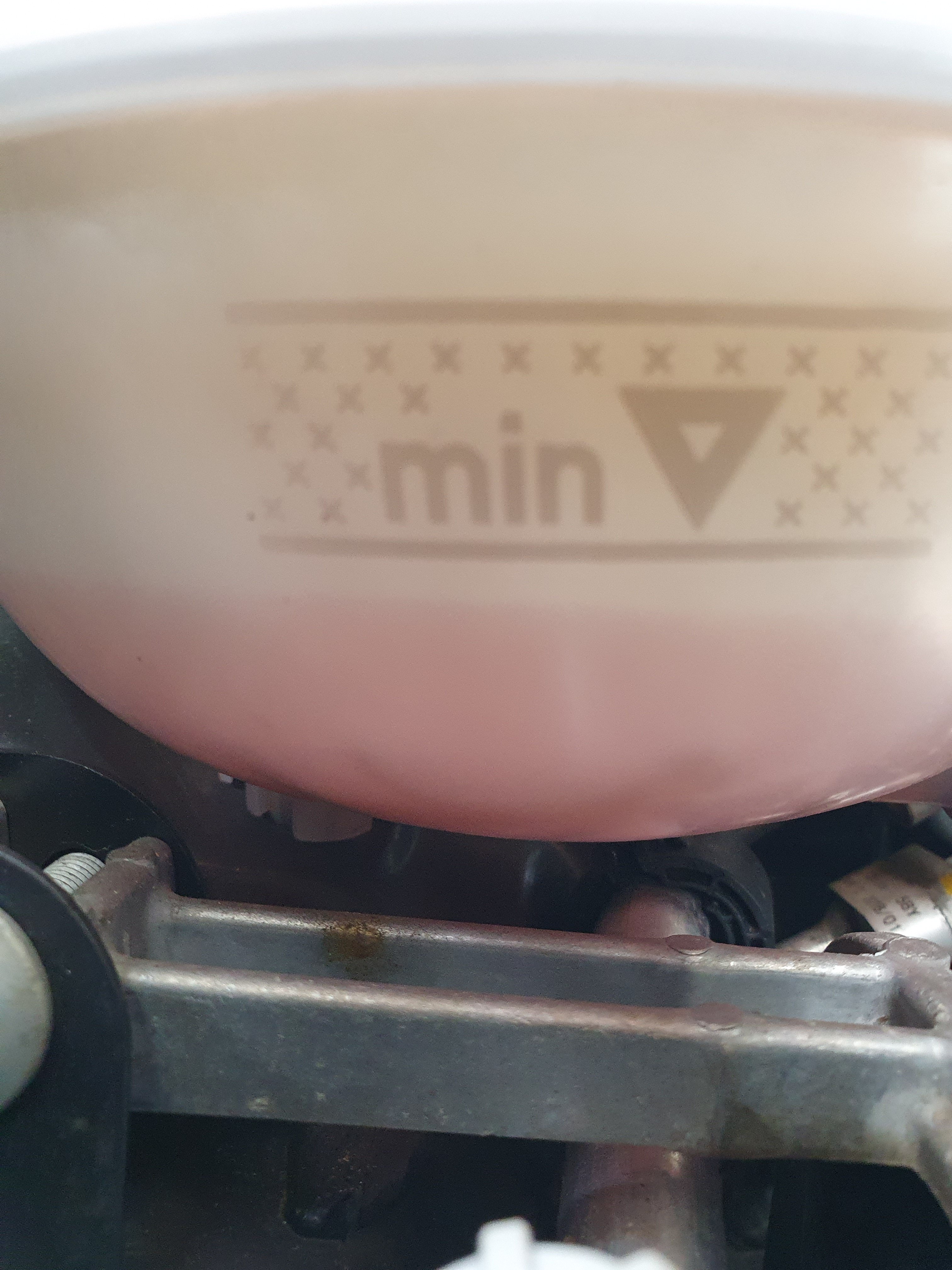

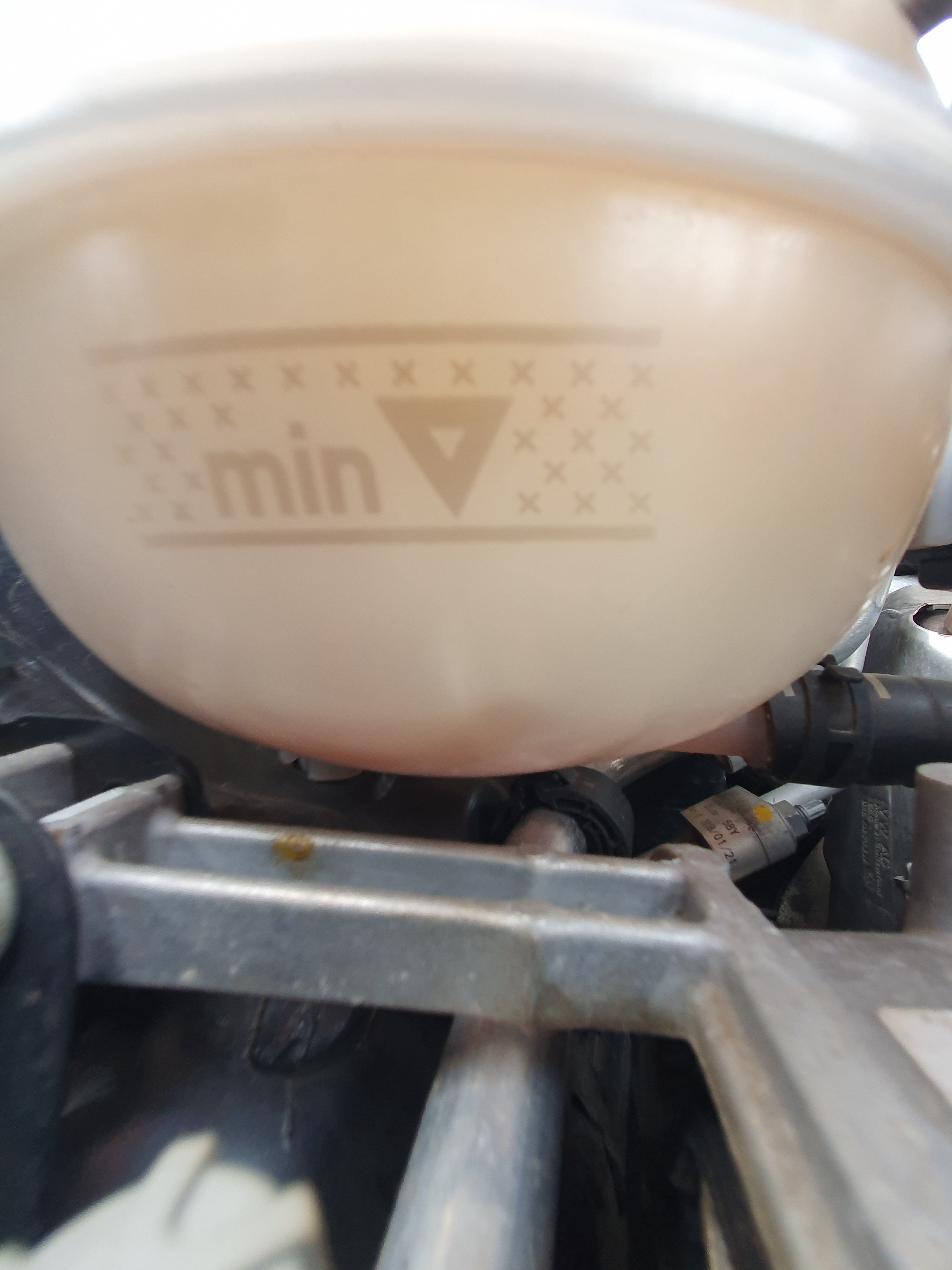

  3. Checked cap and that's fine. Coolant warning light just came on.... I did notice the fan was spinning after I'd turned off the ignition but I assumed this was due to a dpf regeneration. Hopefully dealer will locate the issue this time..
