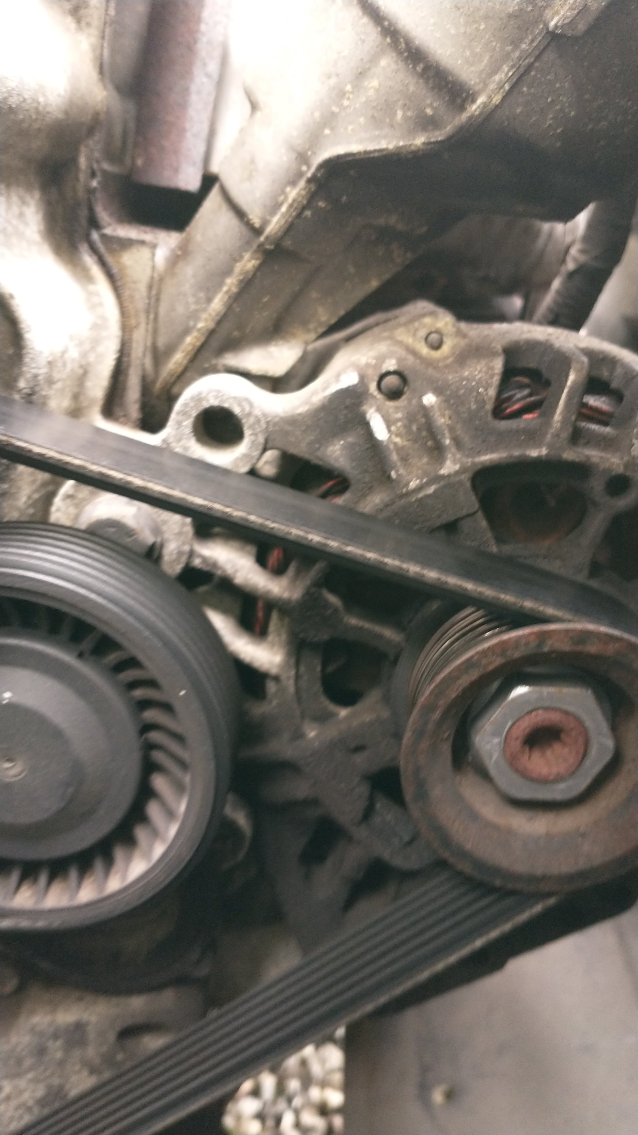

  1. Feedback: Much to my surprise I got the alternator out with too much trouble. (Very pleased with my self, as it was the first time I did anything like that on a car) The drive-belt was a bit tricky as I did not have the prober torx-bit to hold the small pulley thats mounted to spring. I did not have the correct size brushes, but I did have some spare brushes for a makita belt-sander. With a bit of saw-file-work they fitted fine and was easy to solder. 100Km later and the car is running fine(*). - no more battery-symbol-warnings in the dash *"Fine" as in: that specific problem is gone 😉 Thanks for the support. Kind regards Troels

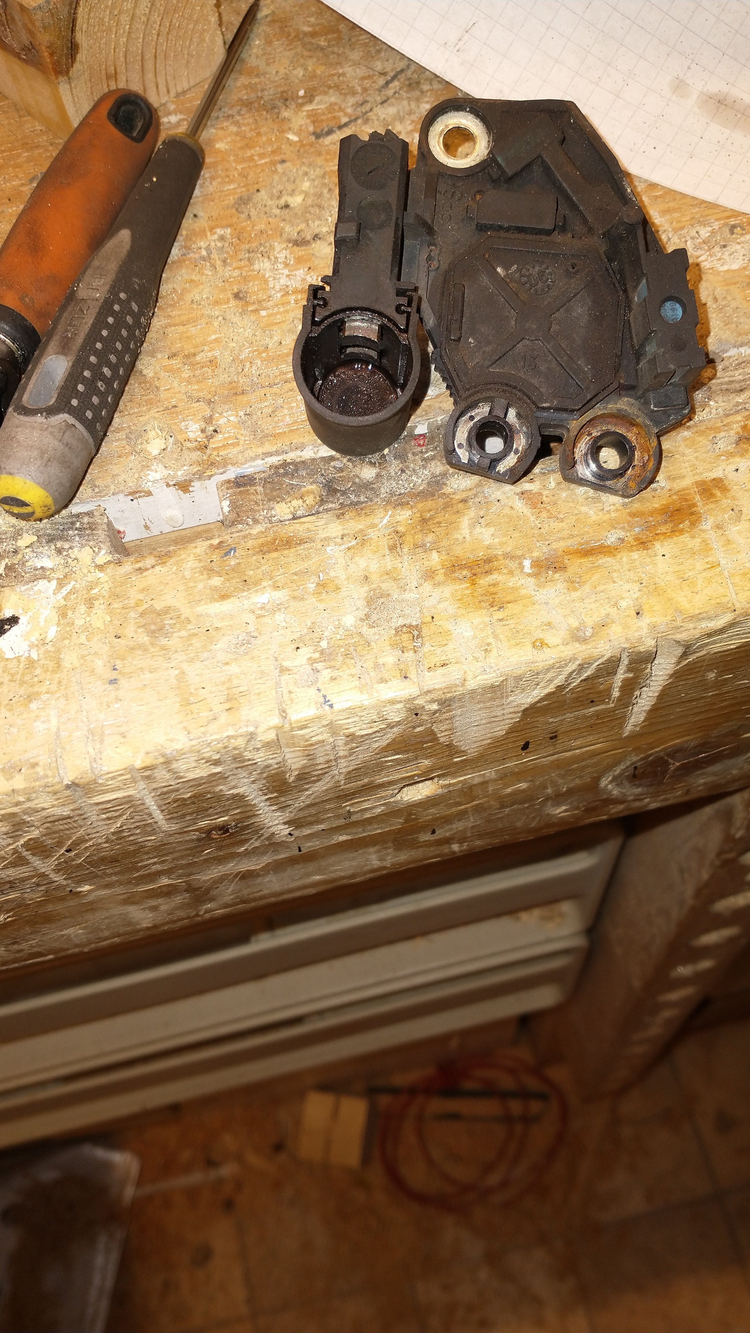

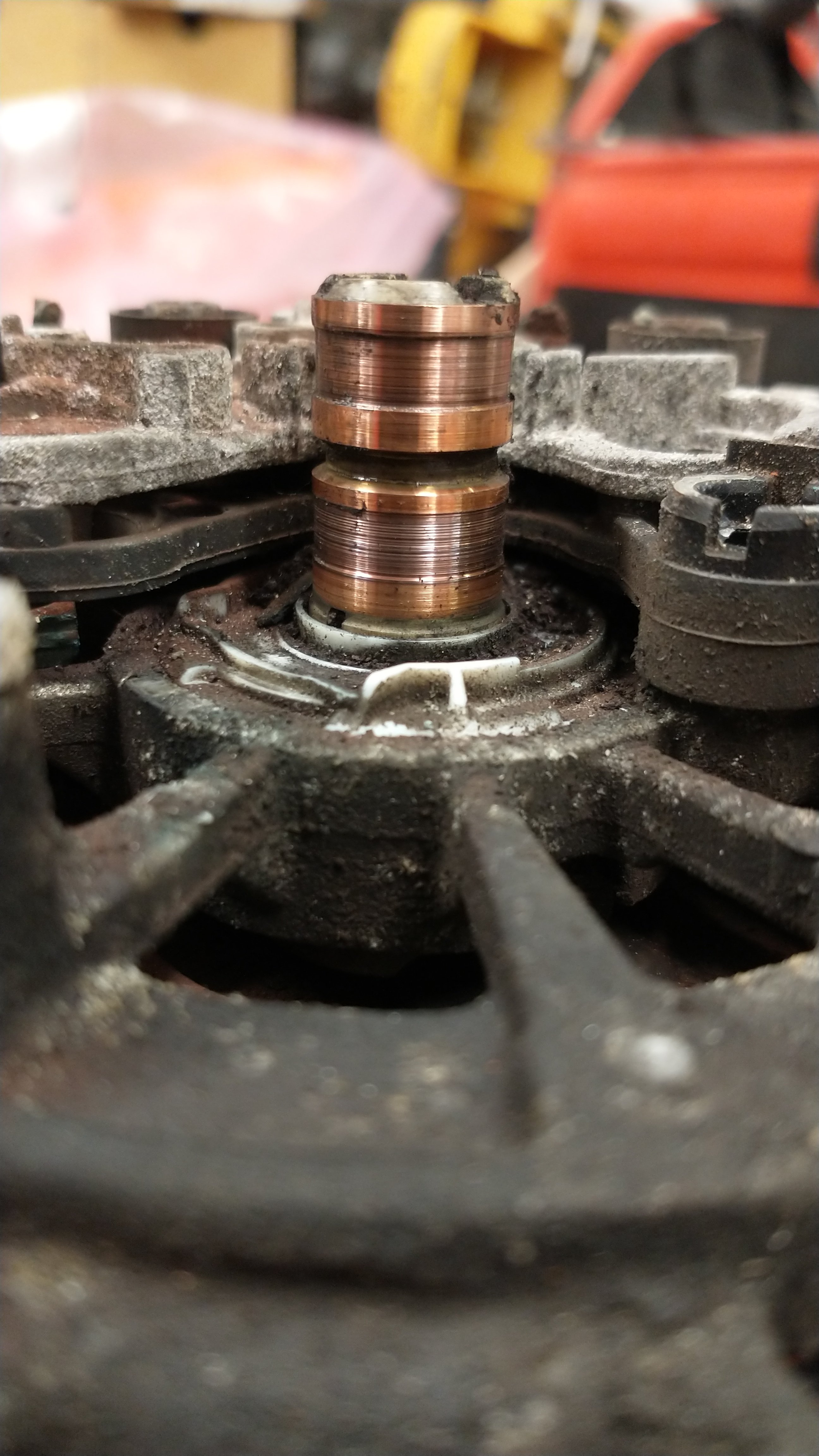

  3. Hi. Spend an hour looking/poking/screwing at the alternator and now its out of the car, - so no way back now 🙂 It looked fine and turns very smoothly so I proceeded to take the the thing apart. A screw holding the plastic cover broke, but I assume its less important. Next I removed a black part and that revealed the brushes (pure luck in my disassembly process)... The top slip-ring was very dark, but a light scrub made it look as shown in the picture. The top brush appears to be more worn than the lower. (maybe hard to see in the pictures Im assuming that the brushes are OK for a little more? Both brushes mowe freely, but I would guess that the top brush has a hard time making prober contact. It dosnt look like its possible to move the brushes, but I might try anyways, - nothing to loose. Please have a look at the pictures and tell me what you think. I Hope the brush-part-thingy is available as a sparepart? Kind regards Troels

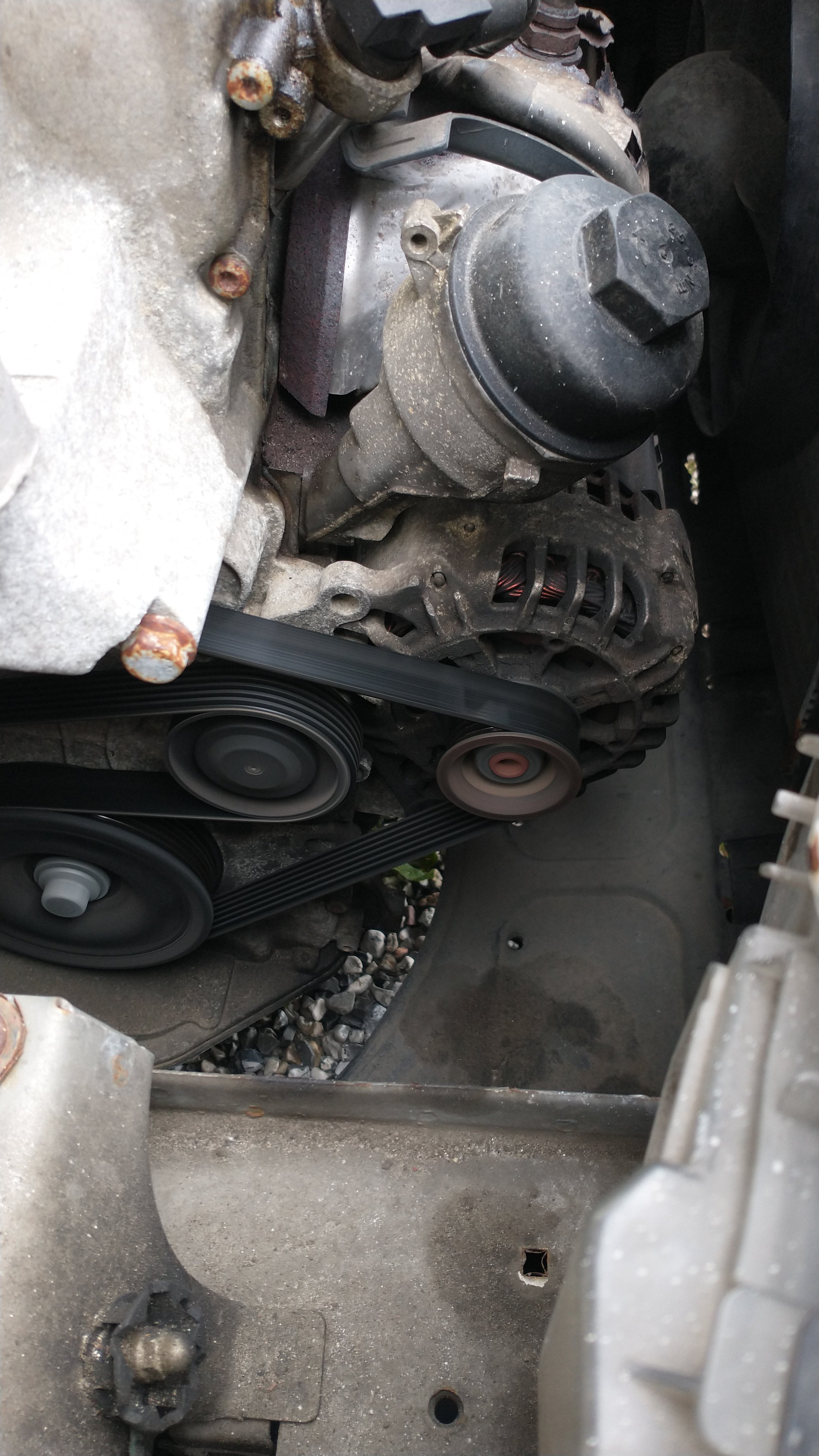

  4. One additional information: Everytime I have had this problem the battery-symbol in the dashboard lights up (red). I will stop the car, leave the engine running and tap the alternator. Cant remember is the battery-symbol goes out immediately after tapping or by next motor-start, - but it does go out. BUT, i have no way of telling whether the symbol comes on as soon as the fault is present or only when the battery-voltage is low, - or something else? Kind regards Troels
