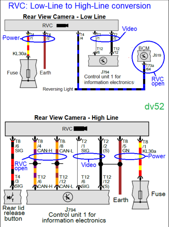

  2. Hey Binx Thanks for the information. But I already ordered a new one from Skoda parts, did order a fish eye for the front pumper or something, have not decided. Does that camera you have, have turn lines?
