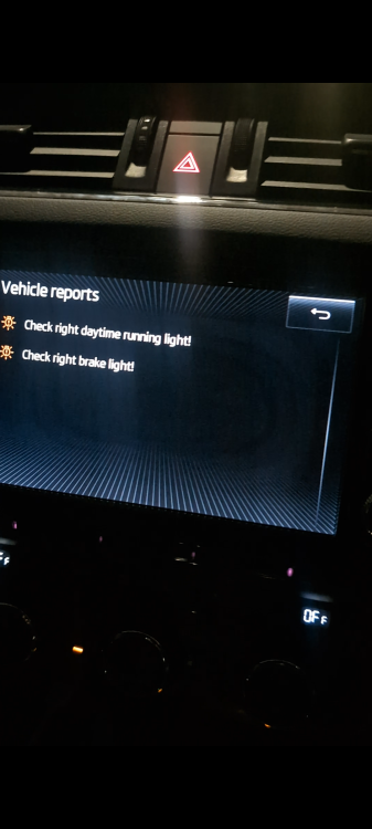

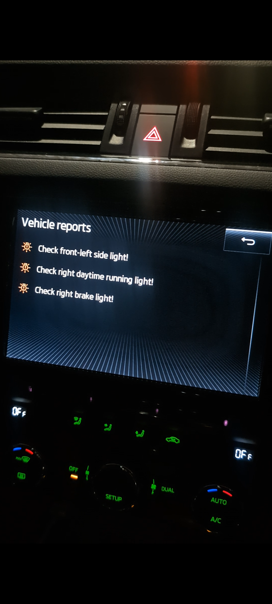

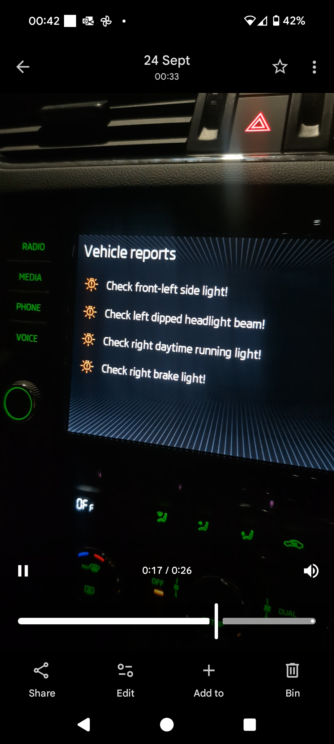

Would anyone be able to support fixing this issue My head lamp left Right hand driving light strip front Right hand rear brake light All not working with error lights still When I flick the light switch dial these errors come up on the screen.

Hi all. I have had my Skoda Octavia 2016 Rs wagon, I have had it recently serviced and brake rotors replaced. Since this I have nothing but issues with error codes and light errors. I have taken it back and they have cleared the codes twice and told me to buy some new globes. What has been done or shorted out in my car to cause such a flip out of error codes and lamps. See attached photos of progressions of errors when car turns on. Right hand front light lamp strip not working Left hand head lamp not working Left hand parker not working Left hand head lamp not working Left hand blinker not working Right rear brake lamp not working I'm unsure what the hell has gone on.

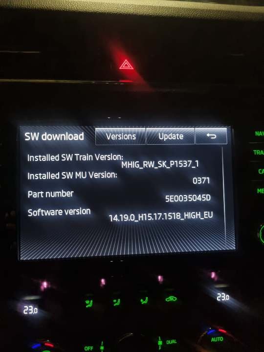

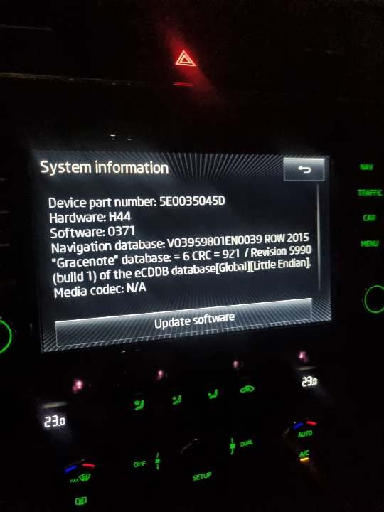

Hi Pabs the unit i have is this 5E0035045D My understanding this unit cannot be updated to android auto car play with software alone , do I have to just replace the in glove box unit ? Is there any plug in devices to bypass or use as a third party by connecting a USB stick and running it through media.

Gday thanks all. Can i patch the existing glove box unit and install Android auto on the system i already have ? Sw train Mhig Part 5e00350450 Hardware h44 Software 0371
