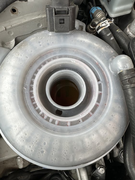

  7. The heater has the exact same temperature on both side of the car . When I checked it cold this evening before the drive home the coolant was just below the minimum mark dove 30mins home and checked and the coolant is way over the max mark , sometimes after a drive it can be low but when I open the cap it comes gushing in . It doesn’t seem to be losing coolant just sometime the underside of expansion tank is damp. As far as I’m aware the mechanic checked the charge cooler. The way the car is now I just couldn’t take it on a long journey. I
  8. I understand the coolant expands , but why would the low coolant warning come on ? When I check it there’s little or no coolant in the tank until I open the cap and it returns and the warning goes off. This has happened while I’m on the motorway and I’ve had to pull over and wait to open the cap. I’ve never had this issue with the car or any car before . This only started a few weeks ago
  9. When coolant builds up the spring in the cap will allow the coolant out the little hole on top and it exits the bottom of tank see photo below. The heater is working fine only difference I see in that is when everything is closed of (fan and vents ) hot air keeps coming out . The coolant is still saying in the system and when I release the cap it comes back in. It was on the low mark this evening then when I got home it was up to normal level then I loosed cap and it came gushing back in , see video. Thanks

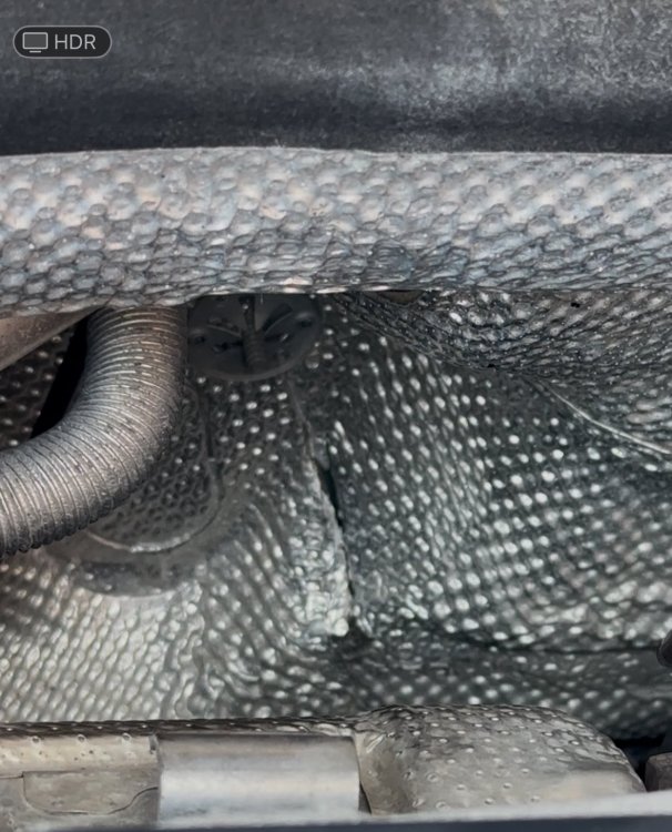

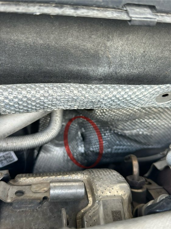

  10. The car is still building pressure When I was with him yesterday to voice my concern about the low coolant in the expansion tank he opened the top and the coolant came flowing back in so much some went out to hole in the bottom of the tank . He told me to keep driving that there was nothing to worry about. He did a test for the head gasket and he said it was fine so there has to be something else causing it. I just can’t be throwing money at the problem hoping something will work. As for the hoses that I think were going into tue firewall I wouldn’t be accusing him of stealing them , maybe he bypassed something or other , see photo of opening in firewall at the location I think they were at.
  11. Hope someone can help , I have a 2015 VRS diesel and it was building pressure and blowing coolant out the expansion tank , took it to a mechanic and he said he replaced the water pump but the coolant is dropping to almost empty until I open the cap and it returns. What puzzles me most is I’m certain that two hoses entered the firewall just to the right of the expansion tank ,one hose directly over the other yet when I picked up my car they are gone all I see now is a slit in the fire wall , when I asked the mechanic what happened them he just laughed it off and said the split in the firewall was for a left hand drive. I’m 100% certain the hoses were there . Can somebody please confirm this and provide a photo if possible. Many thank
