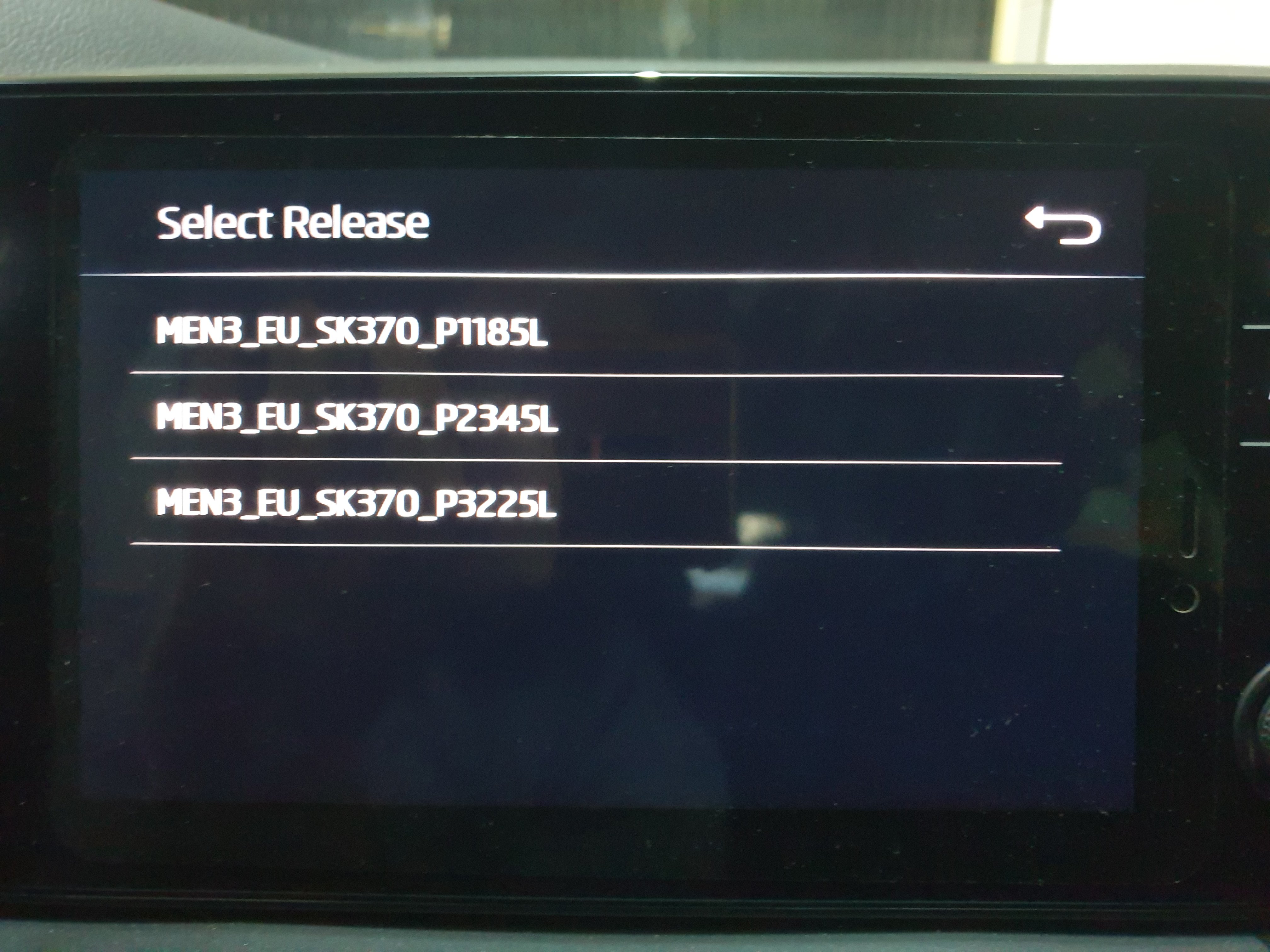

  1. Successful update to 1760 Will trst if android auto still have problems

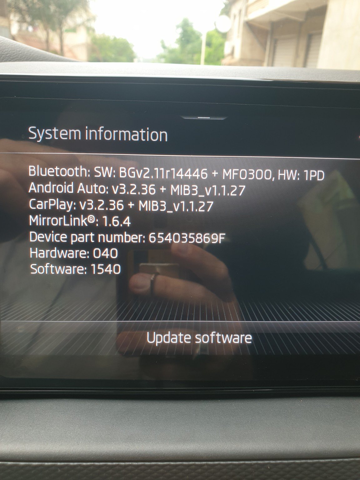

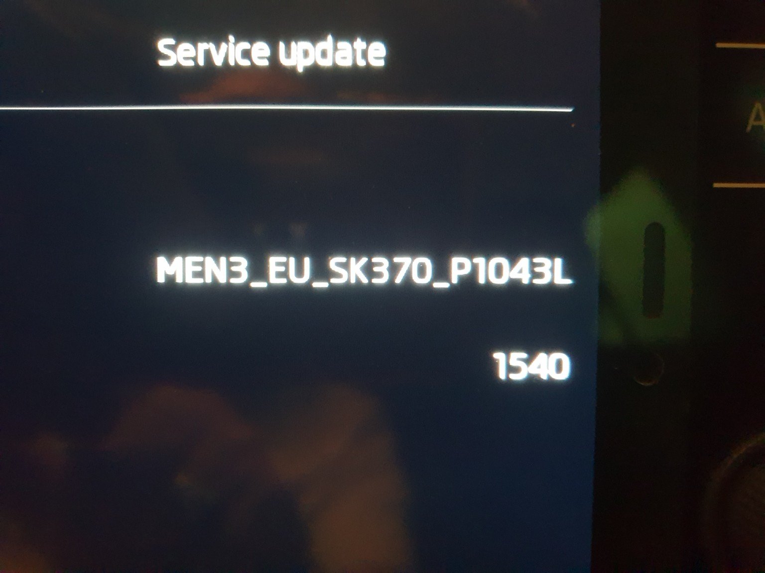

  2. Now worked So im in 1540 What steps i need to follow according to my unite

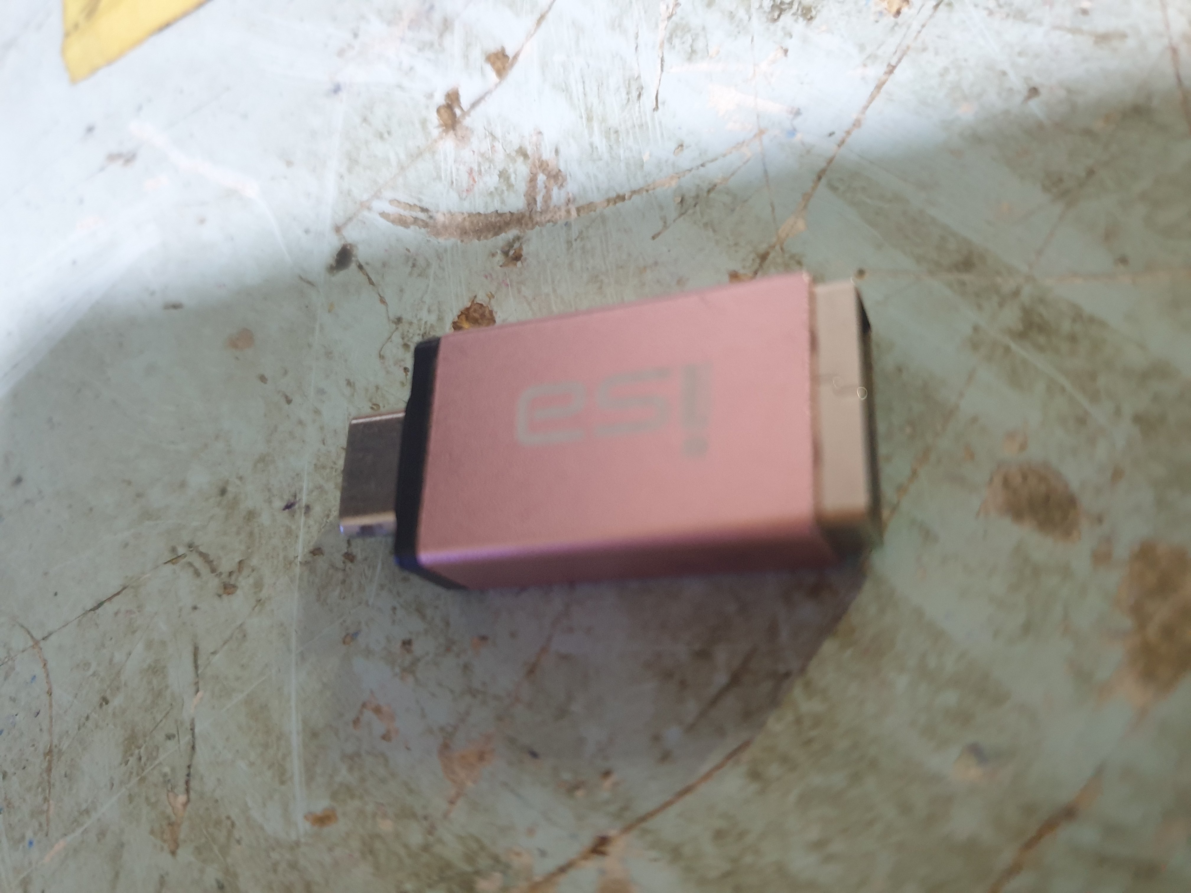

  4. hi bro thx for replay i used a flash drive usb A and an adapter USB-A/USB-C also copied some mp3 files on it and it worked well

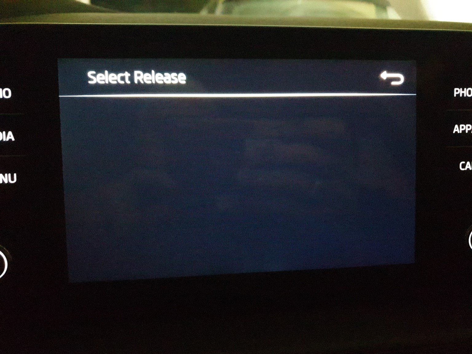

  5. Skoda scala 2021 version 1540 ive used a 4,8,16g flash drive fat32 in usb a / b try version 1800 / 1798 / 1790 /1760 but car did not detect update
