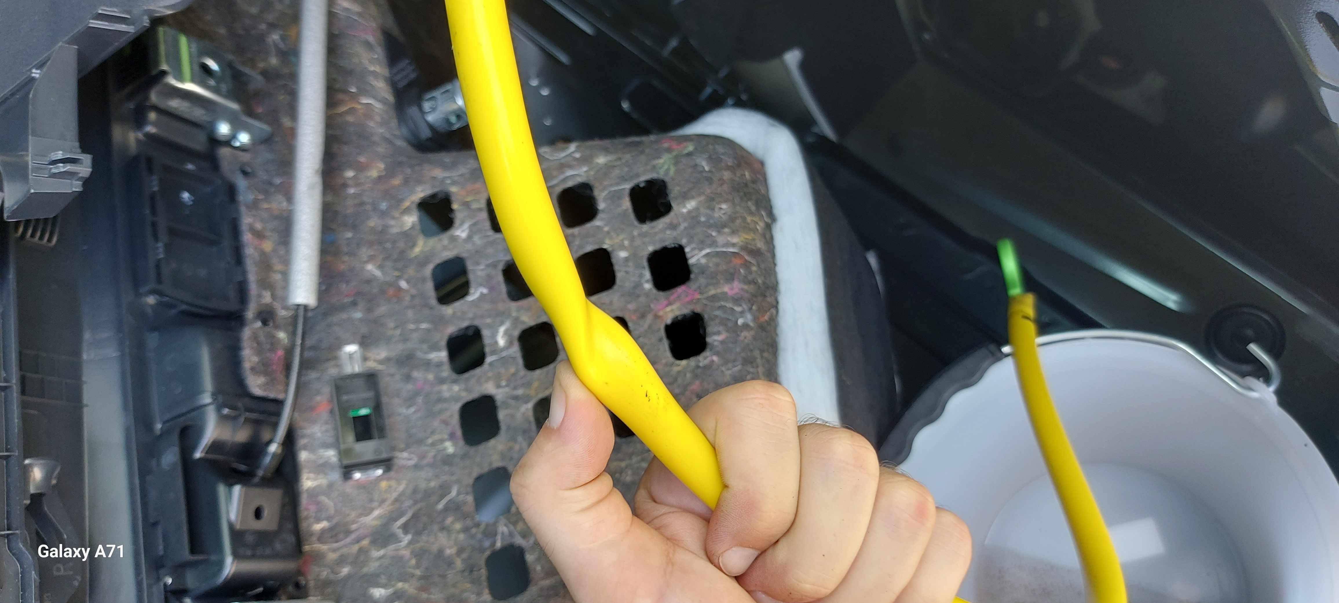

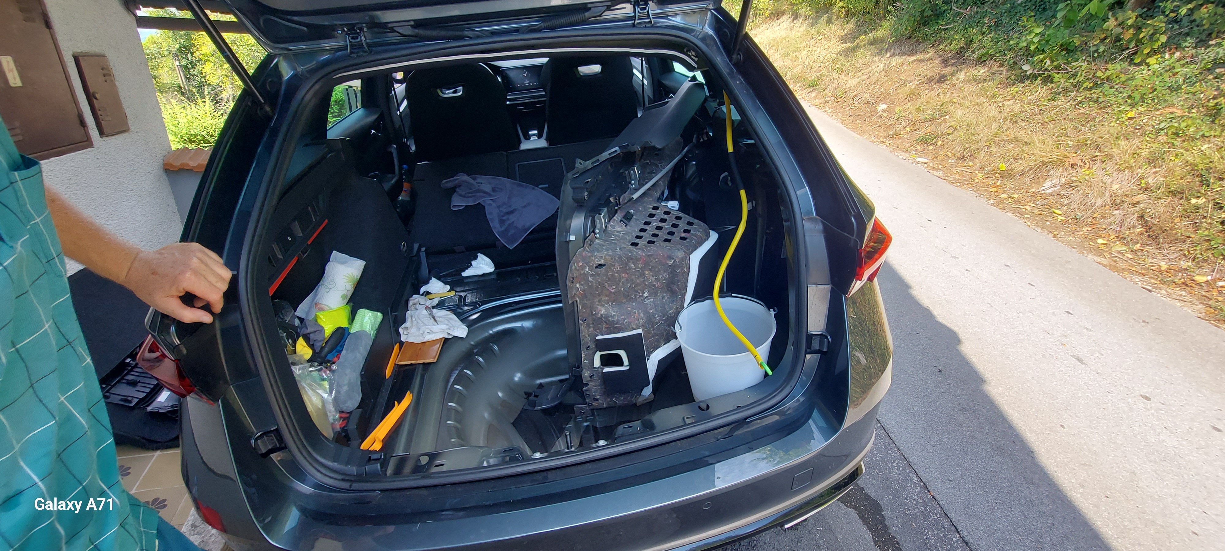

  1. Hello, i fixed rear drain by myself. The problem was in the yellow drain pipe from fabric assembly. I had two turn on passenger side. First turn ok, the second was twisted !!! I shorted the tube to one turn.

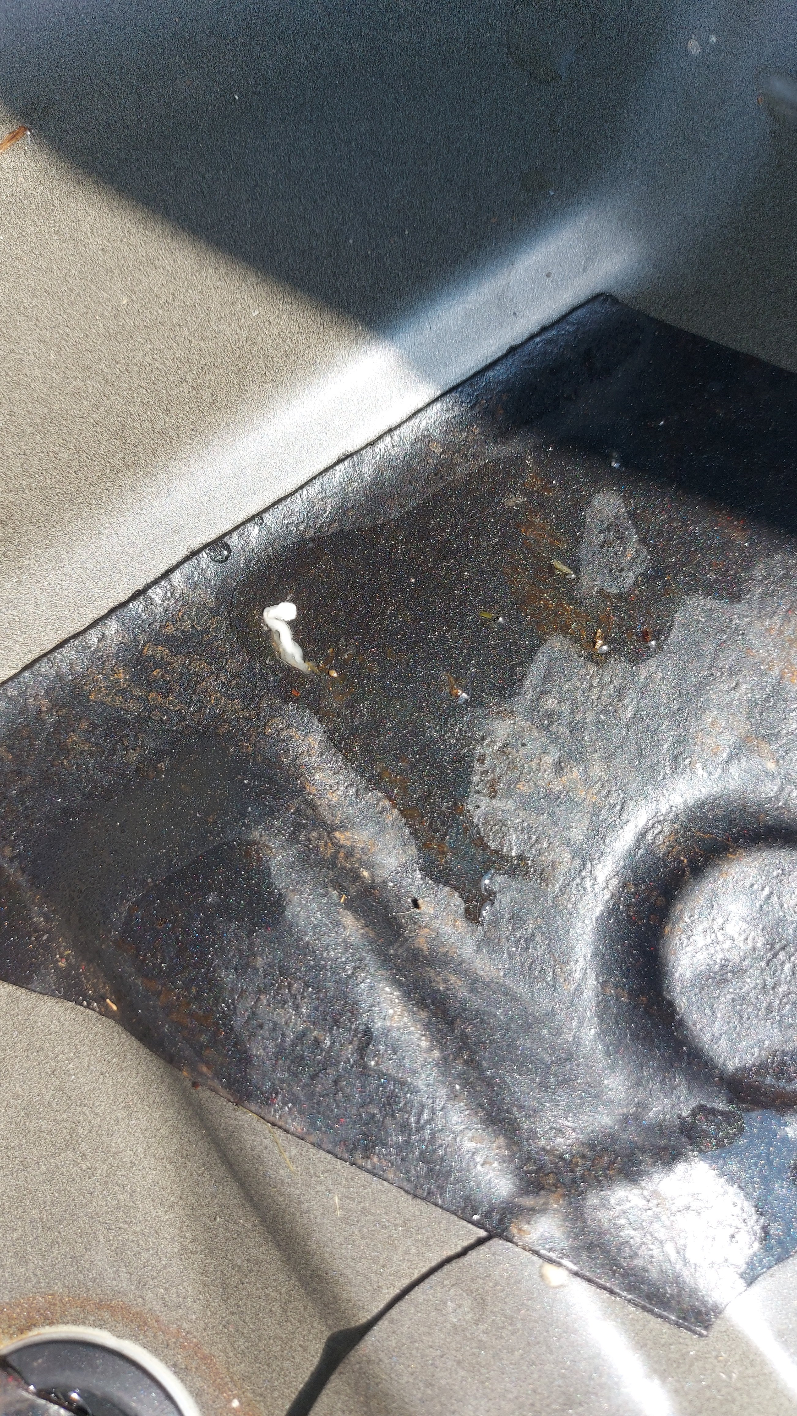

  4. Hello, i have the same problem. Car isn't in warranty and a Skoda diler told me ist cca 300€ repair cost and 4h of work. Can i ask diler to give me a old part?
  5. Ok, foind the front hoses. Where is in the back ? Mayby a need some special tools?
