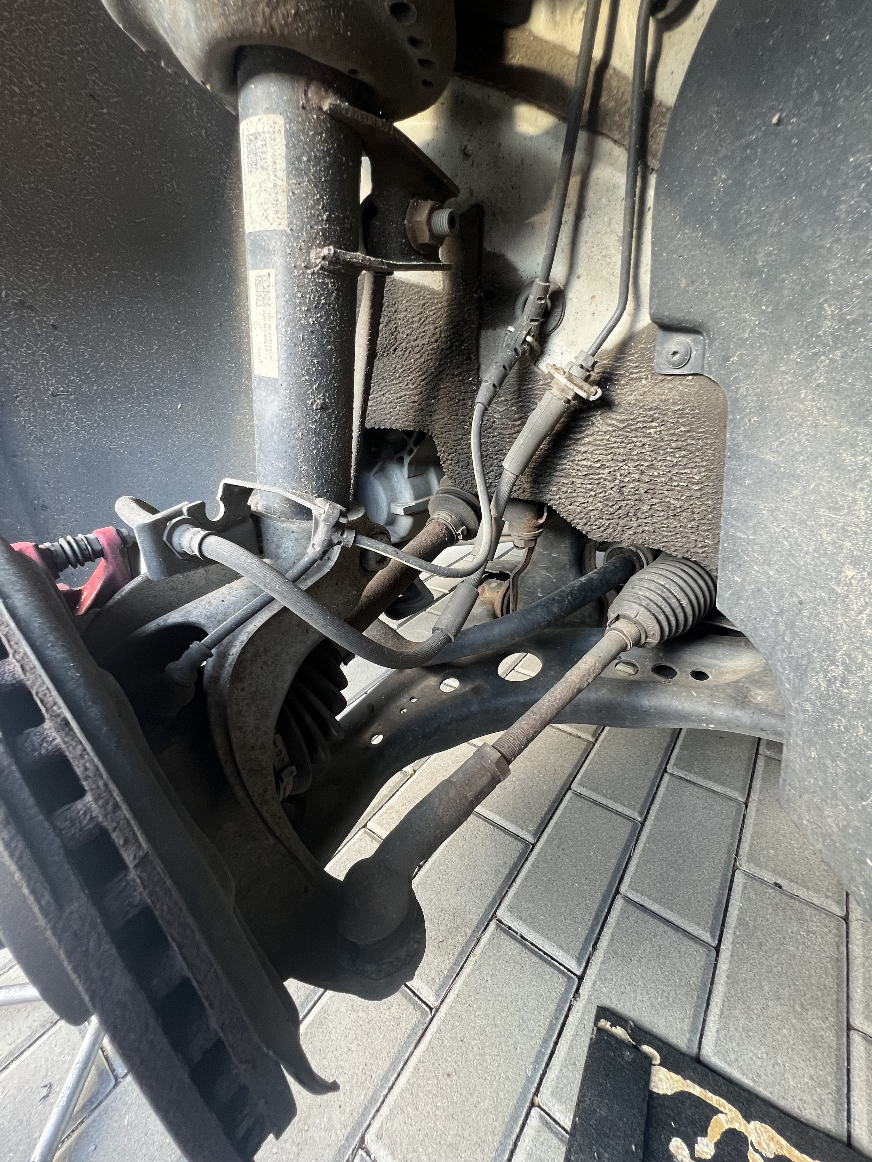

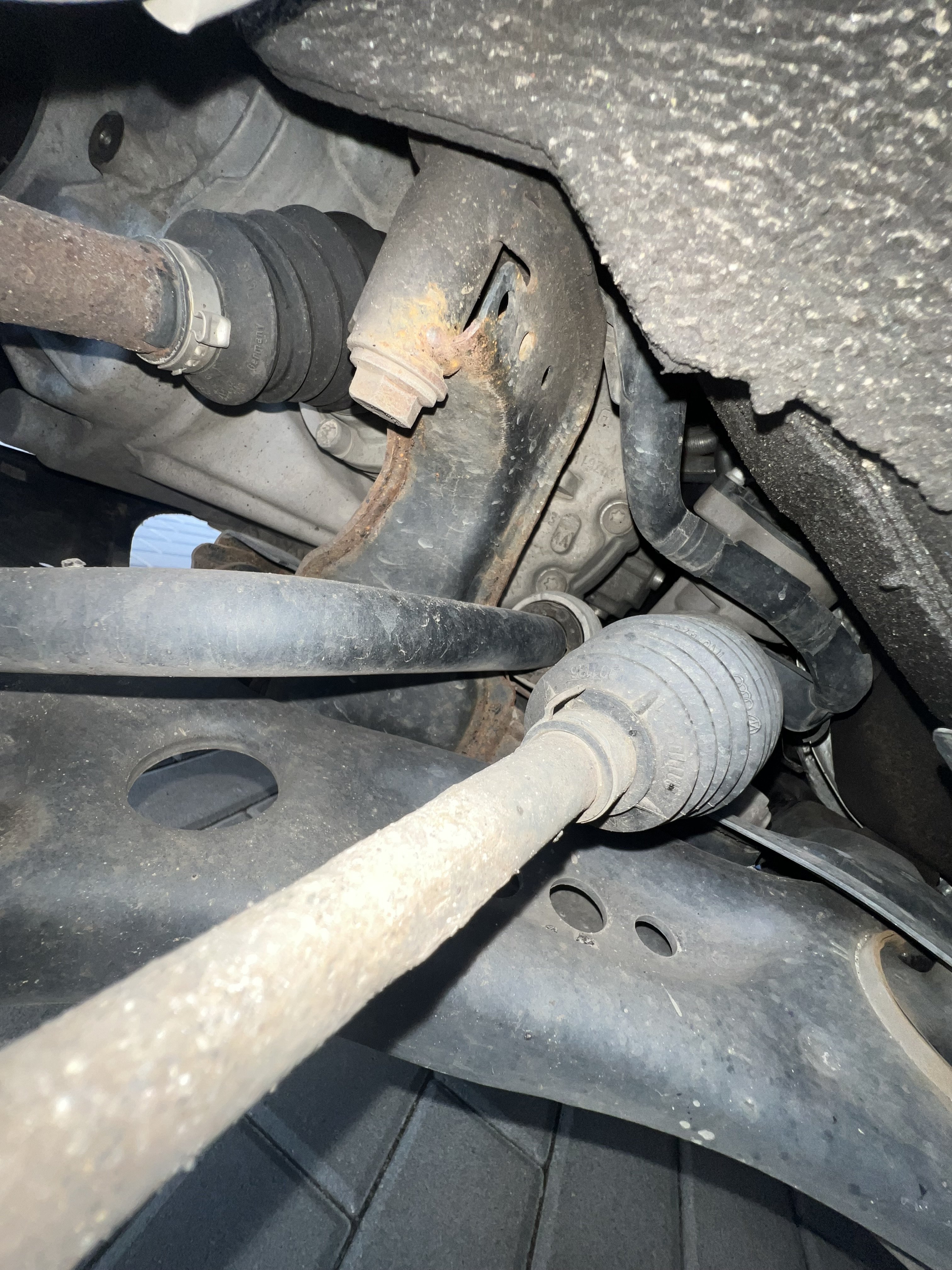

  1. Thanks, i will take a look on it, but i think that the problem could be somewhere else.
  2. My lights are on normal limit. I think that theres really not the sensor on the front side. The problem should be somewhere else.
  3. Where the sensor was located? but it's strange that it doesn't show a sensor error on diagnostics.
  4. I put the left front wheel down and didnt see anything. I attach photo.
