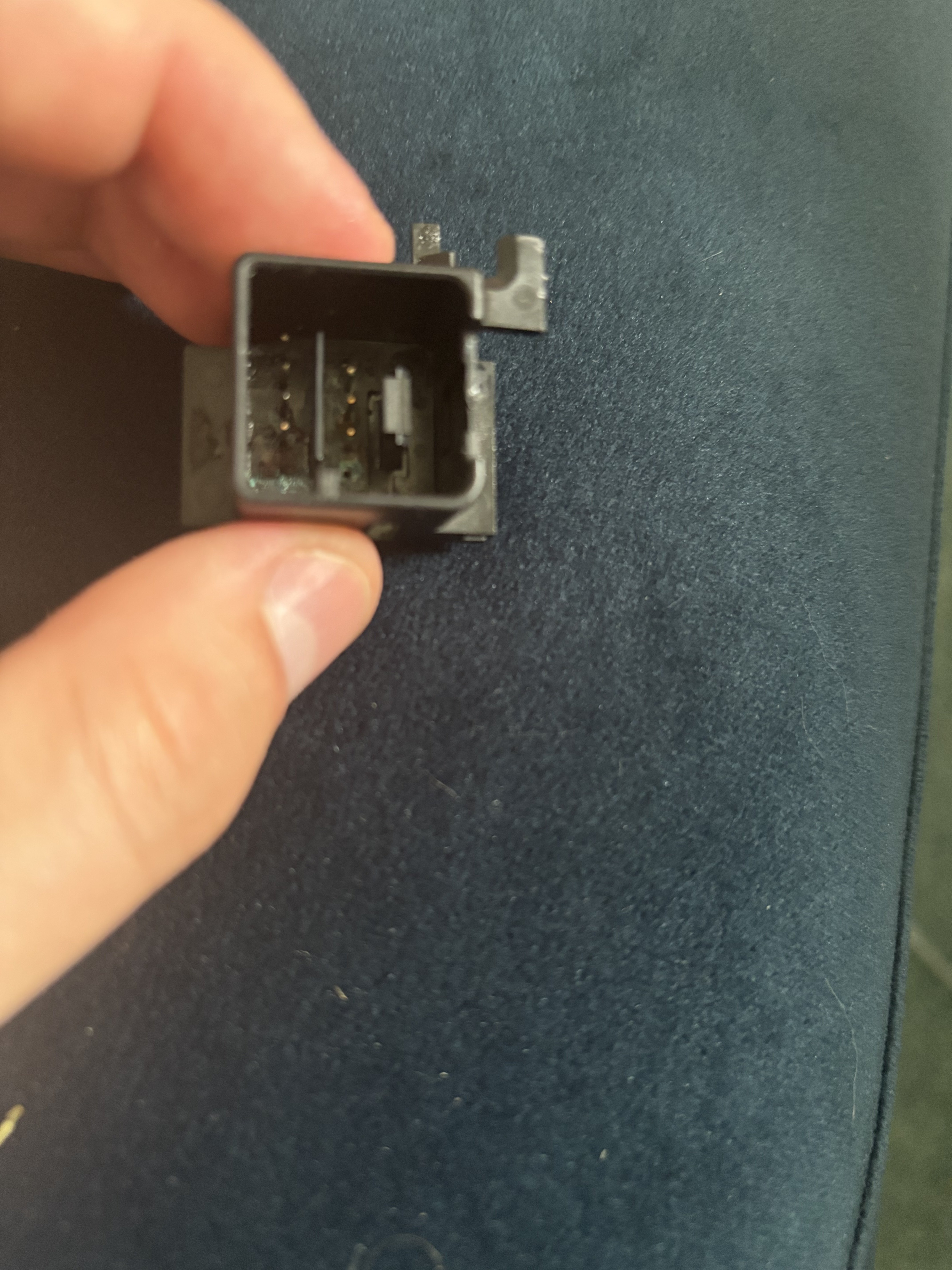

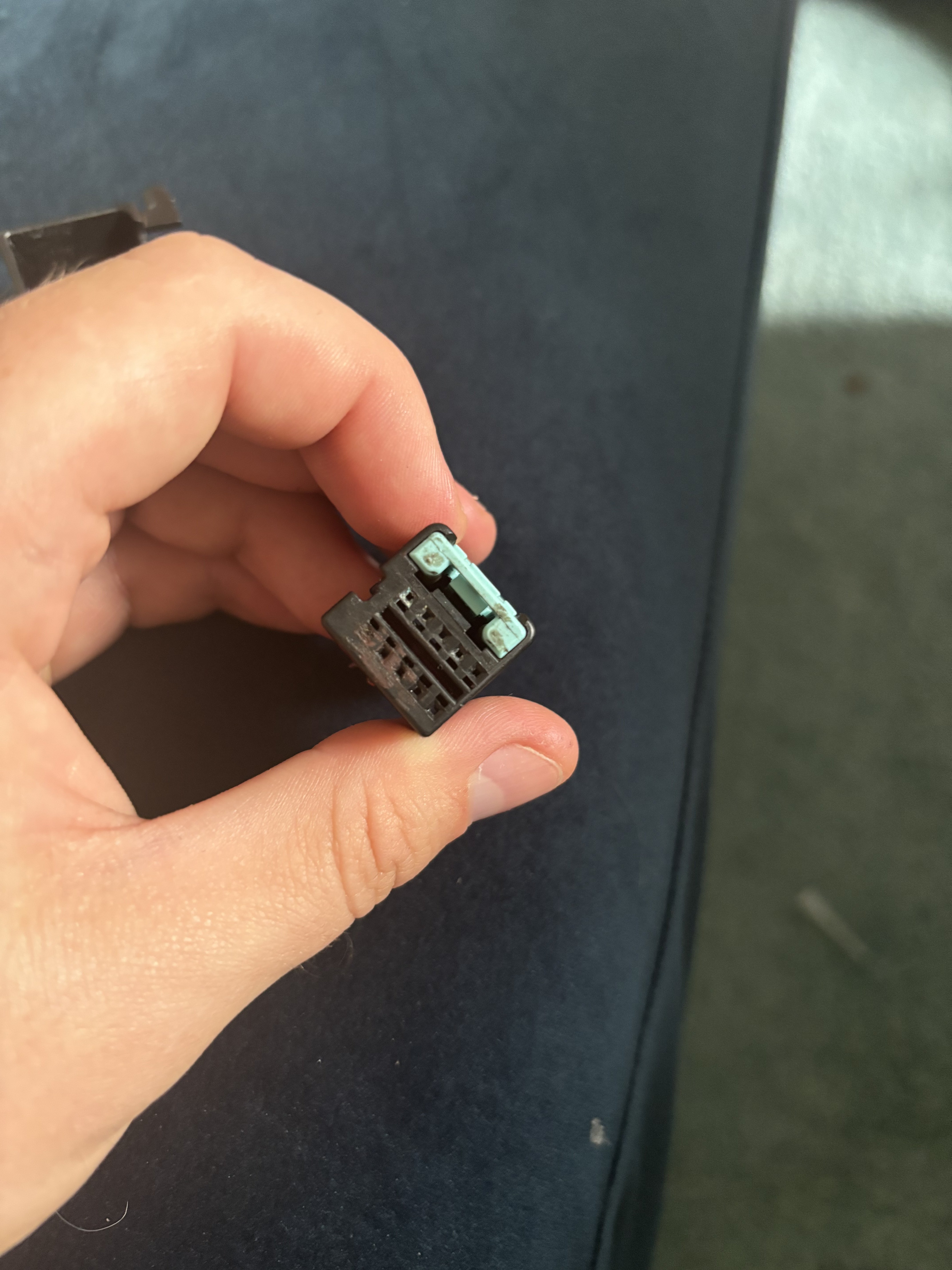

  1. All sorted finally! some pictures for future reference. thanks for all your help!

  3. So after a lot of hard work finding an electrician.. problem has been identified. The obd scan showed a fault in the gear lever. He pulled it apart and one of the connection ports has eroded and there is on 9 pins where there should be a 10. The port was sticy and going green. Likely that a Liquid from a drink has spilled through and corroded the port. Has quoted 500 inc labour for the work which is a lot less than expected.
