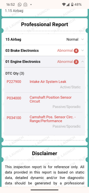

  3. Ok further update.. odb scanner results are in. Here is a link to the report (fancy Chinese scanner makes a report!) . If that doesn't work here is a screen grab of the interesting bit. Does that help with diagnosis at all. I'll be googling shortly.

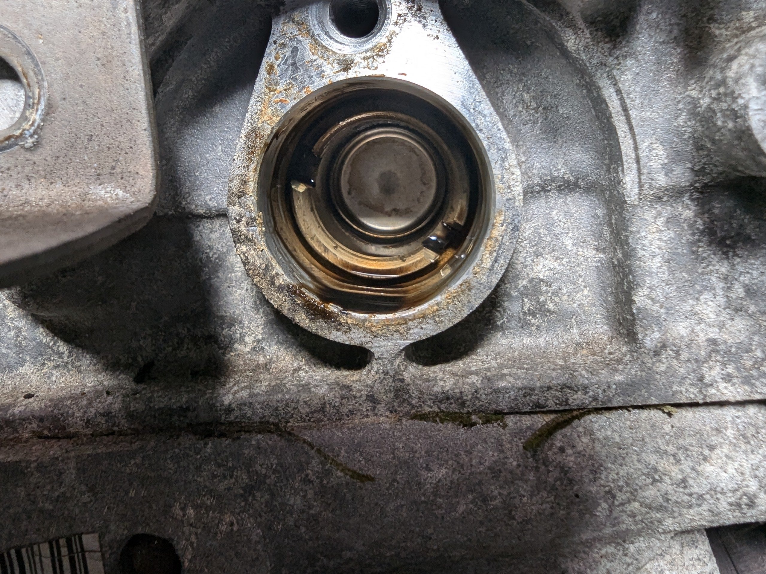

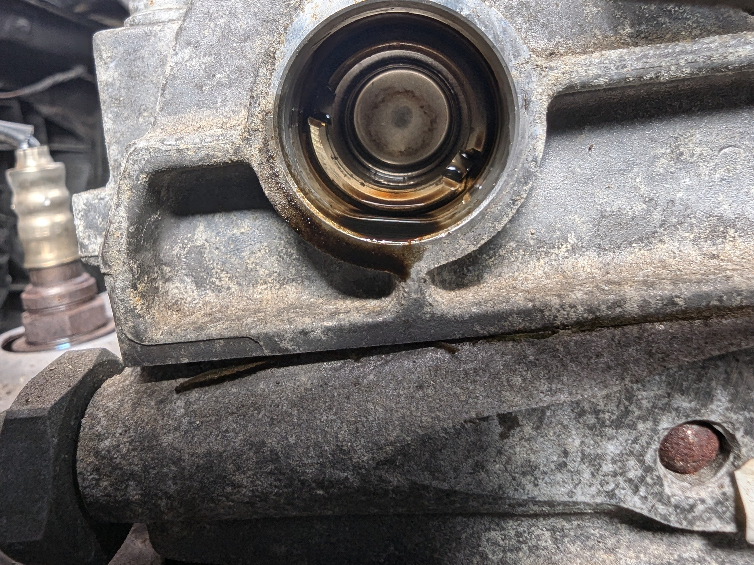

  4. Ok so update here with some pics. They aren't the best as it's a bit tight. Assuming the crescent piece is the end of the cams then they look aligned. I don't have cylinder 1 at TDC though as I don't have think I have the right size bit to turn the crank (still searching). So only can alignment checked. As mentioned I checked the fuses you recommended and they are fine as well. Any other suggestions, could a sensor fault cause this and if so which. As I say OBD scanner otw so maybe that will help... I hope
