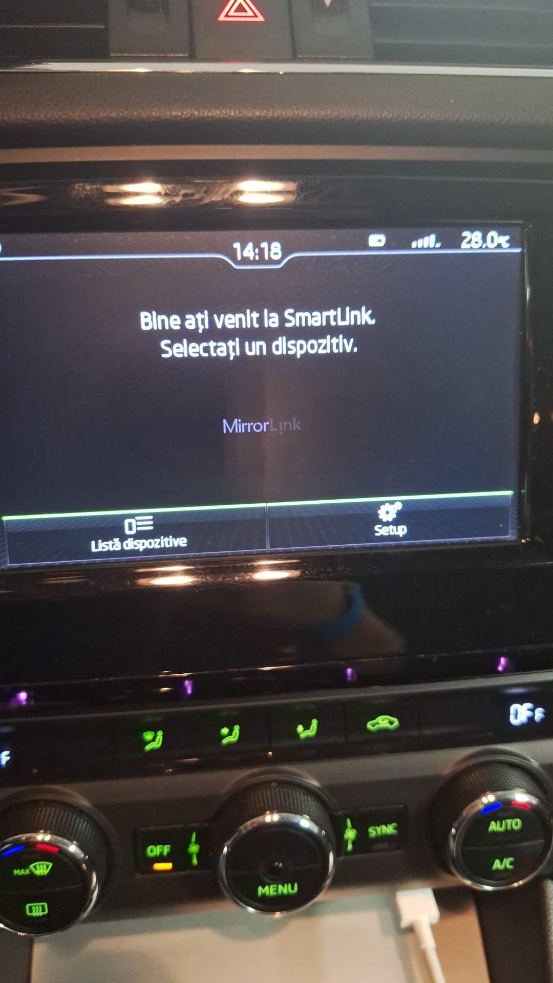

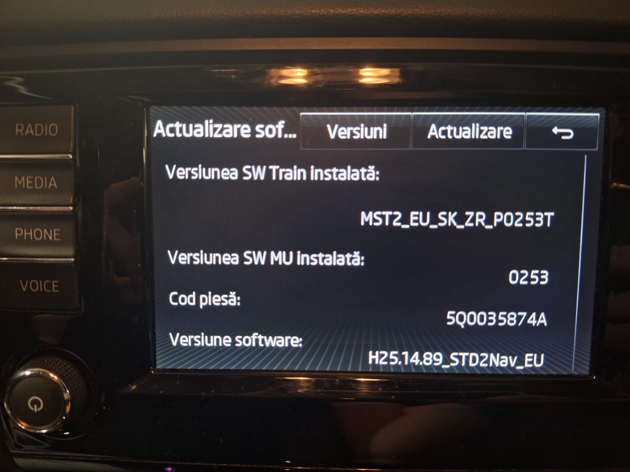

  4. Hello, I activate Smartlink but i cannot connect through Android Auto. I notice that on the Smartlink menu,only Mirror link logo is visible and i think this is the issue. I attached 2 pictures with the Firmware and Smartlink menu. Could you please give me some adviceses what to do next? Thank you, Best regards,
