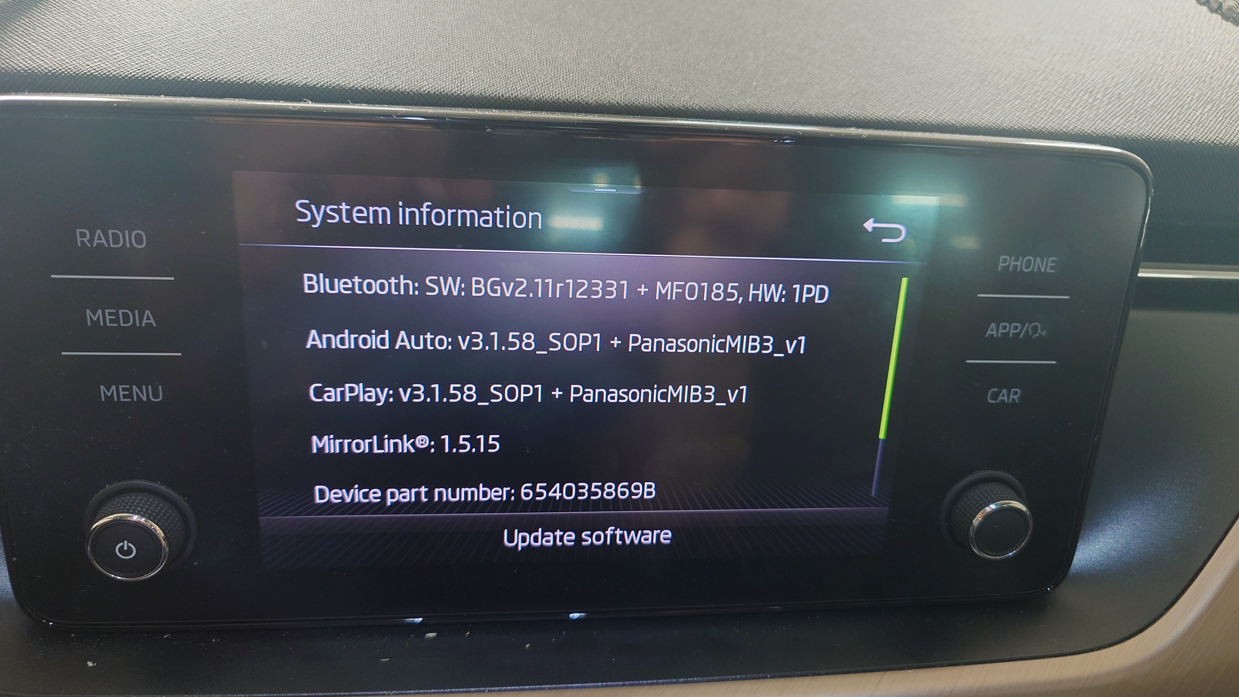

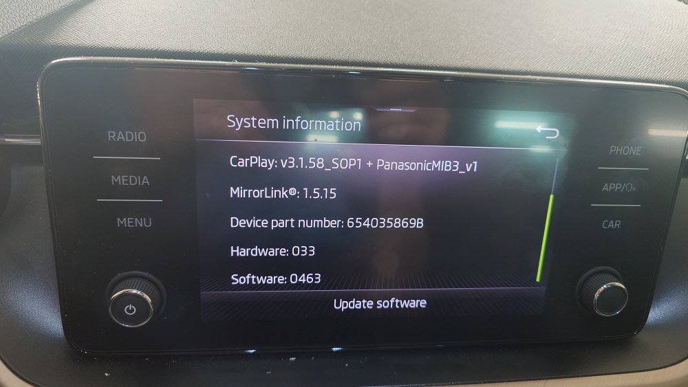

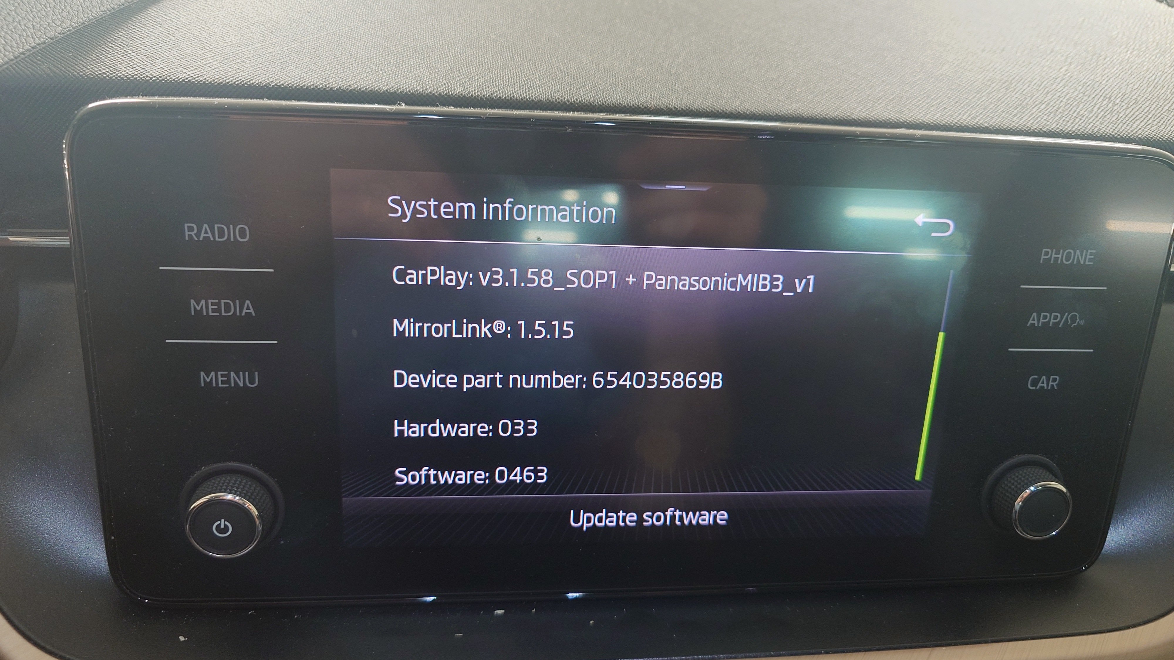

  6. Hi, newcomer is here. I have a couple of questions regarding infotainment system. My car is Scala 2019,vin is TMBEK9NW5K3016195. I believe I have Bolero system. Is there a good source of intro resources to learn about terminology/systems? Thinking of learning to speak the language and understand better what is mib, ocv, and other commonly used abbreviations. My real question is how to run software updates? Should I prepare them on USB? Or could it be done over the air? If I go to updates from the unit itself, it shows none. I am attaching system information screen of my car.
