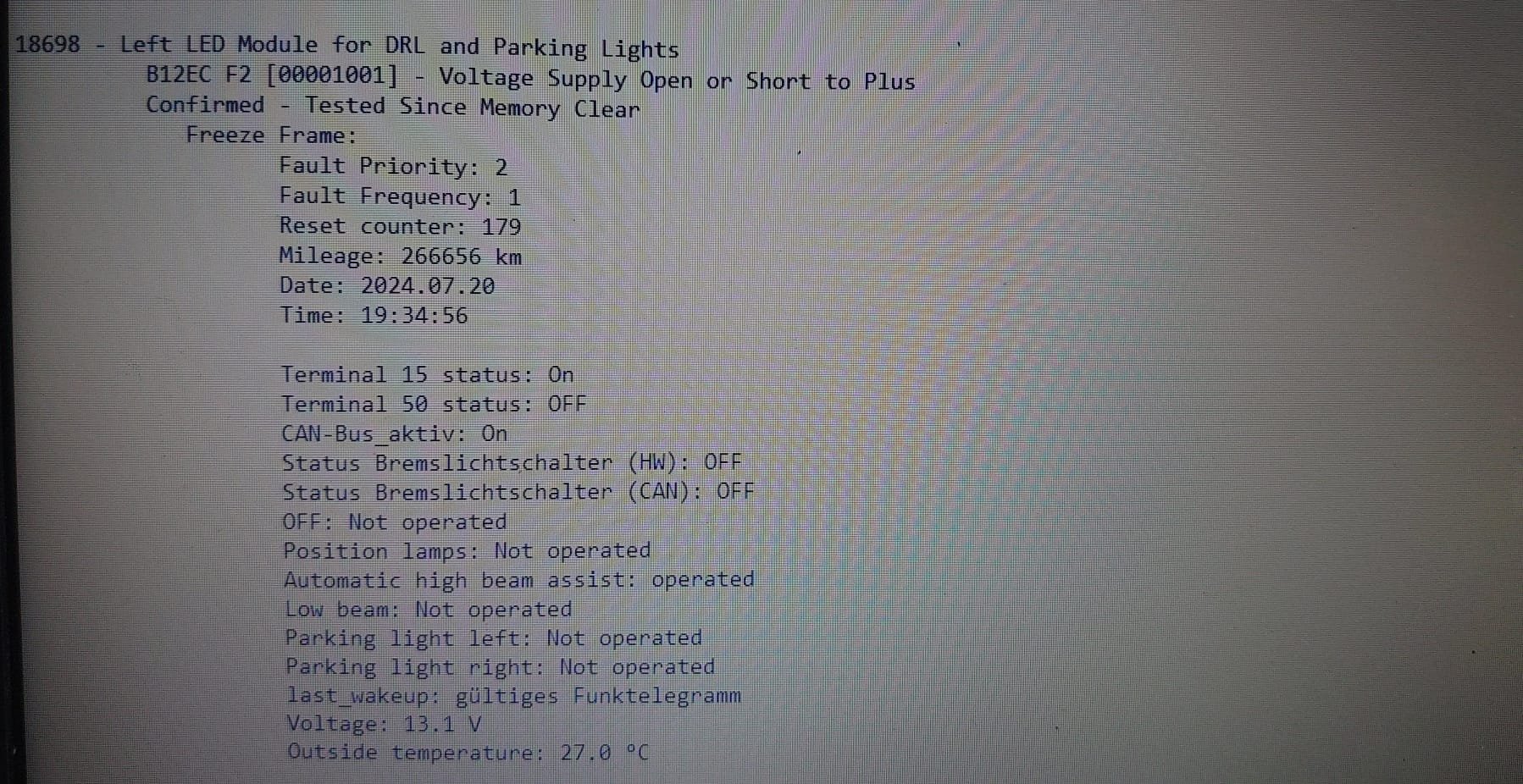

  1. hi all i wanted some help my next neighbour has a Skoda Octavia 2015 mk3, his DRL strips don't seem to work, i disconnected his module for the DRL and cleaned connectors and reconnected it and now the LED strip blinks on startup but it wont stay on. is this something to do with coding? this has never worked for him from when he brought it. i connected this up to VCDS did a scan i got two errors one for the left and one for the right. if someone could help me with coding if that is the case or point me to the right direction that would be great WhatsApp Video 2024-07-21 at 10.22.34_8b75364f.mp4
