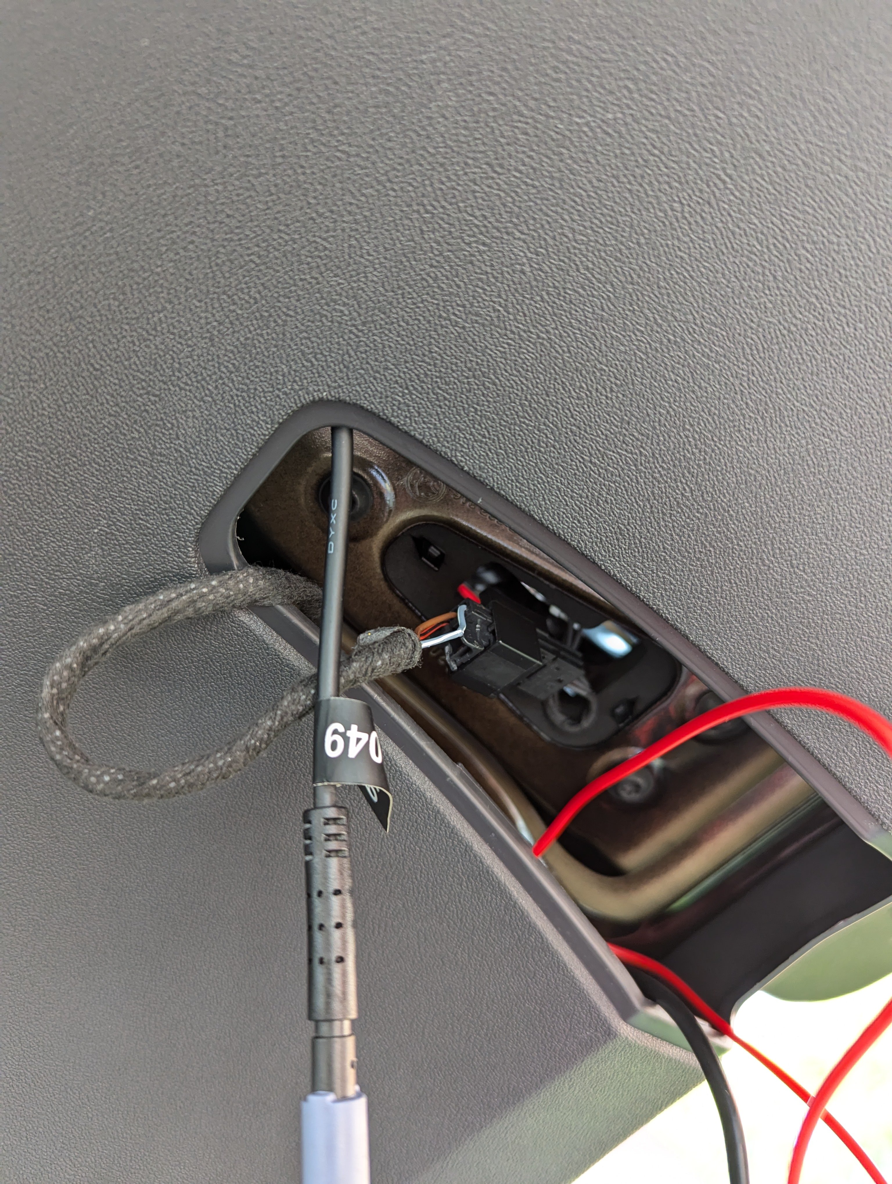

  1. It's the black/red wire for anyone else needing / wanting to know. Thanks 👍
  2. Hi guys and girls, I've fitted an aftermarket reversing camera to my Skoda Enyaq 60 - Wolfbox G840S. The reversing camera works great but it also has the option to wire into existing reversing light live wire to initiate reversing lines on the display (rear view mirror). Hope that makes sense so far. I have exposed the terminal to the rear light cluster (as per photo attached), but I am unable to remove the block to get a voltmeter on it. My question is: does anyone know which wire I need to splice / tap into to get the reversing camera to trigger? The options as per the photo are: red/black, brown, grey/white Any help would be great. Thanks
