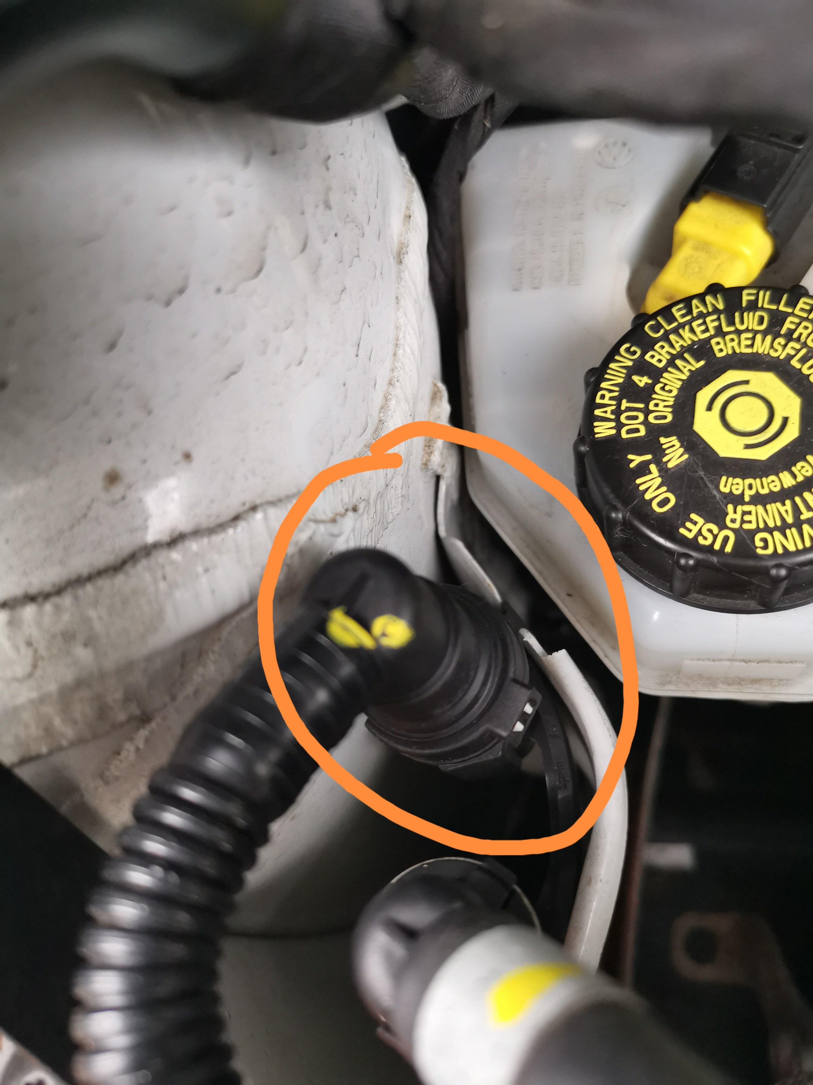

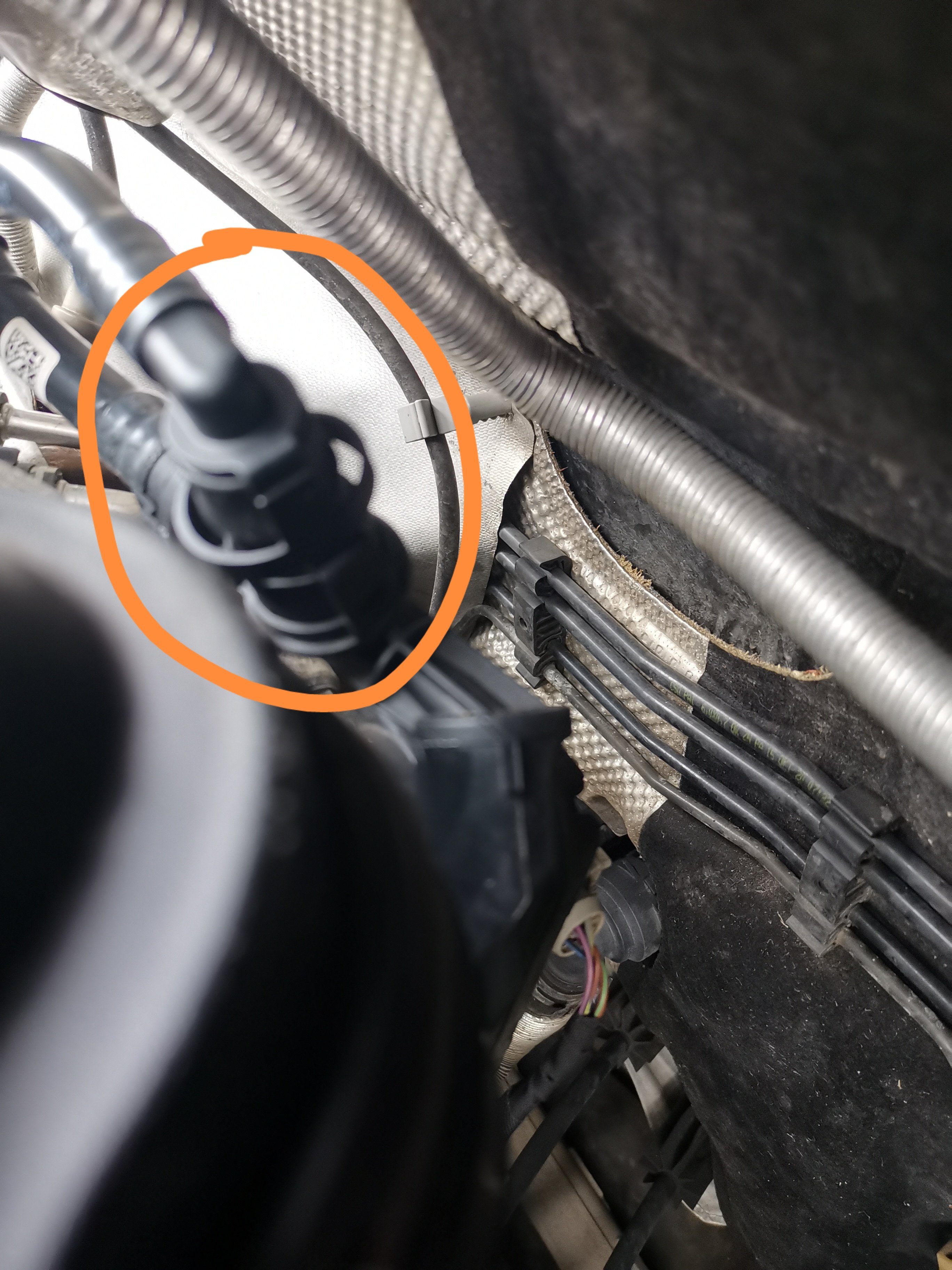

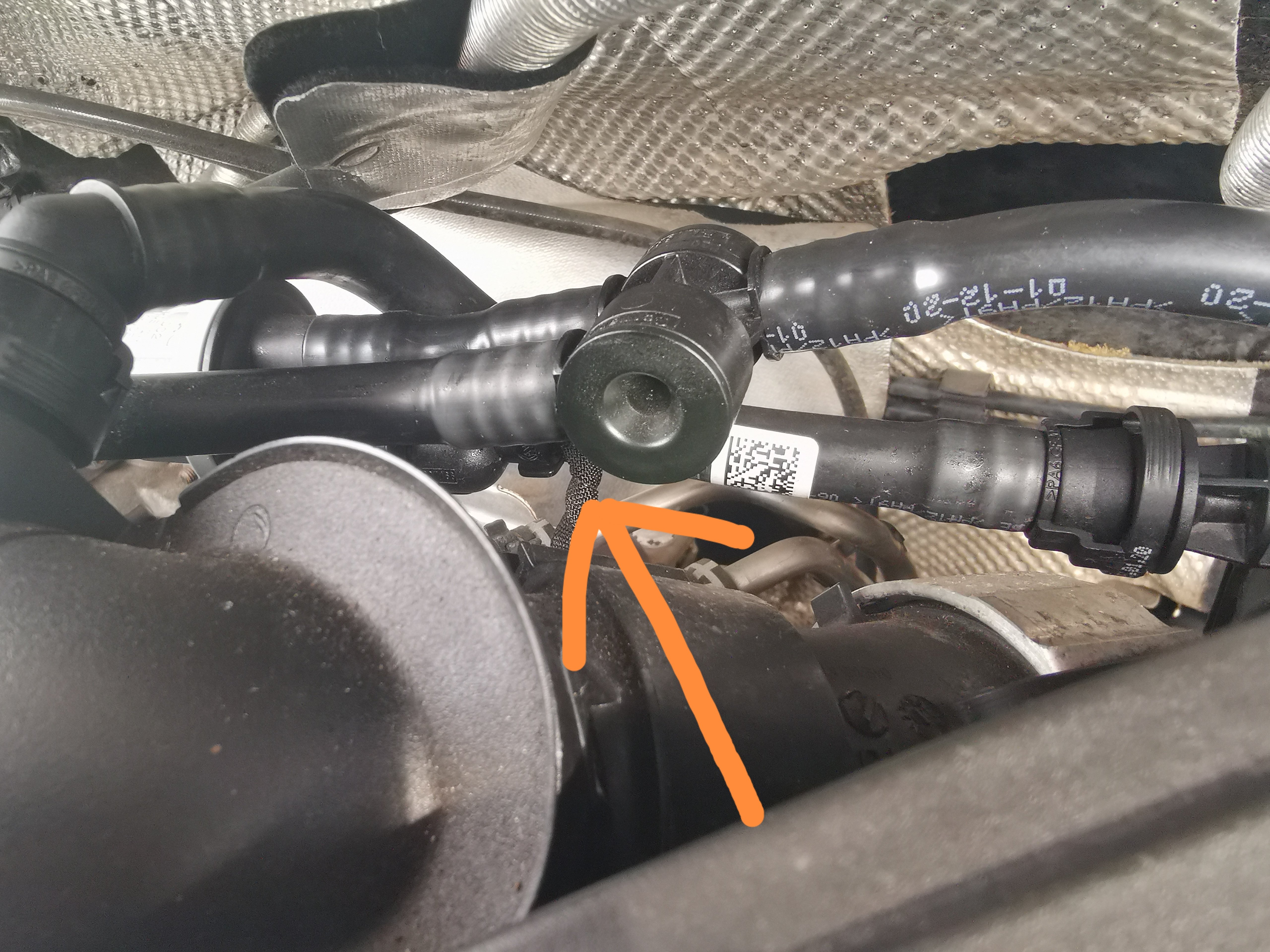

  1. I went our to the car this morning with the intention of trying to take as much of the Akf assembly off. I managed two of the clips but I struggled with three others (in photos)-two hoses and one electrical clip (photo with arrow pointing to clip). So just leaving it to the mechanic. I can't order the part yet as the mechanic that is visiting my home, does not fit any part supplied by clients-so he will have to order. I was also under the driver's rear wheel and seen what I appear to be the charcoal cannister. This seems pretty straightforward to change over as well but I might as well get the mechanic to do this if he's doing the other things as well. I've not been able to source a charcoal cannister but going by what others have paid online, it should be about £90. When I add that, the Akf assembly and about £40-£60 for spark plugs-parts should come to a total of £250-£270. With labour, surely £400 all I would cover it. Maybe an extra £20 if I also add a new fuel cap. My mind goes into problem- solving overdrive when work needs done to my car. Hats off to all the mechanics and car enthusiasts out there-as its hard to switch off from it. 😁
  2. Although, looking at the the Akf valve and the connecting tubes, it looks like just three tubes to connect. Maybe if I take enough photos beforehand I could just swap like for like. Then take the back wheel off and change the charcoal cannister after taking off the trim, the bolt and two clips. Ahh, I can't make up my mind, there's a part of me that wants it done as soon as possible rather than wait until next Thursday for the mechanic to look at it. I reckon if I were to change both these parts, that would probably solbe my problem.

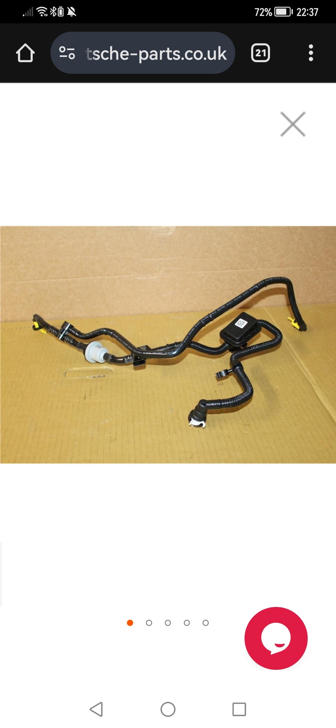

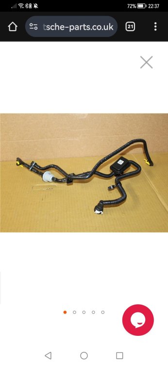

  4. Wow, that's quite a difference from the £20 parts I've seen for other purge valves on other models. Taking this into consideration, I think it's unwise of me to try and change this myself. If I get a mechanic to change this over, I could get them to change the spark plugs at the same time-I should have done this when I done the other service jobs but this seemed more difficult. Thanks for taking the time to research mate.

  6. I took these photos of the part you are referring to, as I thought it could be it. I will check more thoroughly when I've got time to go to the car. I dint think the one I've got is that great. I suppose it could be this as well.
  7. I don't suppose anyone knows if this is the purge valve?

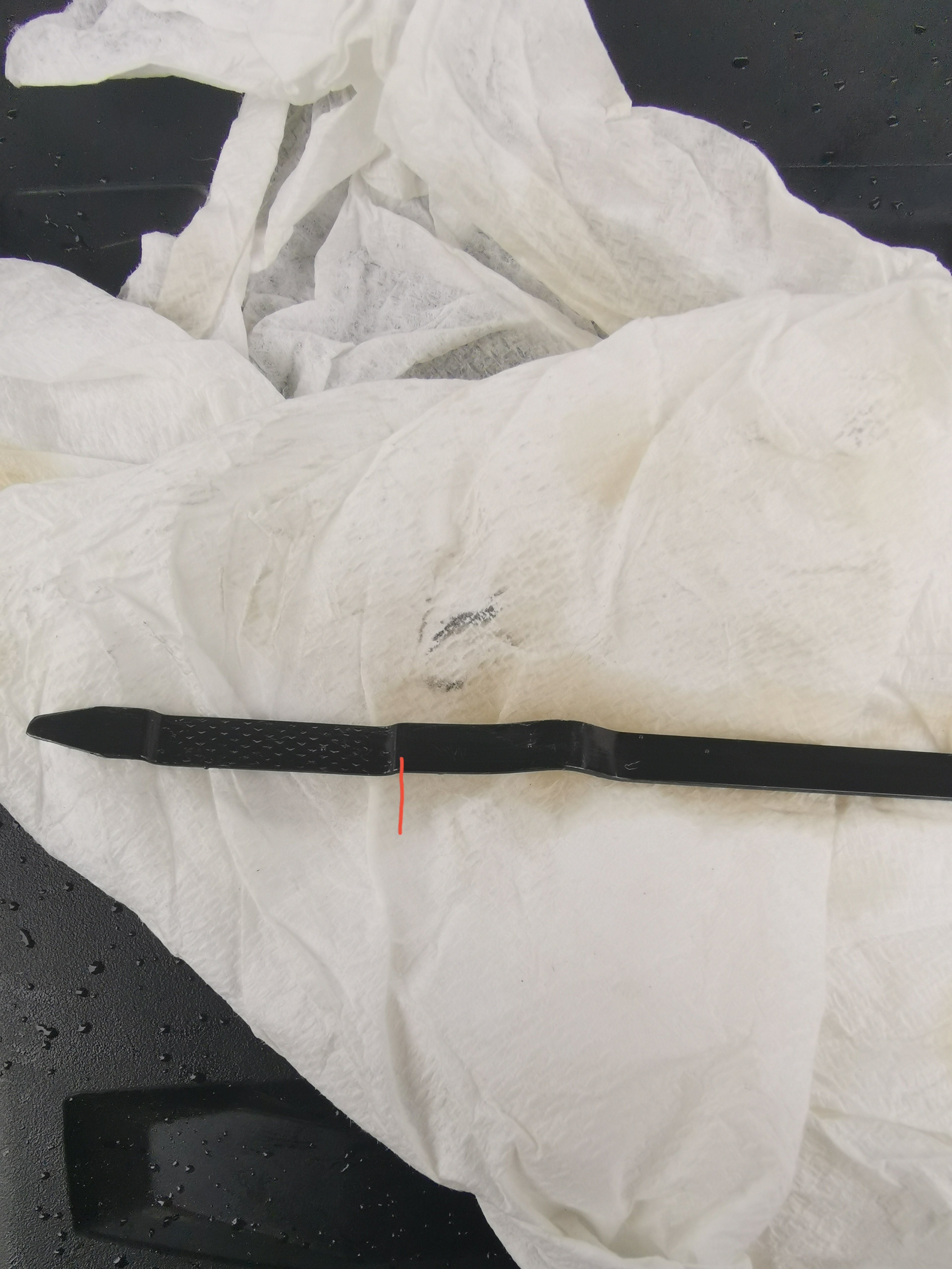

  14. Thank you to everyone who has replied and given me advice. I just went out there and changed the air filter. The only drama I had was I over tightened the screw in line with the air pipe and damaged the screw head, so the next time I go to undo this I will have to do some problem solving. After everything Was back in place, including those pesky clips, I then took the car for 5 minute drive. After I had parked back up on the flat, I waited five minutes before checking the oil. Once again I was baffled. When I inspected the dipstick, one side was just under maximum but the other side was a good couple of mm above my red line (on the photo above). The same happened the 2nd and 3rd time I checked. Surely if there was a pool of oil at the base of the dipstick, the oil would surround both sides of the dipstick when I push it down-seems not in my case. I think I will just order the syringe and take about 400ml when it comes tomorrow, just to be on the safe side.
