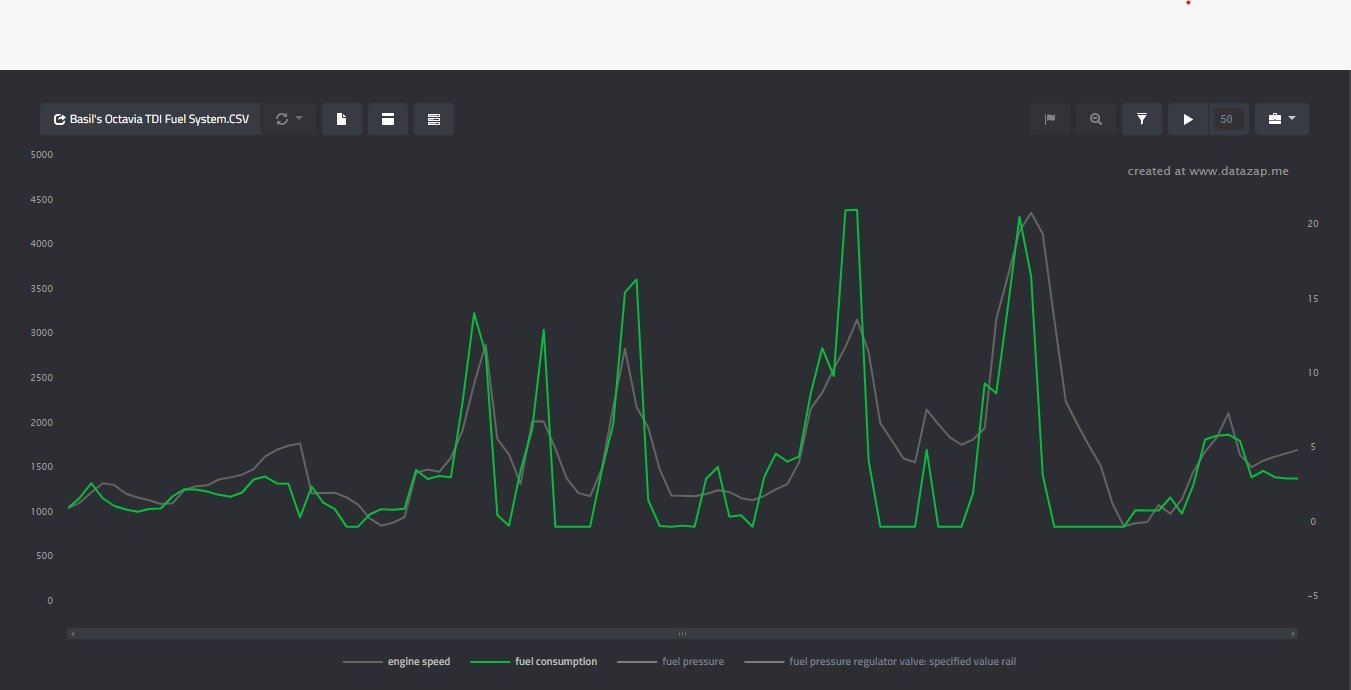

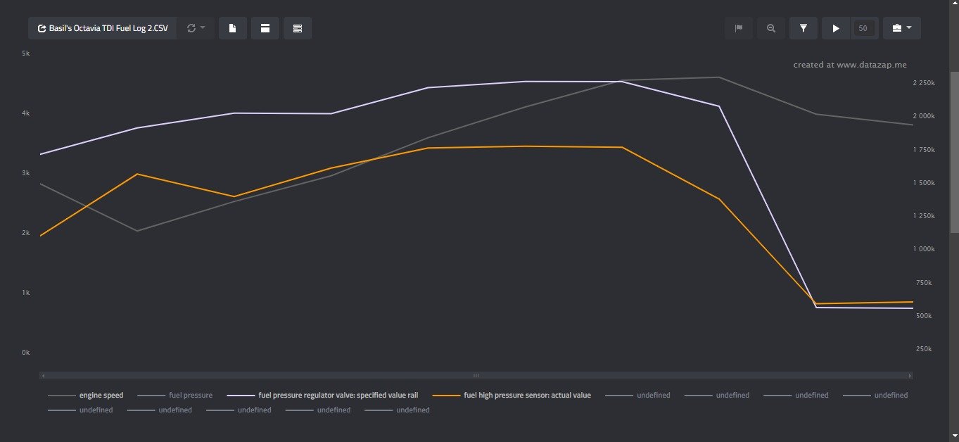

Hello, good folks of briskoda. I need some help figuring out why my mk3 2015 Octavia TDI is giving me low fuel efficiency. I'm getting anywhere between 5-9 kmpl (11-21 mpg) in city driving and around 17-19 kmpl (39-45) on highways. The latter seems decent but the city numbers seem way below what my friends with Octavias and Jettas are getting. In the city, I can almost feel a sluggish pull when I'm in lower gears. And when I've taken my foot off the accelerator, the engine braking seems too eager to slow the car down. For background, the car has run 160k km (100k miles). I bought it around 5 months back secondhand. Changed the flywheel, engine mounts, wheel dents were removed, aligned and balanced, full service was done with engine oil,fuel filter, oil filter and air filter changes, gear box oil was inspected and topped up. The previous owner mentioned that he had changed the timing belt and water pump roughly 70k km (50k mile) ago. I met up with a friend last weekend and he ran a bit of vcds diagnostics. Turbo performance seems to be good. One thing that stood out was that the fuel pressure was lagging behind the ECU specified value. PFA graph. When he cleared the short term fuel trims, on my drive back in the city, I was getting 12.5 Kmpl (29mpg). This was much higher than the usual and the car seemed eager to start moving in the lower gears as soon as my foot was off the brake. Not sure if this was just placebo. I didn't get a chance to check again since I was away for work for a week or so. Got back this week, driving around, back to square 1. 5-8 Kmpl in city (albeit start stop traffic) I got 17.5 on late night drive to airport, which compared to other people's cars on long drives, seems lower. Occasionally, while driving, I get the error "only leave vehicle in position P, please visit workshop" but it comes on for a second and goes away. Not sure if this is doing anything. Also, the timing belt stretch was measured at 3.98°. Any ideas on where I should start looking for solves? Considering doing a complete change of DSG oil, fuel pump change, timing belt and water pump but that's a big spend.
