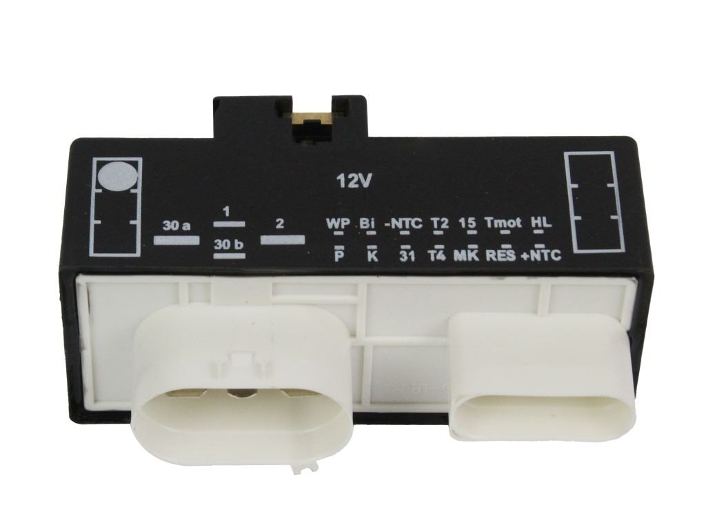

  1. Oh i see, thats not bad news, I was planning to replace the bigger fan anyways. As i mentioned before, i tried unplugging the bigger fan and connecting it to a 12v battery. I dont exactly know how it works, but it had 3 pins and i tried to connect it to the battery in various ways, and I could only make is spin on what seemed like the high speed, so I assumed that something is must be wrong with it if the low fan speed is not working. Okay, well i guess i will replace the fan and see what happens. If its still not going to work i will get a set of manifold gauges. Thanks a lot for the help!🙂
  2. Sorry for my ignorance, but would this resistor be located in this fan control unit?

  4. I did just notice i posted this in the wrong category, sorry about that.
