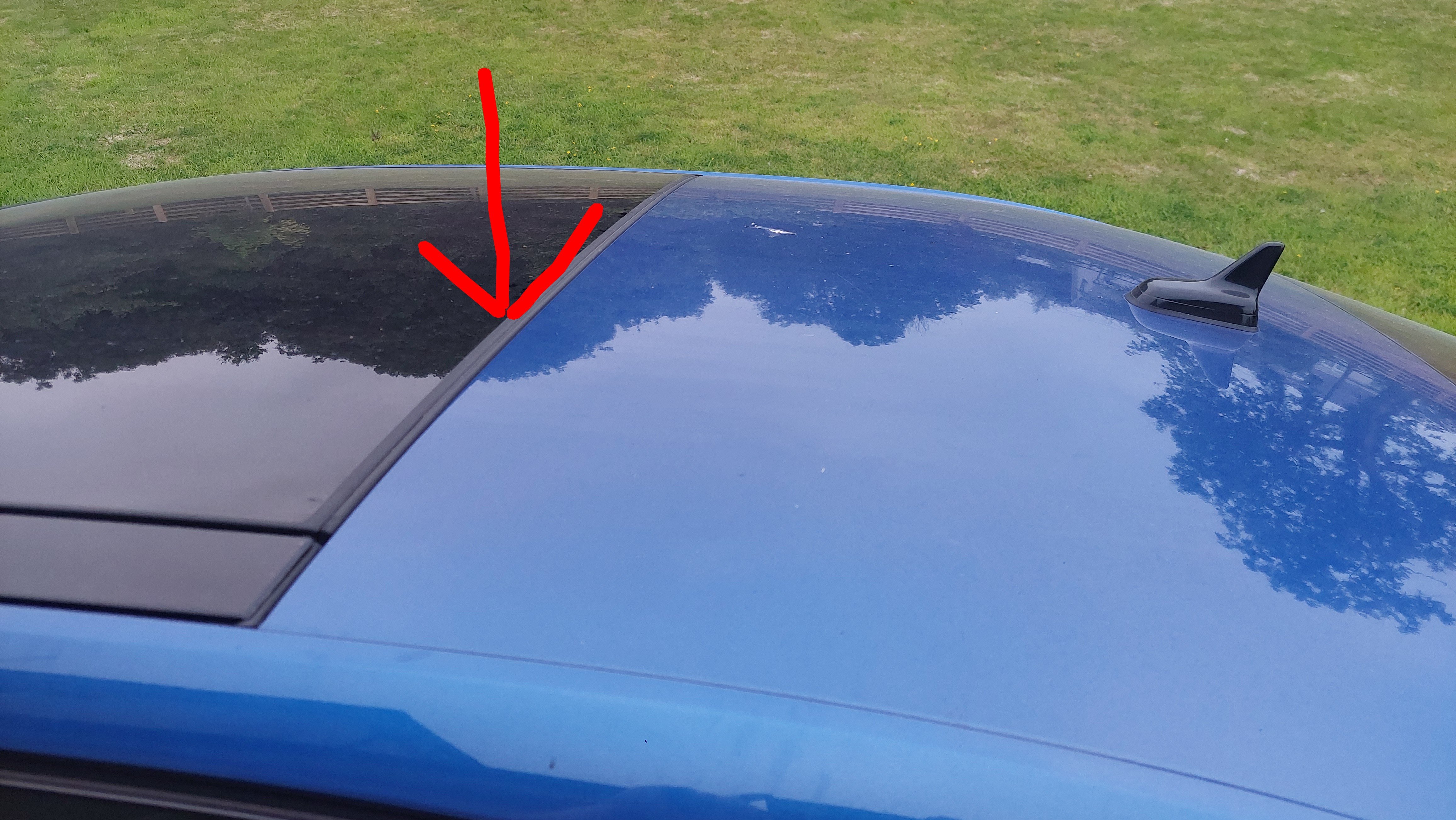

Sunroof creaks/rattles solved.
Hi all I drive a 2021 superb sportline, and just this evening found another source of noise from the sunroof. The rear edge of the glass has some flex in the centre, causing the rubber seal to rub where it meets the painted roof. The noise would come and go so it was hard to find, but this unusual spell of dry weather here in Ireland gave a good chance to find it properly. I cleaned all the rubber seals and gave everything a good coat of gummi pflege and the noise is gone. Hopefully it stays away but if not, the next step would be some sort of light grease. I do have some small noise from the headliner as mentioned here above; I'll get to them in time too. Video attached, and photo in case video doesn't work. 20260720_204836~2.mp4
