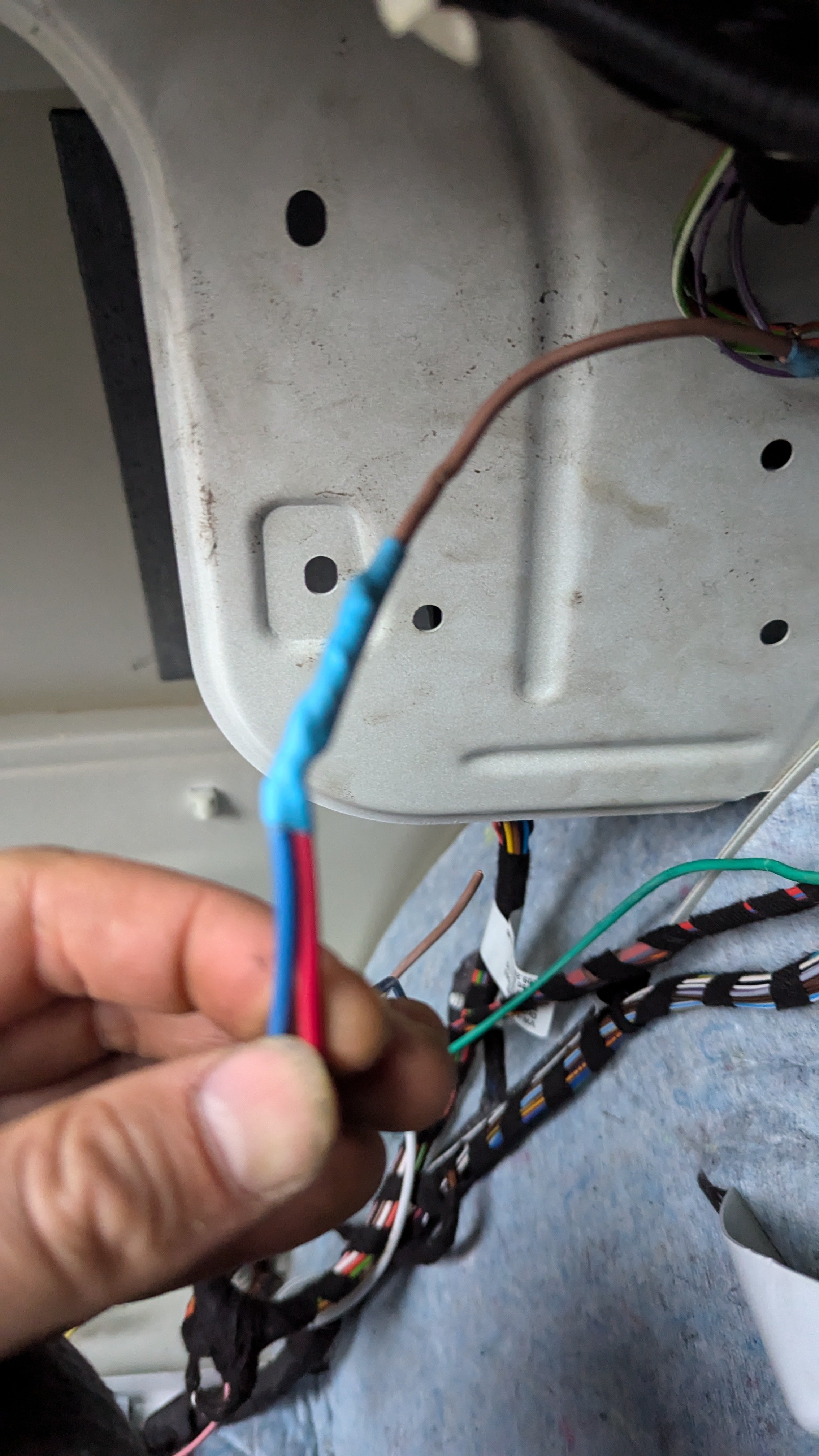

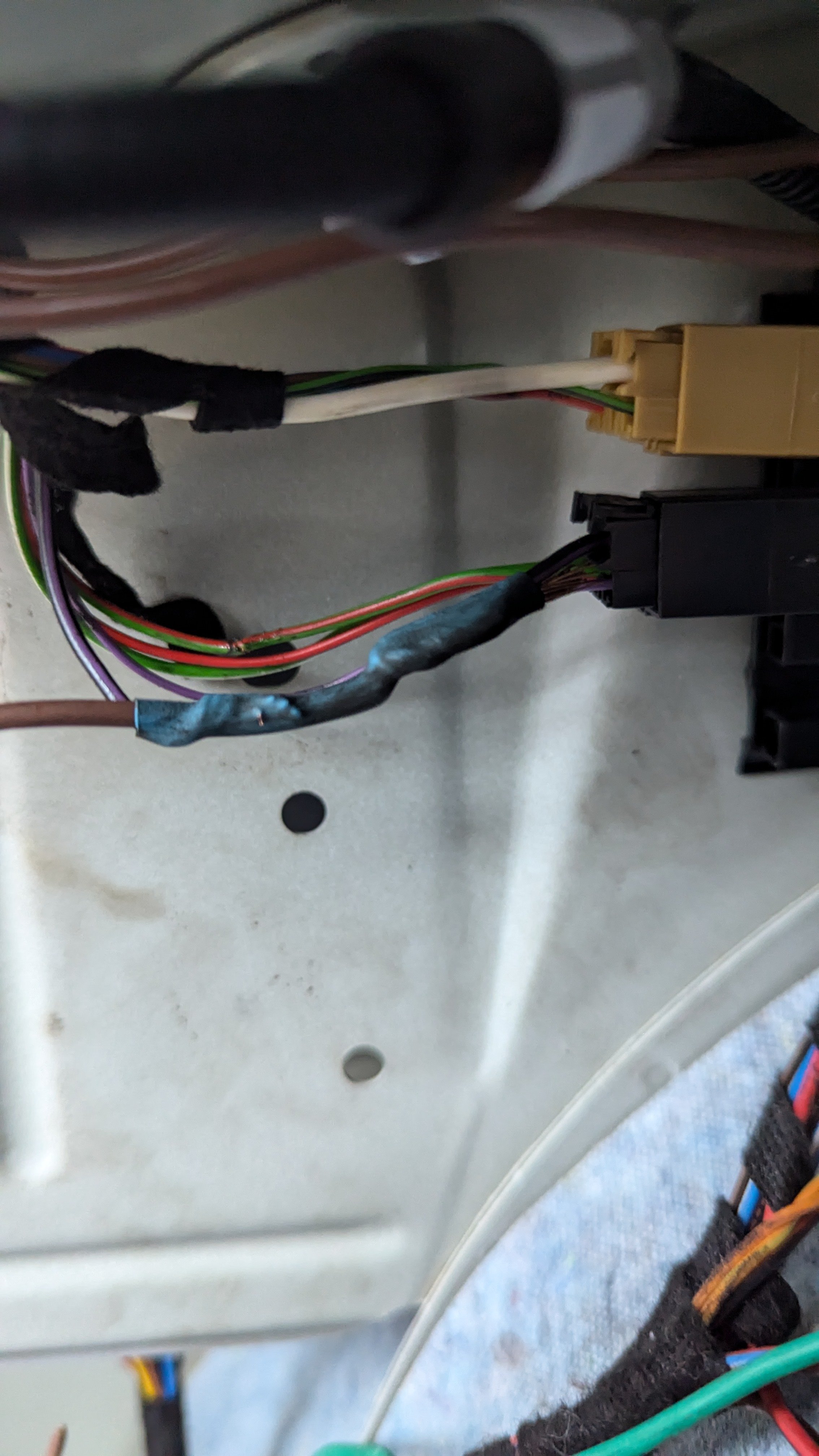

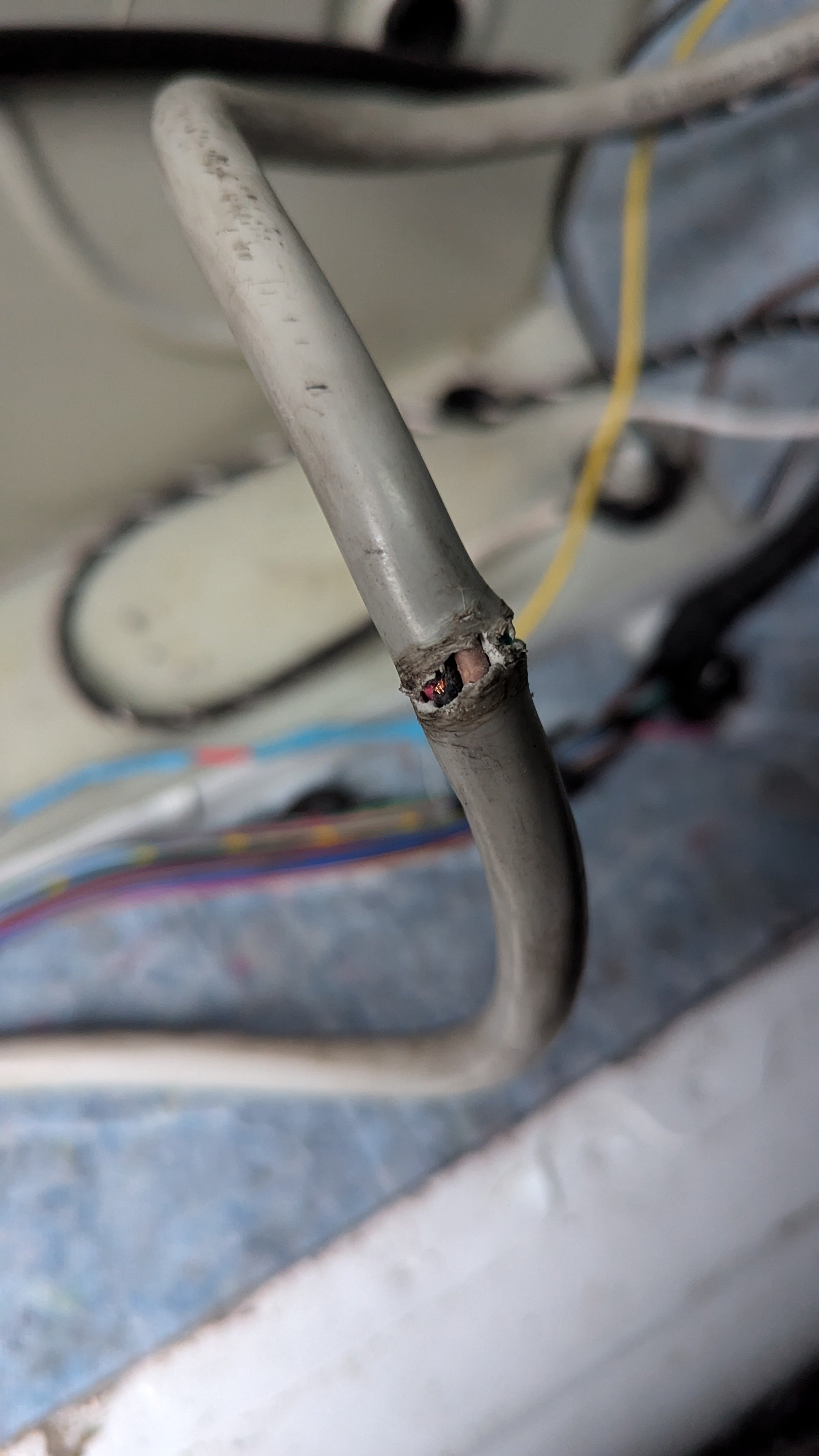

  3. More to report on this. I contacted a VAG group specialist today. He was totally booked up and suggested I contacted the original mechanic and gave him opportunity to put things right. I messaged him - he said that the timing was locked when he did the cam belt so it shouldn't be wrong, but that he'd strip it down and recheck and adjust the timing if necessary. He then said that the rear wiper issue will be a loose connection as he's tapped into it for the ignition feed. This rung alarm bells so I've removed the trim and found where he's connected the 12S wiring. He's connected both the red and blue cables from the 12S socket together (fridge and battery charge) and then connected these both into ignition feed he's found. The ignition feed cable he's connected to certainly isn't rated to carry the load that a caravan could pull from it. I'm going to go to a tow bar specialist tomorrow to get their opinion on it and get them to correct the work. I cannot believe what I've found. He's also mangled the 12S cable elsewhere - there are exposed wires showing.
