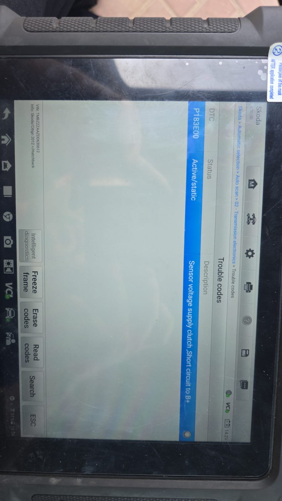

    Oh ok tnx, do u know maybe wehere the transsmiom computer location?
  2. Zel replied to Zel's topic in Škoda Citigo
    108,000 km i dont understand the second question, what is asg Its not the same cuz i didnt get this dtc code before In the start that was problam in the gearbox now its elctric problam I just dont understand what is this sensor
  3. Hello guys i got skoda citigo 2013 Before I begin to explain the problem that exists today, it is important to say: a used gear was replaced with the actuator and with the clutch The reason for that is: three months ago, my vehicle not drive and the mechanic said it would be better to bring a used gearbox with the actuator and its will solve the problam. And he was until this day :( today i turn on my car, try to drive and nothing! i see the D in my dashboard but its dosnt go... i connect to dtc and look what its told me : and the mechanic dont know which sensor its talking about, someone can help me with that?
