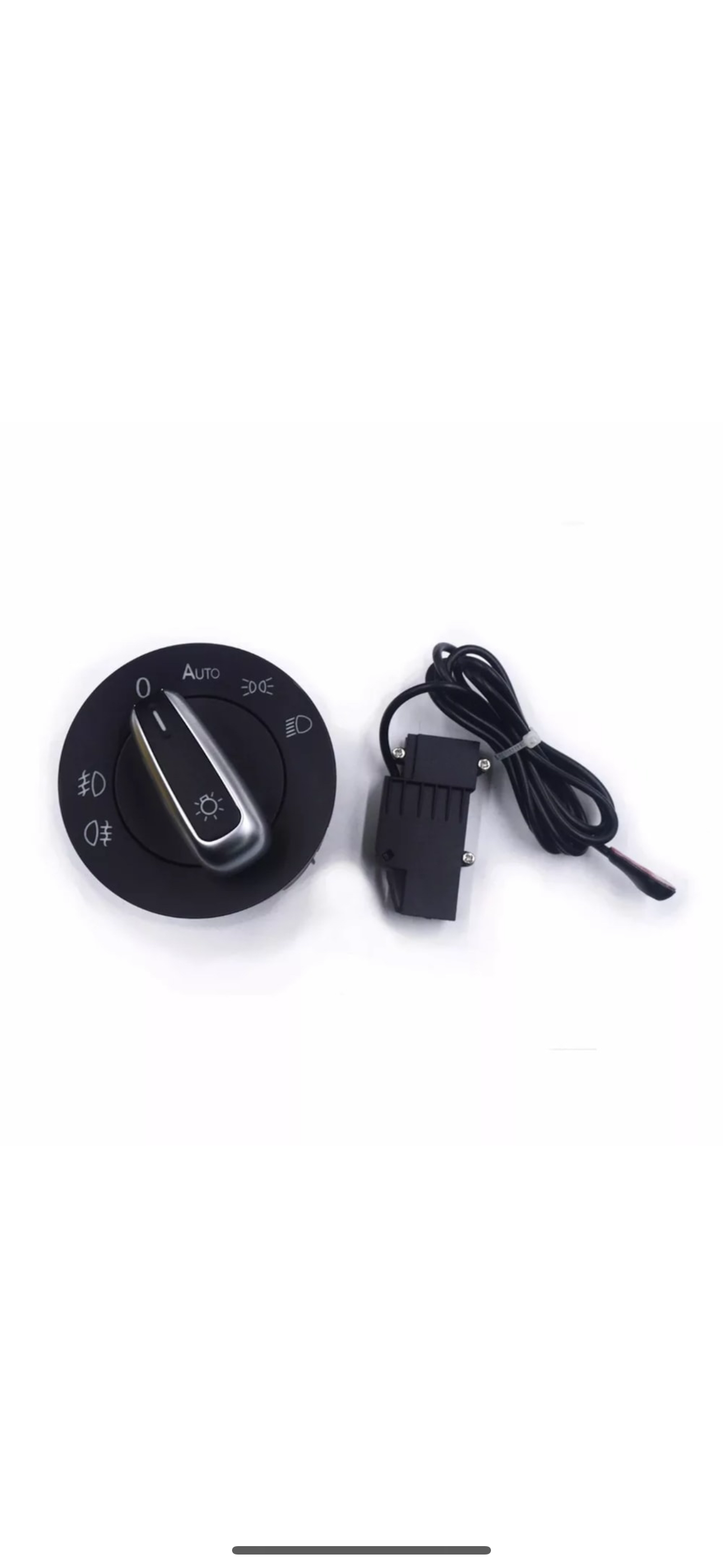

  8. i don t have maxidot on mine, so, what i learned during this process and going through multiple scenarios, auto/regular headlight switch, with/without aftermarket sensor is: with the switch on auto, when the sensor is covered or is dark outside, coming home and leaving home (needs to be activated in long coding) will turn on just the sidelights/turn signals 1. ch when you turn off the engine 2. lh when you press the unlock button twice on the remote now, without auto switch you need to leave the switch ON and lh and ch activated in vcds as well and that way: 1. ch when you turn off the engine will turn on the low beam and sidelights 2. lh does not work at all without auto, at least on my end. now i m having a problem with the way it works, i got them both to work but on sidelights and i want them on low beam, i m still trying to change that you can give it a try on yours, it should work even without the auto switch, just turn on the ch in vcds and leave the switch on, make sure the coming home mode option in long coding is OFF
  9. UPDATE: I got the Leaving Home to work by pressing the unlock button on the key twice, but coming home is on low beam and leaving home is on drl, any way i can change lh to low beam as well?
  10. I thought about that too, it actually works, it is a bit delayed to be honest, although i have no idea how an oem sensor works, but with this one, if i cover it with my hand and i keep the light switch on auto, after a few seconds the lights are turning on and when i take the hand off of it, the lights are going off. also, no idea if it means something, right after i installed it and turned on the lights i heard a few beeps somewhere close to the light switch
  11. Hello! I own a Skoda Octavia mk2 pre-facelift which does not have a light/rain sensor. I have been trying to activate Leaving Home/Coming Home for some time. I bought a sensor (I attach the picture) + 2 different headlight switches, both with the AUTO function. I already had all 10 wires going to BCM. I cannot activate Leaving Home no matter what i try, Coming Home works although the adaptations do not seem to work, no matter the time i set in VCDS, the headlights turn off after approx. 1 minute. I tried with the headlights on AUTO, low beam, off, nothing. I want to mention that other functions such as the second fog lamp, us style and other codings worked without any problem. Any ideas/advices are welcome! Thanks
