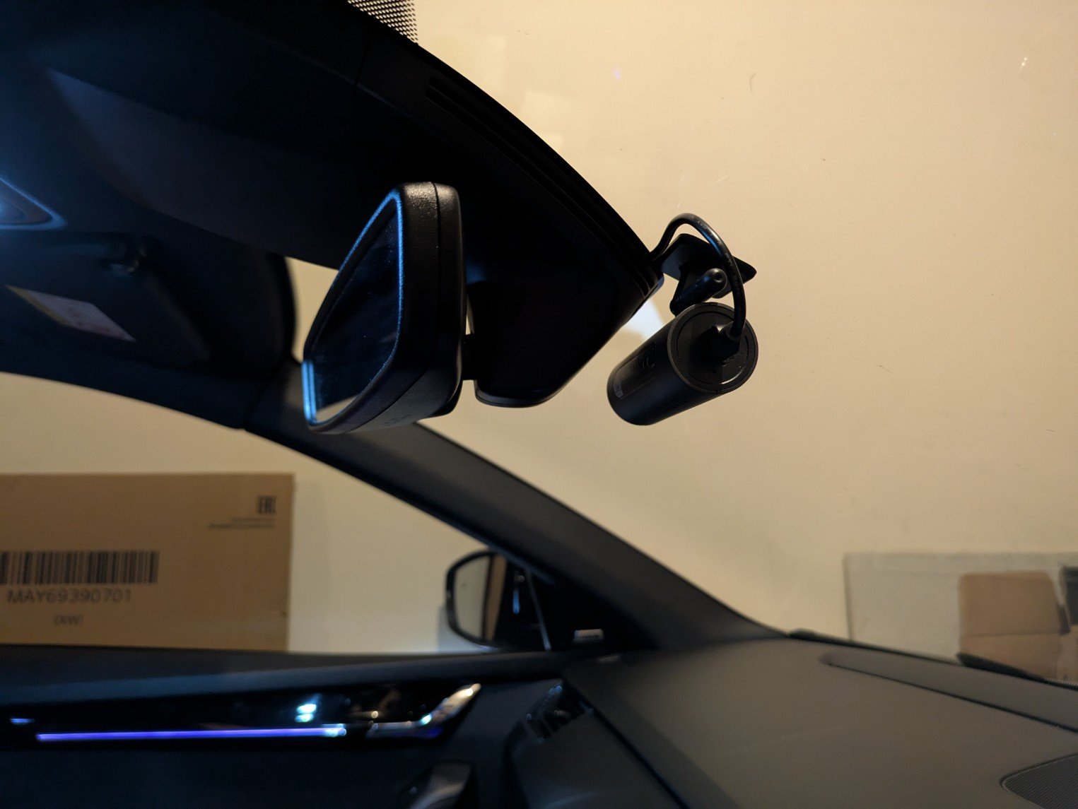

  1. I haven't been on this site for a while but thought I'd give an update. I managed to pry the two pieces directly behind the mirror apart. The trick was to pry the left hand side first. I used a Dremel to make a groove for the cable to sit. A pillar trim came off easy so was able to neatly pin it away from the airbag. Overall I'm happy with the way it sits and barely notice it behind the mirror.
