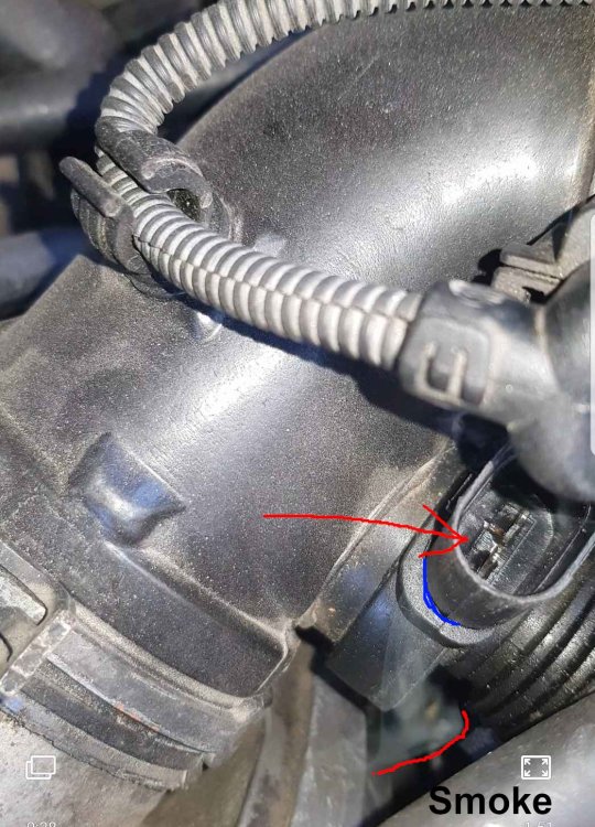

  1. Thanks. Alright, that's one confounding issue down. Now just to find a new one. Which seems near impossible as basically nobody sells it and VAG did not bother giving a proper OE number to it, so all of them just lead to ones without a connector.
